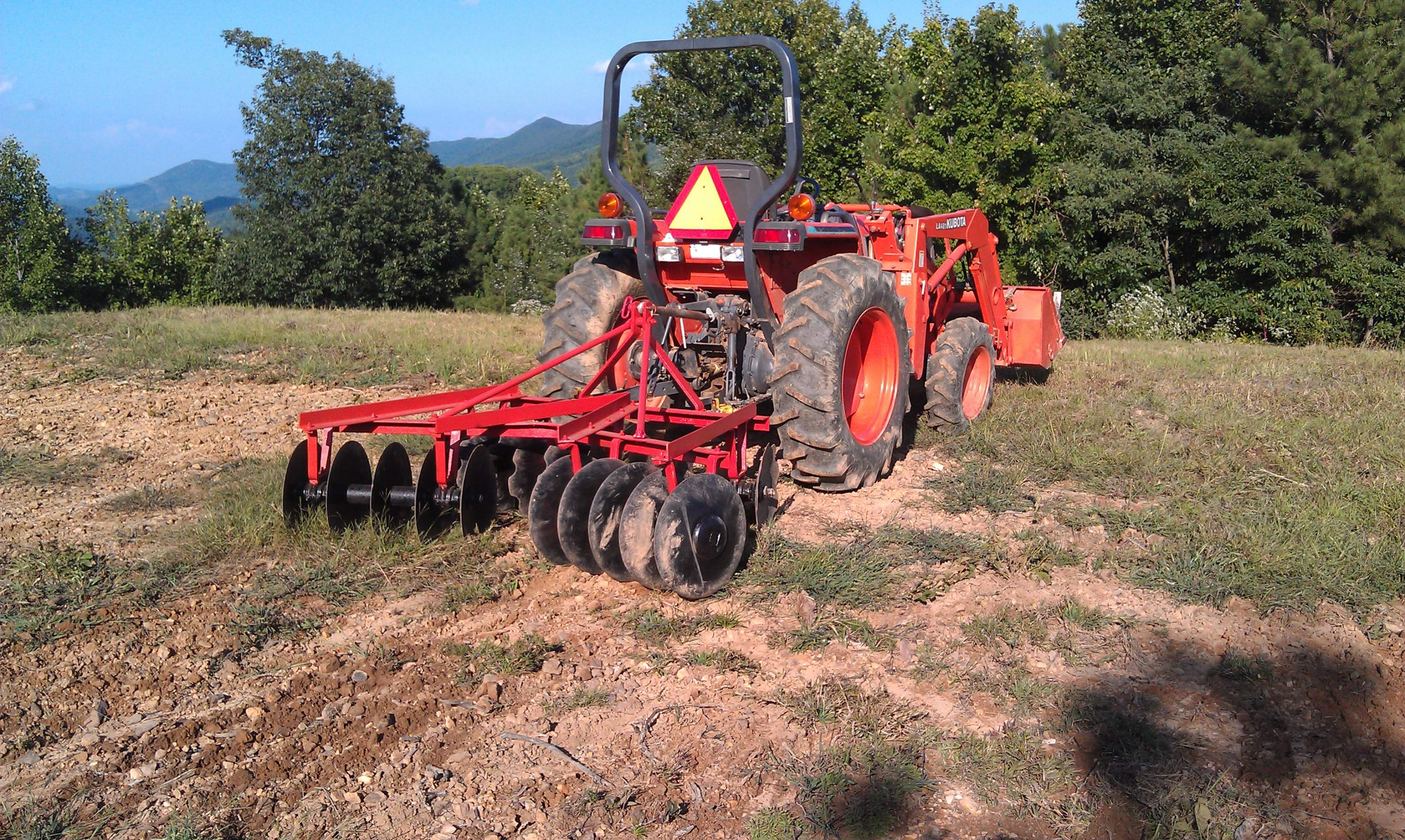

Talkin' about disks....
I just bought this USED set and tugged it around the top field to break up my clay, gravel soil.... It did pretty good but I noticed that the RIGHT REAR set of disks don't turn. I greased all 4 sets of axles. The other 3 spin, somewhat tightly but the RR will only turn with vicegrips (so it is not totally frozen) I tried to loosen the big nut on the end but it just turned the disks. Is this nut the key to loosening up the shaft? Maybe if I wedged the disks with about 3 vicegrips I could loosen the nut a QUARTER turn?????
IDEAS? :confused:

You should lower it and maybe lift up the front to sink the rear discs as deep as possible in the soil. Then use a big wrench and if necessary a longer breaker bar The gang of discs should not spin. That nut needs to come off to service the bearings. It's strange a new disc won't spin.

Thanks for the suggestions. Maybe after a rain it would sin in the dirt. The ground is normally so hard it won't go into it.
I bought this unit USED, I have no idea how old it is.
