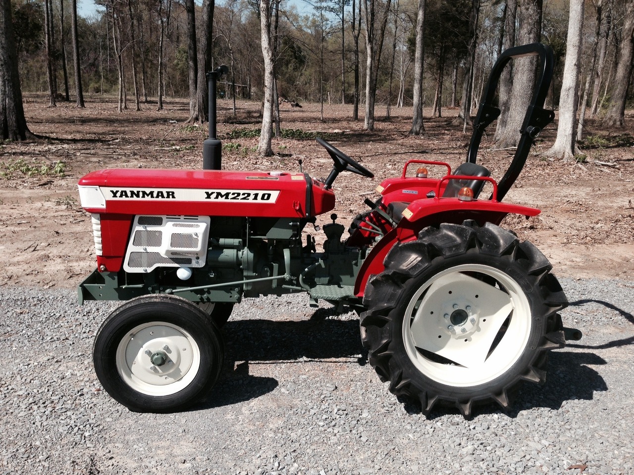

Very nice primer work.
Molto bello il lavoro di primer.
Massey-Ferguson red and white colors for the body panels.
Massey-Ferguson colori rosso e bianco per i pannelli di corpo.
The chassis color is light green or teal.
Il colore del telaio è verde chiaro o verde acqua.
YM2210 Restaurato. Clicca sull'immagine

Thanks, about the red i have found two massey ferguson red, super red for vintage tractor (mf 35) and red for actual tractor, which is the correct color? thanks :thumbsup:
   / Restore ym 2210 problem #55
might call hoye and see? or try and wait Aaron out here, or send him a pm on the site here?

Neither is correct, both are close. Hoye color-matched their own mix, I think from the lower dash panel.
   / Restore ym 2210 problem #59
Seeing that he is doing a restore in Italy, it would be cost effect with the M-F colors being a very close match. He can buy what is local than to order, pay the shipping and export/export taxes before it arrives to his door.
Obtaining the colors locally keeps costs down and he has availability for years to come. His Yanmar would look new vs. most looking shabby over there. Thus, the comparison would be minimal to the faded paint and rusty gray market Yanmars already out there in Italy.
   / Restore ym 2210 problem #60
i am with you. Yes it may not be right but no one but a purist would know and most could never tell unless it was side by side with the correct color. I would find what i can get local that is close and use it and not loose sleep over it before i shipped it international. The shipping on a flat rate Internation 12x12x6" box is like $60 if i remember right.
