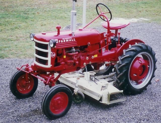

Several years ago I restored a Farmall Cub and it also have a coulpe layers of paint. I stripped it down and had all of the pieces sand blasted. Then a buddy sprayed them with an epoxy primer for me.
Here is a picture of the finished Cub.
