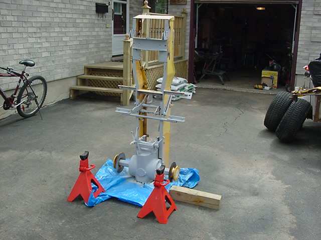

It was warm enough yesterday to degrease the frame.And prime the under side of the cub(Too cold to finish the priming today, Just above freezing. /w3tcompact/icons/frown.gif so it will have to stay there for a day or two./w3tcompact/icons/smile.gif

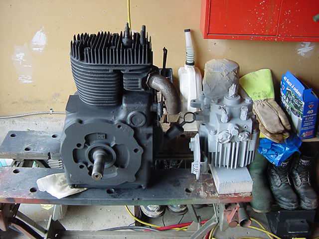

Here's a pic of the 12 hp engine i got for $100.Took off all the covers to be blasted and painted.To the right is the hydrostatic drive ready for the yellow paint .Had to add ports to it for the hydro lift for the deck and blower.
Well thats as far as I got,I'll be taking more pics as I go along and I'll post them here.(She is going to be for blowing snow,So I have all summer to get her done)/w3tcompact/icons/smile.gif

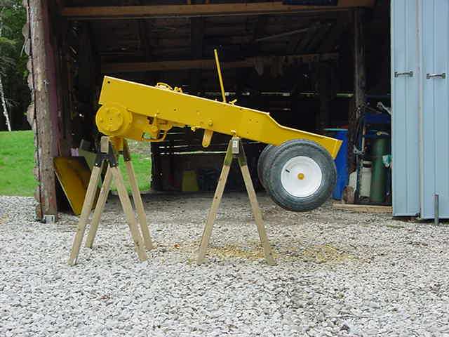

Had a chance to spray the frame this weekend.(Darn blackfiles like to stick to the paint)/w3tcompact/icons/smile.gif

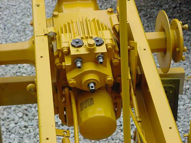

With some spare parts off of a 149 (basket case) the 129 is now ported for hydro lift.Makes lifting the blower and deck alot easier/w3tcompact/icons/smile.gif
