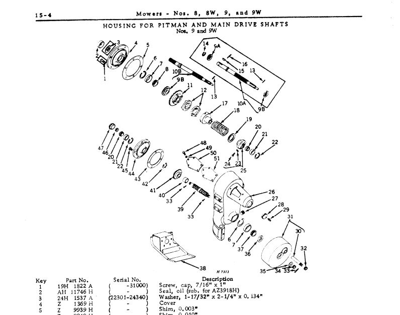

Hello, I have purchased a Model 9 mower that needs some parts. Specifically I need to find the seal for the pitman shaft that holds the 80-90 in. I would appreciate any help. Thank you puzlrock

Have you asked at your JD Dealer?
Dimensions taken with a set of Vernier Calipers will enable your local bearing/seal factor to supply a substitute.
Item #36 ?
I have the same mower and I got that seal at John Deere about a year ago. They just have to go get the old parts book and it is in there.

Bottom shaft seal on #9 mower is AH15738 $24.40. Have you considered utilizing Corn head lube? That's is the lubricant I have in my JD 709 rotary mower gearbox that has a faulty lower seal
