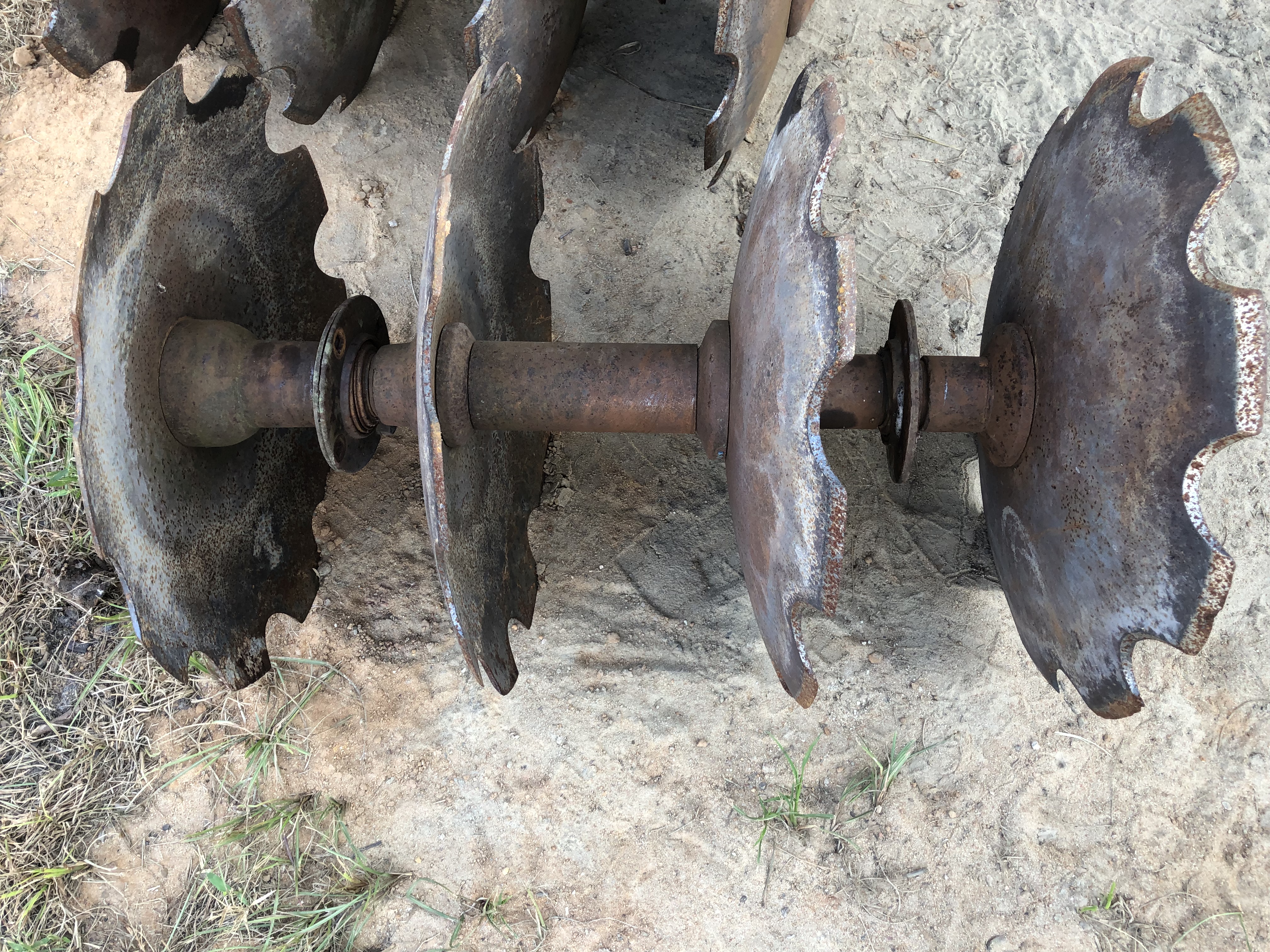

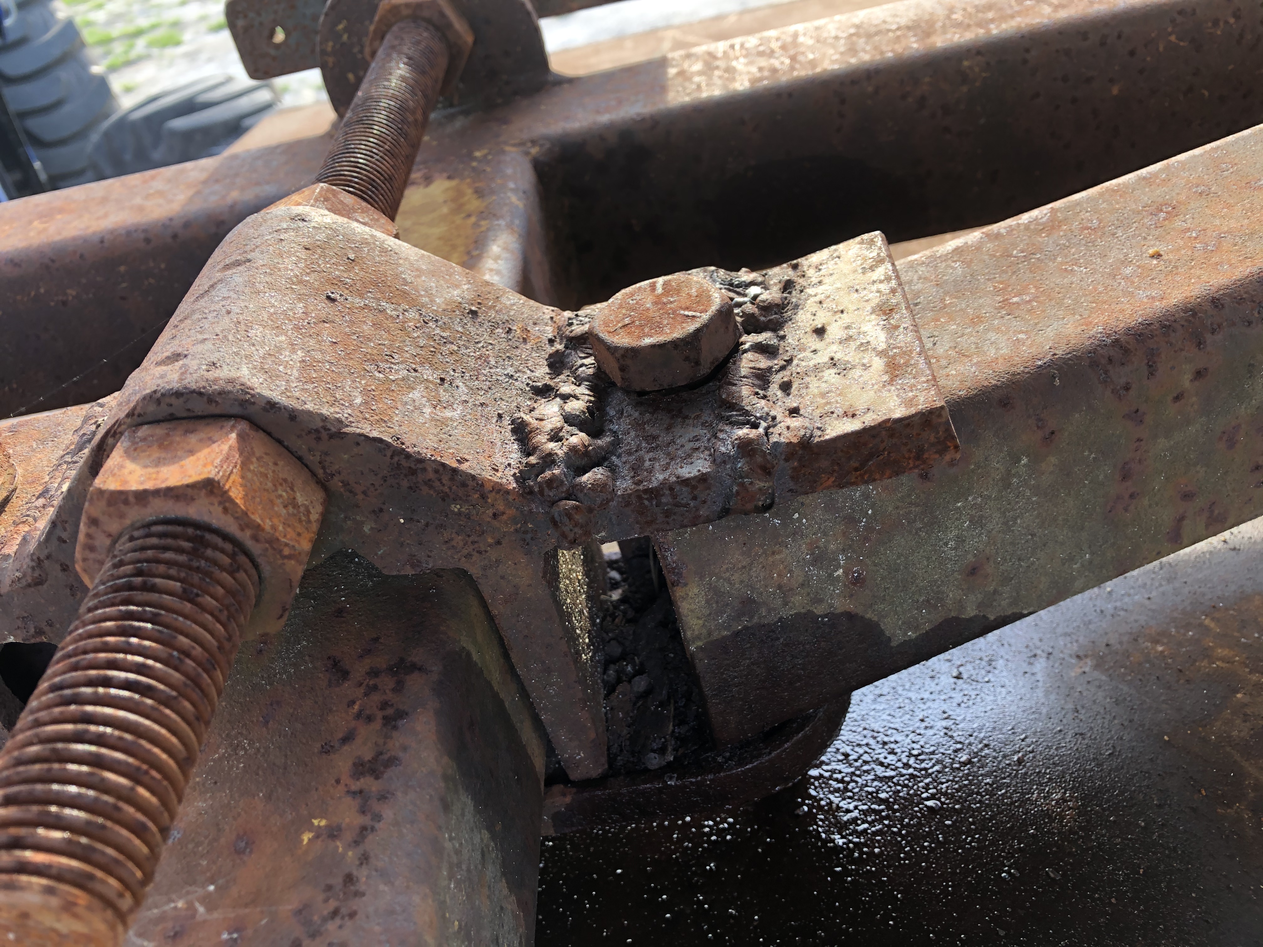

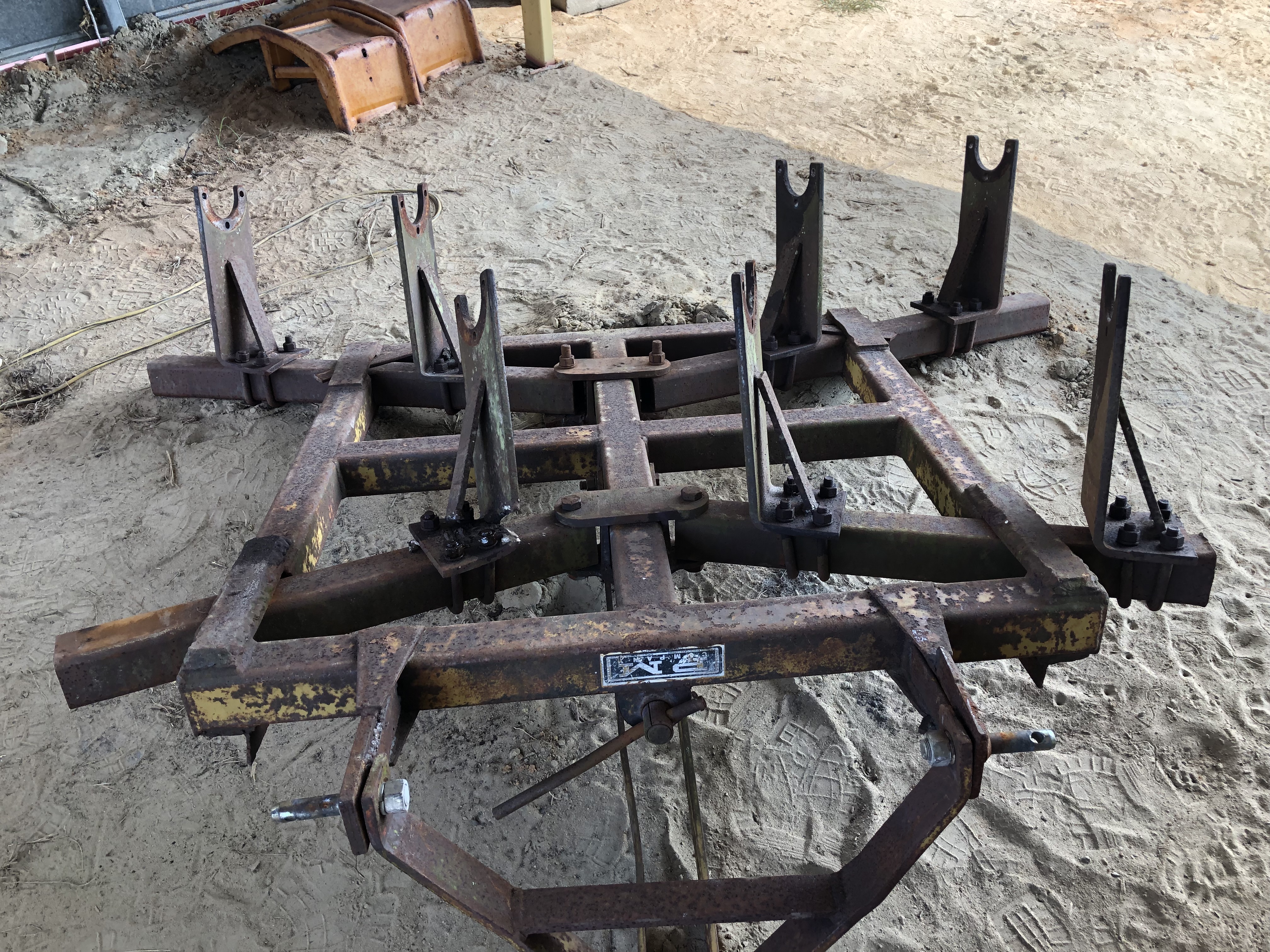

I got these last year on a trade, a friend wanted my lighter set. Unfortunately I caught a stump with them behind my tractor doing fire breaks and ripped a gang hanger, not cool. Since they were down for repair I致e decided to completely over haul them and make some upgrades to some areas I want to beef up. I will add pictures along the way but so far here is what I致e got, and this is my first time tearing down a set of disk harrows.
Took the gangs off and flipped the disk frame for easier work. You can see the front gang hanger torn here

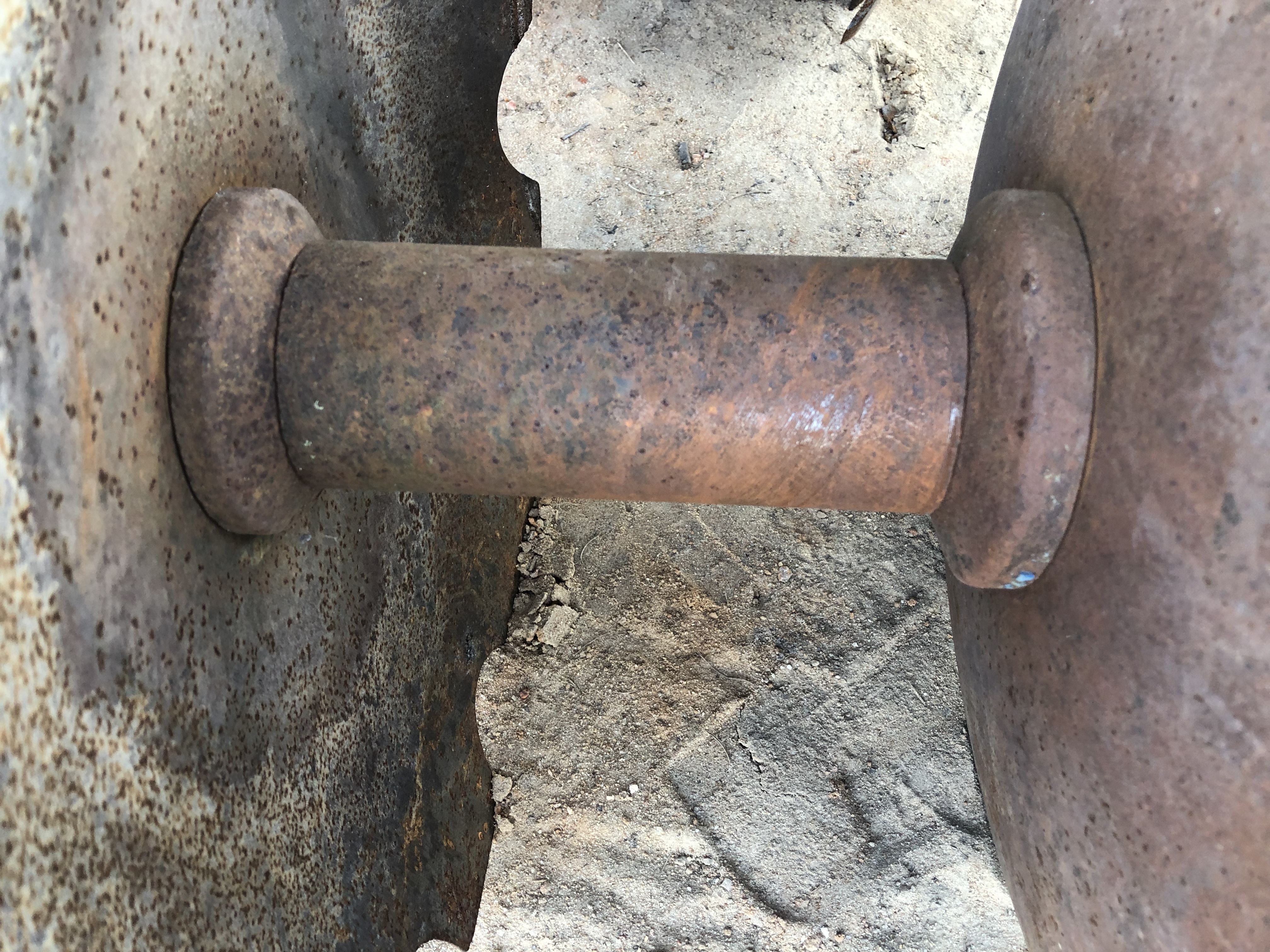

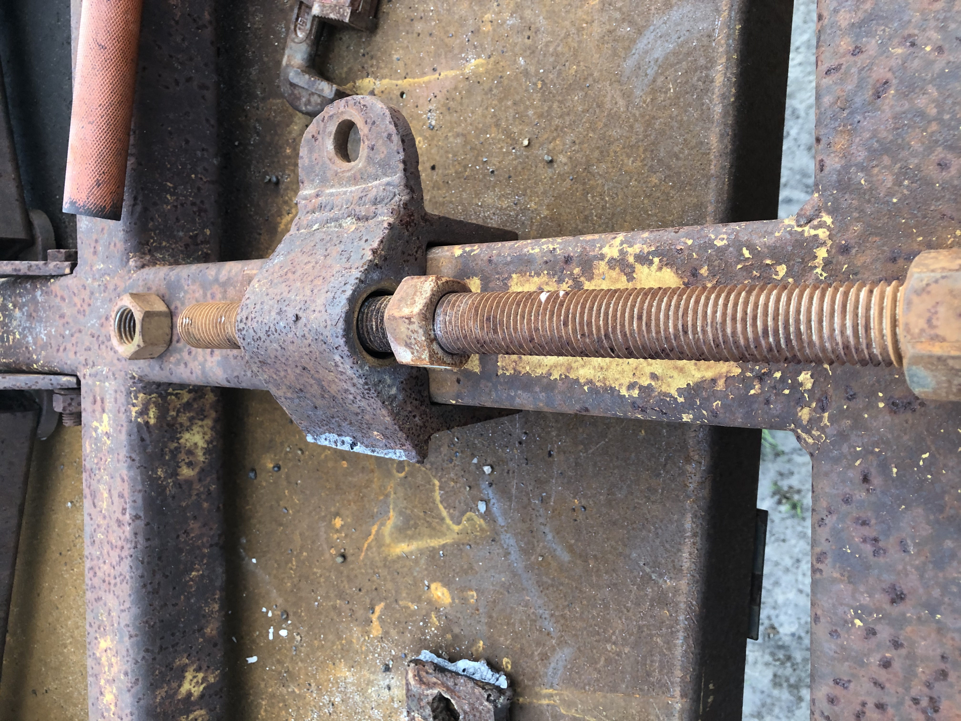

This axles was worked on before by the previous owner and had some clever but not correct engineering done I wanted to fix while torn down. Middle spacer is a pipe cut to length and slip between the spool spacers, and the outside spool spacer was shorter and had the blade spaced 7.5” instead of 9”. You can see the small galvanized pipe cut and used on the end to space the nut on the axle. Bought new correct spools for this axle.
/ Restoring PM disk harrows

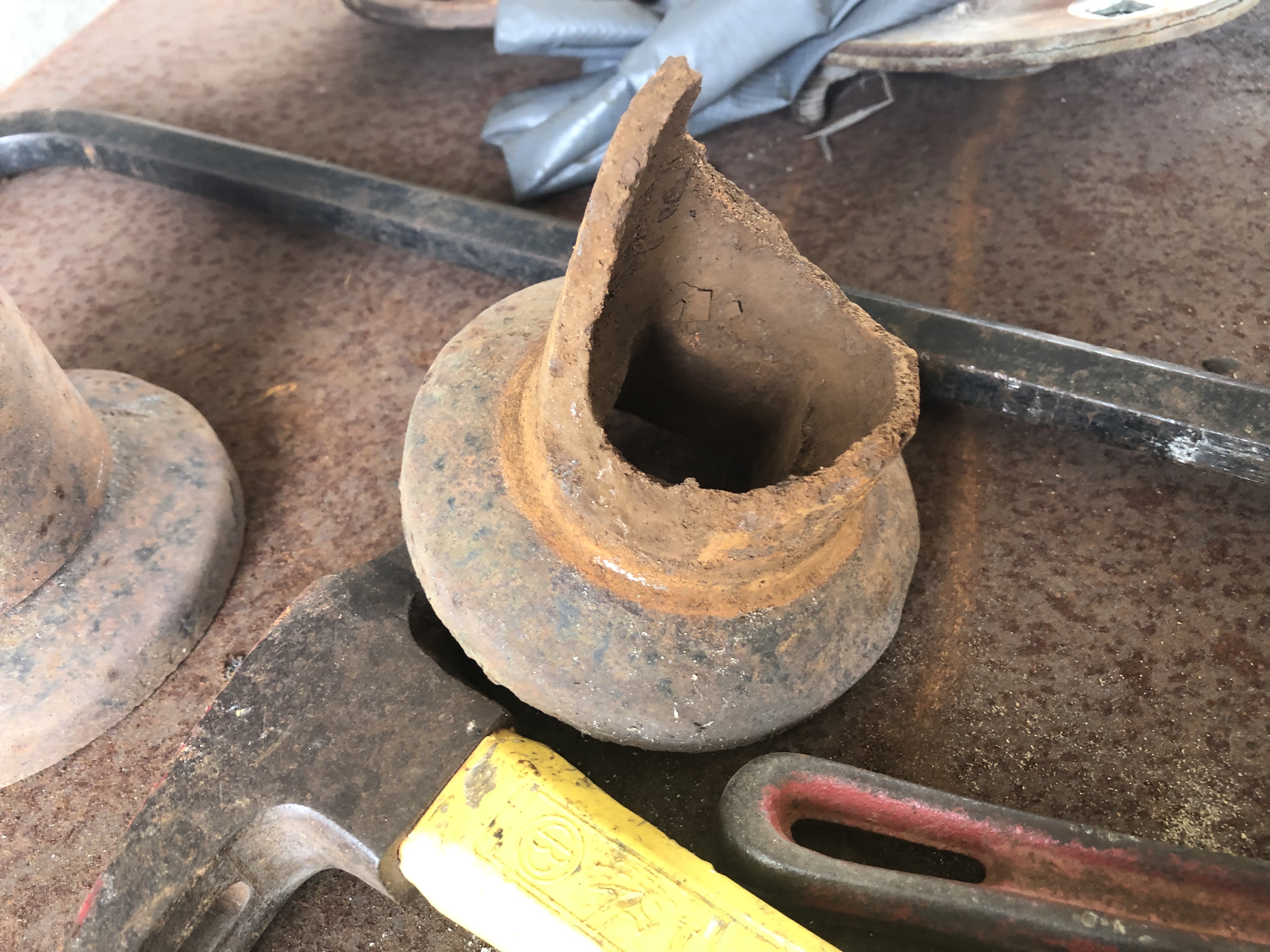

Tip, I sprayed all the axle nuts yesterday with PB blaster and again first thing this morning before jumping on removing the nuts after the tip from a friend. Much easier than the first! After disassembling this axle I found out two spools were busted that you couldn’t tell before. Luckily I had the new parts for this one, unfortunately not a new axle. I noticed it had a grove cut so I’ll go pick up an axle tomorrow.

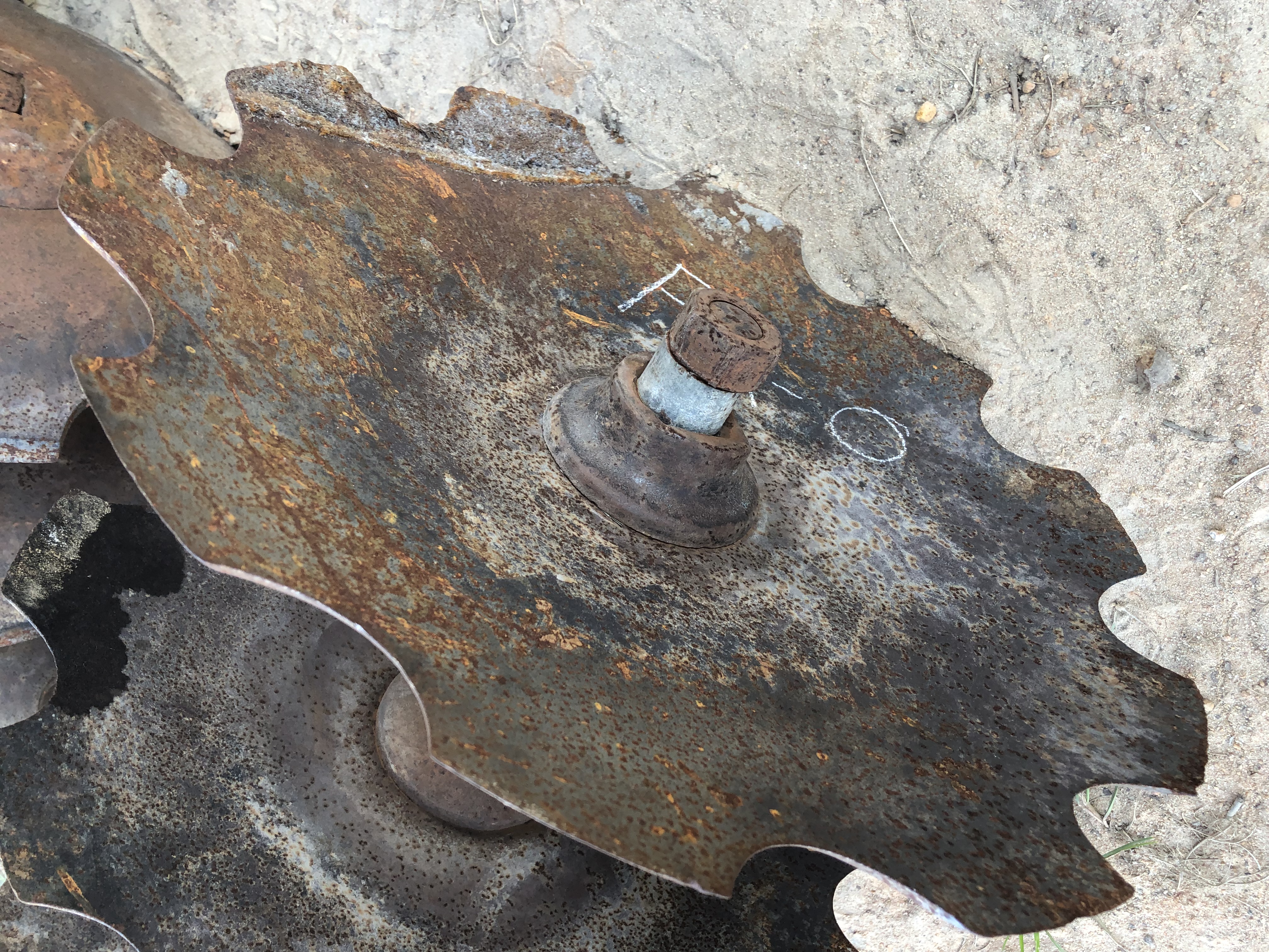

2-3 bearings were rough so decided to replace all of them since I’m this far into it. I know I would hate myself to have one go out after putting everything back together. Bought all new bolts and trying to find new u bolts now. Mine are 5/8” I could only find 1/2” in the size I needed. Any suggestions on where to look online?

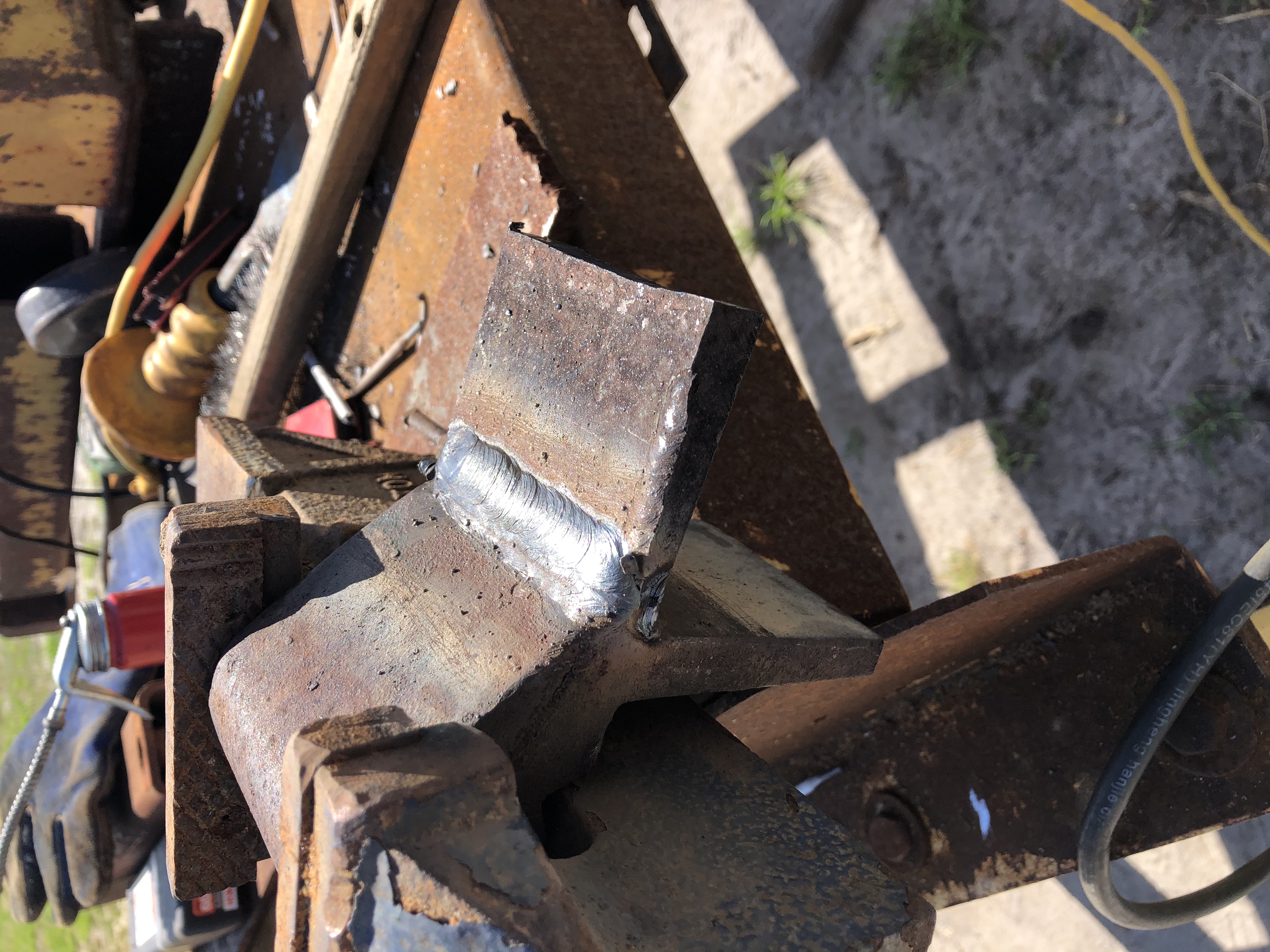

Cut out, added new plate, beveled both sides and welded back out.

That is about the worst welding job (middle photo ) I have ever seen. Lucky I didn't just fall off after the original repair. Heck a blind beaver could have done better.
Your welding looks great!!
HAHA!! And I appreciate that man, I was a little rusty not touching my welder in over a year.
Here is another hack job on it, I completely cut these off and making new brackets.

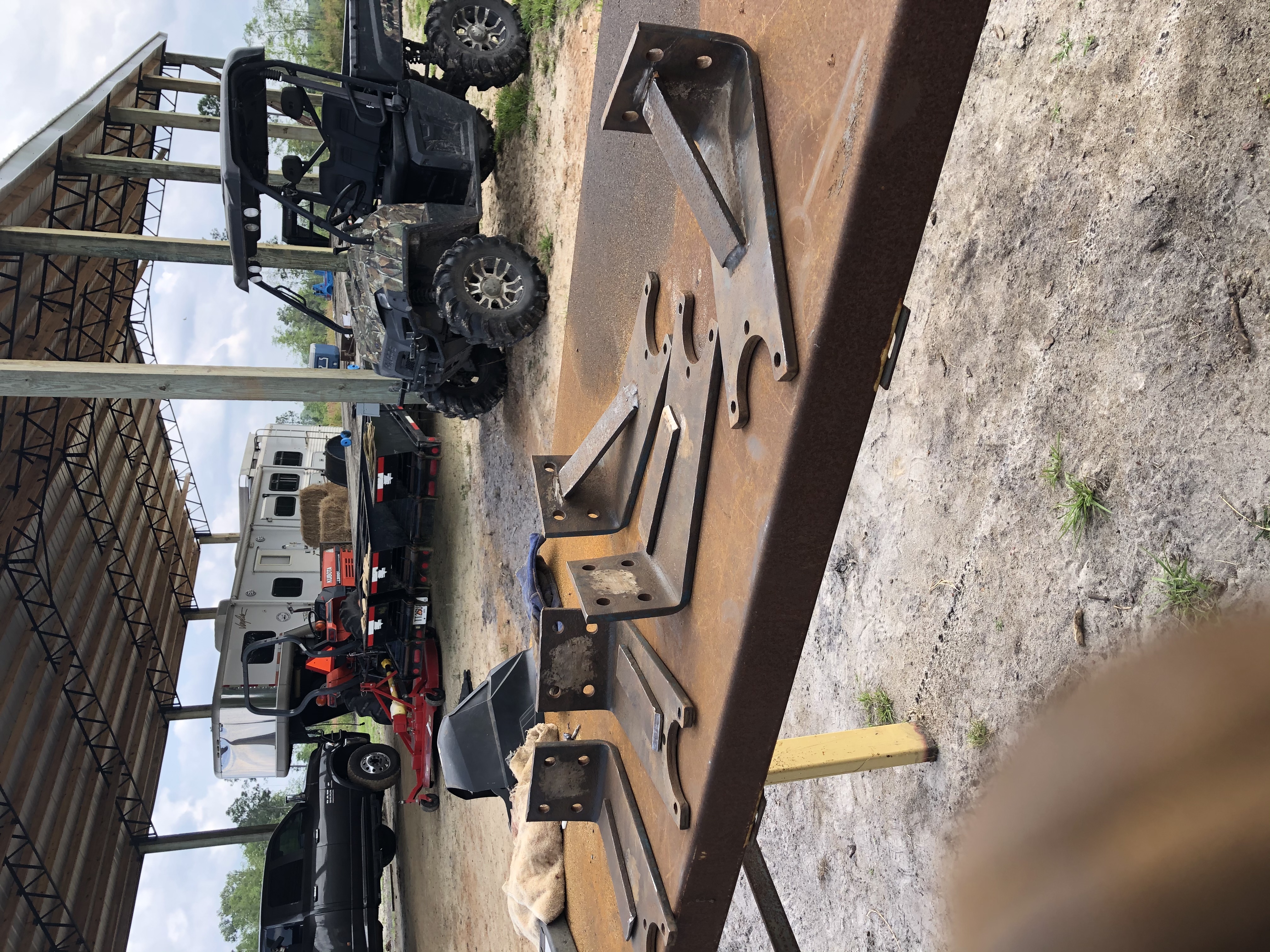

Cut, squared, and about to tack and weld the new 3pt hook up bracket

Need to drill holes for hitch pins and bolt in Top link frame hook up. I used 1/2” angle iron for the main hook up bracket notched for the top link frame, and 3/8” flat bar for added support to spread the load from the pins. Should be good to go I hope.
Now to sand, prime, paint, and put it all back together.
