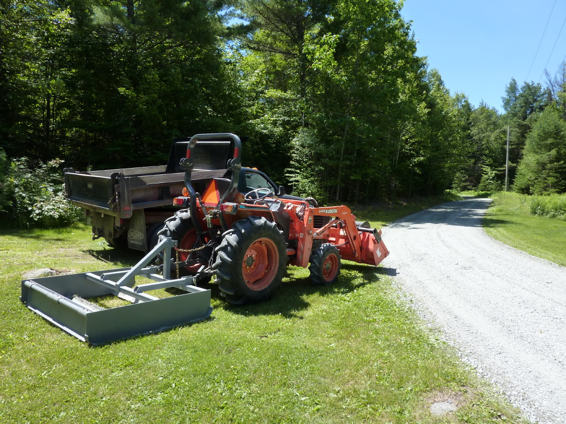

Resurfaced a 500' stretch of my mile long road today. Took 10 trips to the
Pike crusher plant, which luckily is only 4 miles away, with my Dodge
Ram 3500 dump to get 36.5 ton of 3/4" "Sta-mat". I tailgate spread each
load then rough graded the whole thing with my Planer/Box-Drag. Next I
did a wheel pack job with the 3500. After that I put the Land Pride rear blade
on and built the crown then repacked with the truck again. And last I put the
Planer back on and did a finish grading job and repacked.
A good days work ( for me anyway ) on a beautiful summer day.

Whooah.!! That's a good days work right there.
Nice picture too.
Take a break and enjoy the fruits of the labor.

Gordon, I wonder if you could provide a little information about your box drag/planer. I'm in the market for one. How do you like the back hinge function? Thanks, Jim
   / Resurfaced 500' of Road Today #9
Hi Gordon, looks like you had a great day. I was wondering about "Sta-mat"? That is a new term for me. Would it be what we call "crusher run" here, 3/4" stone or finer mixed with stone dust?

I like the hindged tailgate alot. I have two stop pins on the side panels. If I
swing the tailgate up and over to the rear it hangs behind the pins and does
not capture material running forward, but acts as an additional leveler. In reverse it hits the pins and acts as a plow face so I can back up and push
stuff. If I swing the tailgate up and over forward so it hangs in front of the
pins the box captures material and I can pull it similar to a box blade.
Here is a link to my first experience using it. Each time I use it I like it better.
http://www.tractorbynet.com/forums/attachments/170529-new-road-grader-trail-run.html
Sta-mat or Stay-Mat may be a local term. Every pit has there own version
around here. But it is basicly like crusher run with stone and fines and maybe some clay for a binder. Packs hard and smooth.
At my local pit crusher run is 2" and smaller crushed ledge as it come out of
the crusher without any additional material added.

Gordon, did you make it or buy it, if so what brand? I can't tell from the other thread. I have considered making one but I can't get the raw materials cheap enough to justify it. By the way, Vermont sure is a pretty place to be this time of year! I spent a few summers up there way back when.

I made it Jim. Probably the same deal as haulling my own gravel a little at a time. Here is how I did it and what it cost me.
If I was going to make another one I would make the cutting edge depth
adjustable. I set mine at 3/4" below the runners and have worn off 1/4"
already in about 30 hours of use. But now that I can see the value of the
thing I wont mind putting on heavier blades next time.
http://www.tractorbynet.com/forums/build-yourself/167835-steel-cut-grader-planer.html
