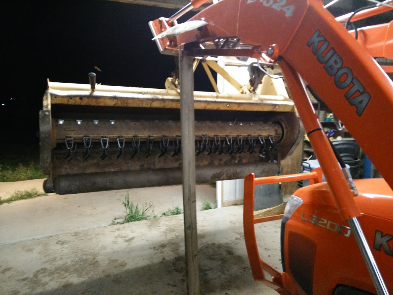

Finally figured out I needed to download the Flailmaster catalog & not look at the useless Flail mower parts page. Have a full set of knives, hangers, D rings, nuts & bolts coming. A bit over $200, so not to bad. Figure a matched set will be better for balance than just replacing the missing one & I'll keep the old stuff around for spares.
A full set of greasable (if available) bearings is going to be around $250. Probably spring for those this fall or winter if the flail works as expected (along with welding up the cracks & tears, probably painting & chainging the gearbox oil too). Bearings are a little rough, but not too bad. Until then I'll probably just use a needle to pump grease into the missing zerk on the roller & keep it covered.

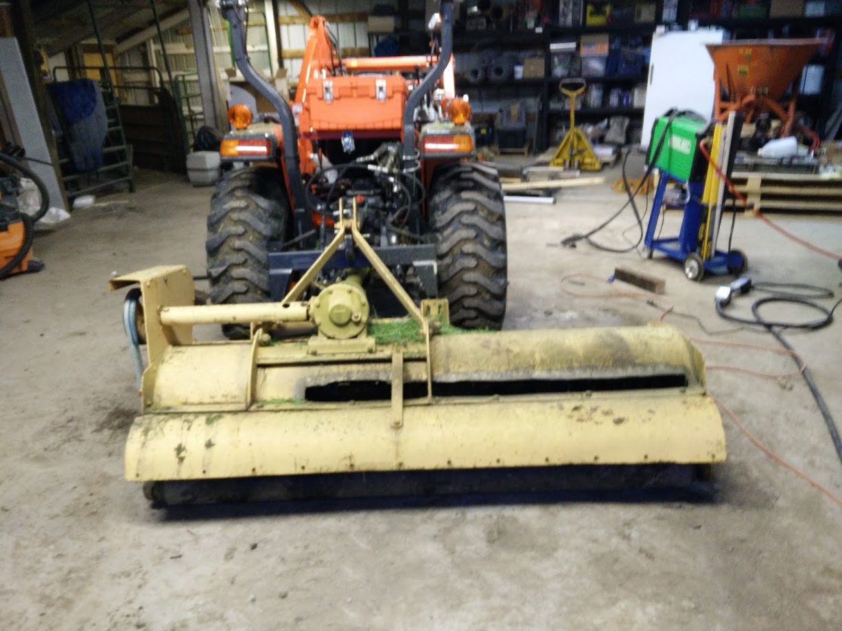

Well, it's a tail of the good the bad & the ugly.
The bad:
Most of the knives were in surprisingly good shape & probably didn't need to be replaced. The flailmaster hangers & D rings were noticeably beefier than the mishmash of hangers that were on there. I ordered the number that flailmaster indicated in their catalogue, but that was 10 short. Left 10 of the good old bits of hardware on until I replace bearings this fall.
The good:
It cuts great. Less scalping than the rotary cutter & a nice smooth cut. The SSQA to 3pt adapter made changing out the knives easy. Tossed in a 2x4 as a safety stop & just went to town with the air gun at a nice working height. Grass was thigh high, a lot higher & thicker than I've cut with the rotary cutter as it's been a very wet spring & I've been slacking on mowing. Flail seemed to use equal or perhaps less HP than the rotary cutter despite being about 25% wider. Works great on my 32hp HST (25pto HP if I remember). Photos from the rear make it look a little bit wider compared to the tractor than it is, but I like the extra width. It doesn't mulch as well as I'd like, but I am mowing thigh high grass, so probably less of an issue if I'm up on things. Leaves a nice smooth carpet of better chopped up clippings on top rather than piles of clumps the rotary does.
The ugly:
Found out why some of the knives were missing & probably why it was sold. Fired it up & heard a god awful clatter of something very night right. There was a couple inch rectangle patch welded on the inside & couple knives would hit that. There were also some small knife strikes along the back corner or the hood & next to that one big knife strike that tore through you can see in the first post. I started grinding the patch inside, then noticed the other strikes indicating the hood got a bit bent (couldn't really see any indication of that other than the strikes though). Busted out the plasma cutter & went to town. Fired it up to double check things worked & ended up doing a half hours worth of mowing down the thistle I was slacking on. Get a bit of a shower of grass when you are mowing with the wind, but it works great. Will pick some thin 5-6" bar stock & patch up the slots later this week.
This winter I'll likely replace the bearings & remaining flails. I'm happy with what I've got now, other than the shower of clippings from the unfinished repair. Killer height control. Set my hydraulic toplink to float which drops the roller onto the ground. Just use the 3pt to set the height. I can lower it to scalp the center weeds on the driveway (actually can get to low & see a few sparks shooting out the back from hitting gravel). Wish I could get an inch or 2 higher I think to leave the grass 6-7" tall, but it's pretty good as is.
