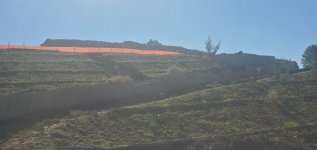

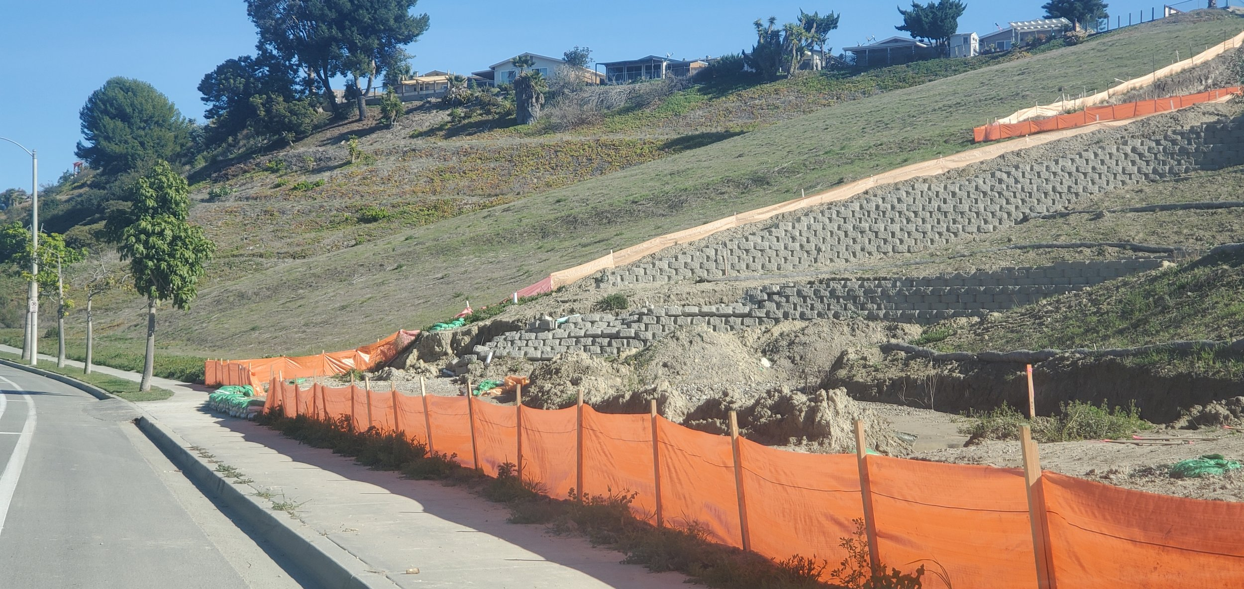

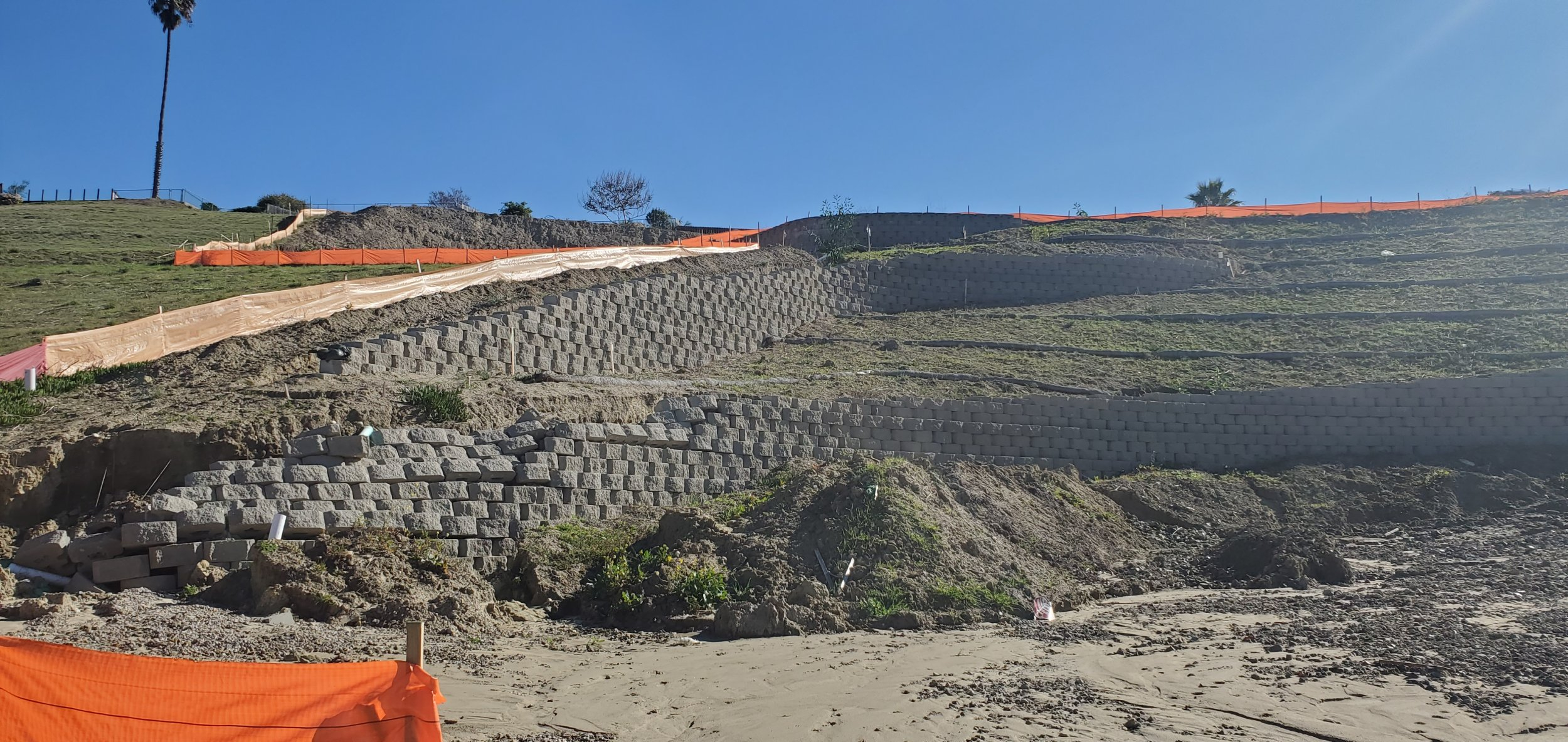

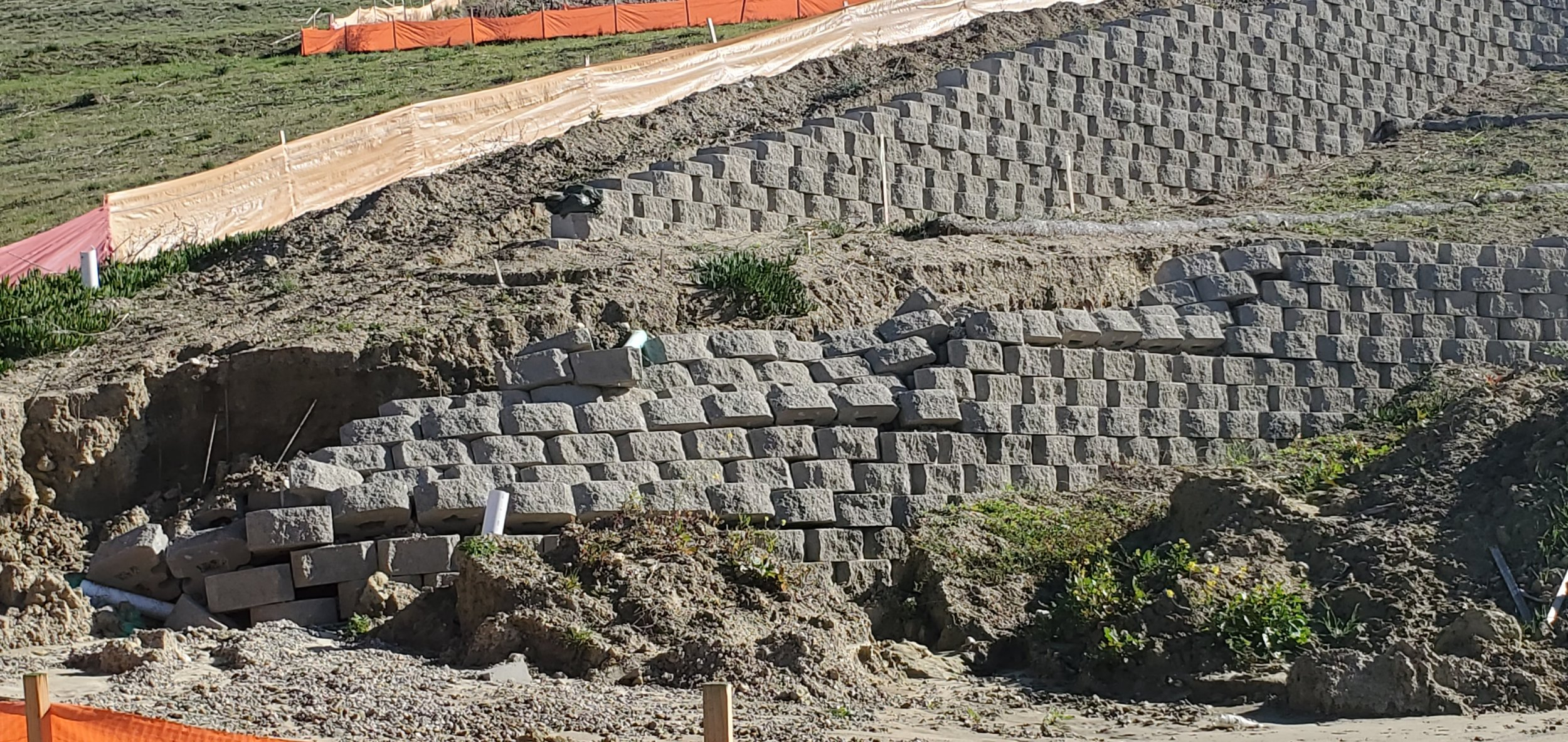

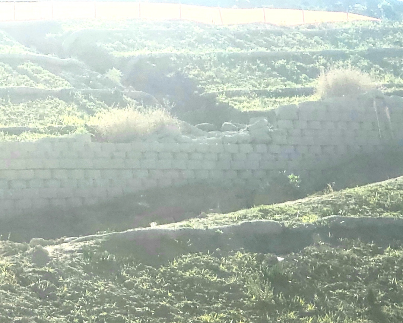

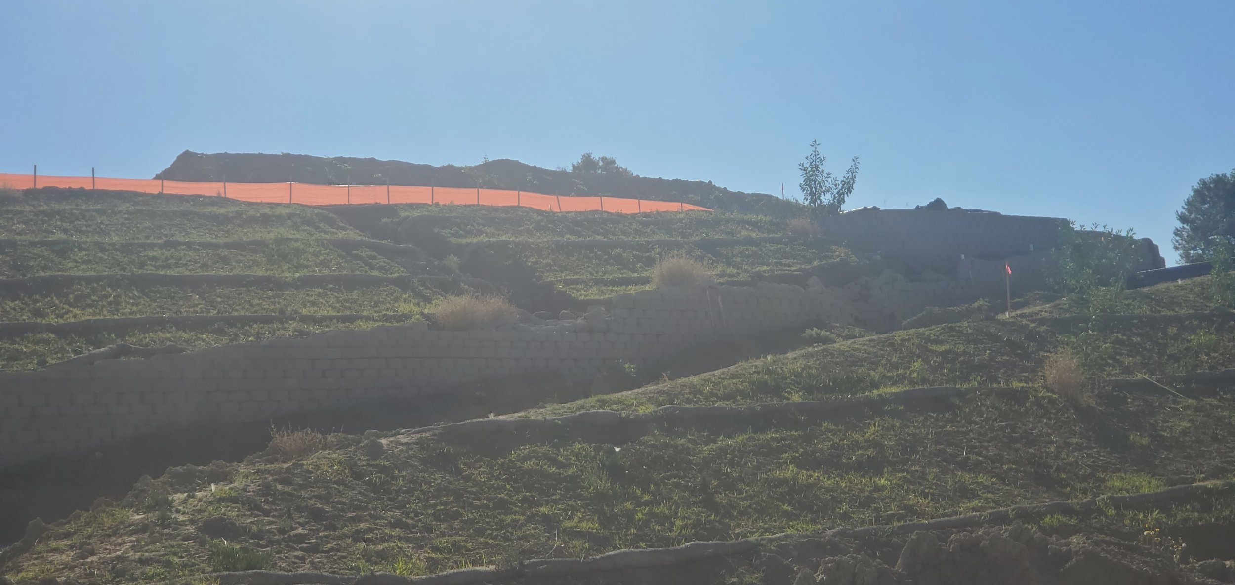

No, not my wall! But rather a new large housing development up on a hill just finished this retaining wall a few months ago... then the biggest rainfall we've seen in years in San Diego came. Could have been worse, I guess but then again this is a pretty big failure in my eyes.

Looks like a failure of erosion/water control from up above, too. Also, it kinda looks like the wall is still under construction, or needed completed drain tile and backfilling? Maybe it would have survived if either of those were completed?
Kind of hard to tell, but the huge amount of erosion and washout under the silt fence says a lot.
   / Retaining Wall Failure #7
Those walls require the soil or rock ballast behind them with force on the back of the blocks to keep them in place in locked together. If that is removed the wall will fall over backwards, which is what you see there.
Major rainfall clearly washed out the dirt behind the wall and that is what contributed to the failure and it was not an issue with the ones backfilled with rock.

There are all sorts of products to tie retaining walls into to the dirt behind them. I can’t tell if any were used or if they just stacked the blocks. There should also be some drainage rock behind the wall. You can get by stacking blocks like that a few high and hold the dirt back been you start getting that high it takes a lot more work.

Building code here would have required mesh to be installed on multiple rows as the wall was built and backfilled plus crushed rock and irrigation pipe. Had that been done and the irrigation ultimately terminated into the street storm drain flow, I don't know why it would have failed like this. I guess at a certain point enough water will erode just about anything.

Hydrostatic pressure is #1 enemy of retaining walls, but there are many ways to fail.
If you do not understand the forces (even though you think you do) you cannot possibly engineer or build a wall.

The most common fallacy is that the block are the retaining wall.
The retaining wall is the engineered backfill behind the wall.
The block is just a more durable face.

Most retaining wall codes do not specify construction.
They require Engineering drawings stamped by an Engineer. The Engineer is responsible if the wall fails if installed according to engineered drawings.
On most walls, I designed the wall and paid an engineer for review. If the wall was in a difficult situation, I hired a design engineer with retaining wall experience. The wall in the picture, I would not have designed. The wall above it is a "surcharge" load on the lower wall. It does not appear that this was taken into account. I very much doubt an engineer designed that wall the way it was constructed.
