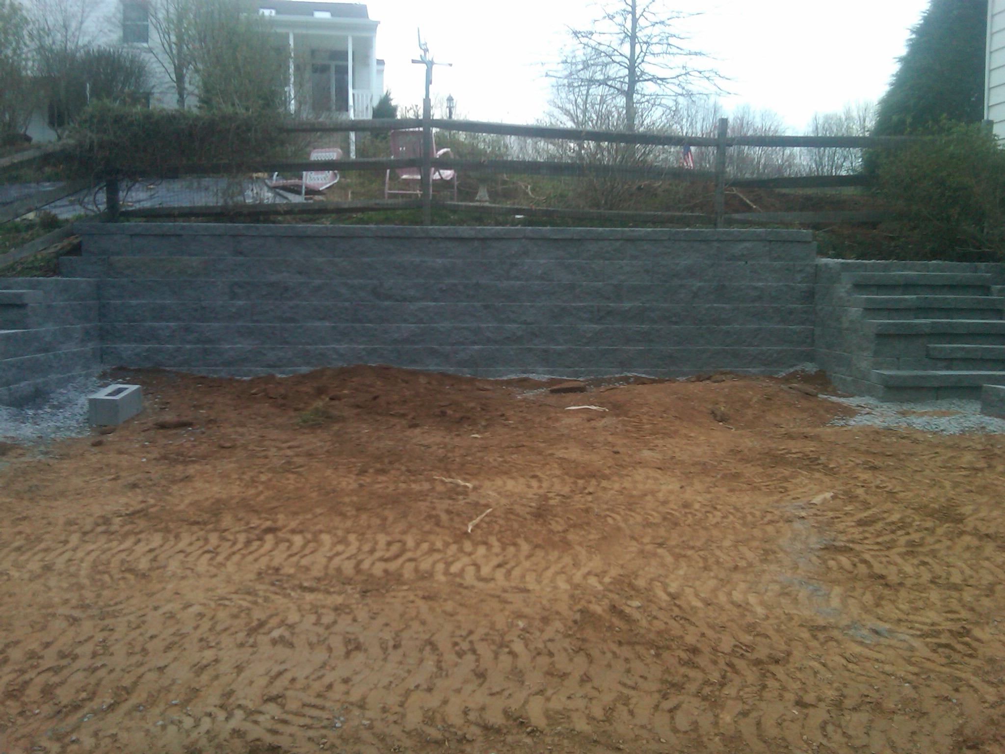

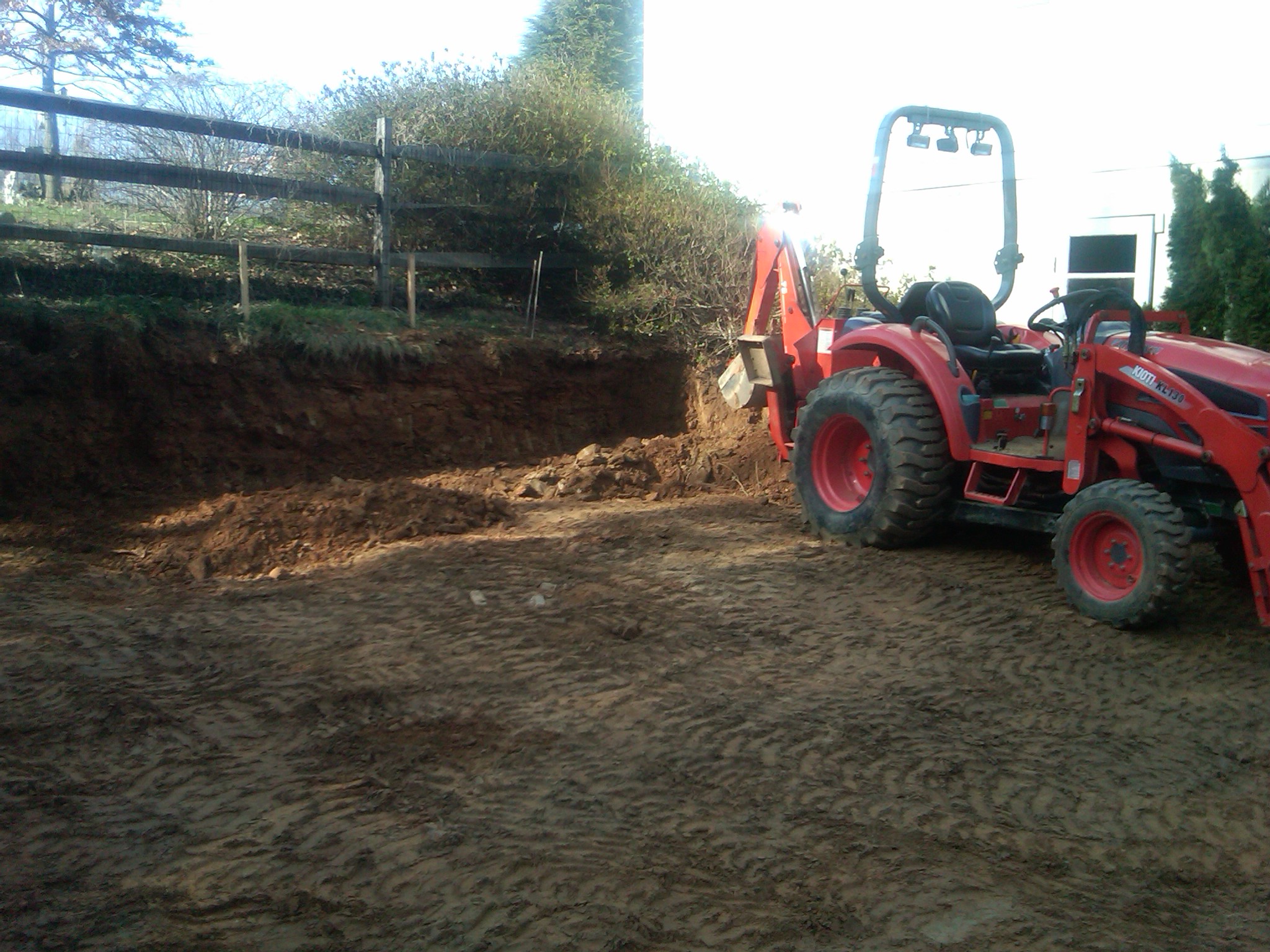

Still under construction. But, getting close. It's 28' across and 4.5' high. Used about 20 ton of stone between foundation and backfill.
Tractor has been indespensible. Couldn't have even attempted to do this job without it. My back is aching though. Wish I could have found a way to use the tractor to place all those blocks:D

   / retaining wall #2
Nice clean work. Having put in smaller walls, I can appreciate the effort yours took.
One thing I don't understand is the missing step. It looks dangerous.
Also, what technique did you use to level your footing fill? It looks flawless.
   / retaining wall #3

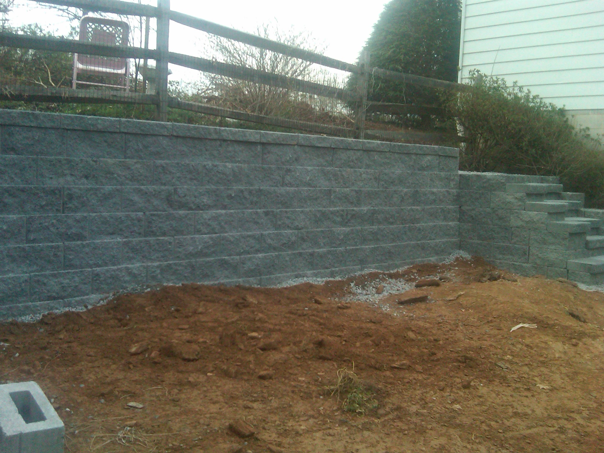

Looks like the missing step is an optical illusion. The last picture shows how the steps are laid out. Nice work.

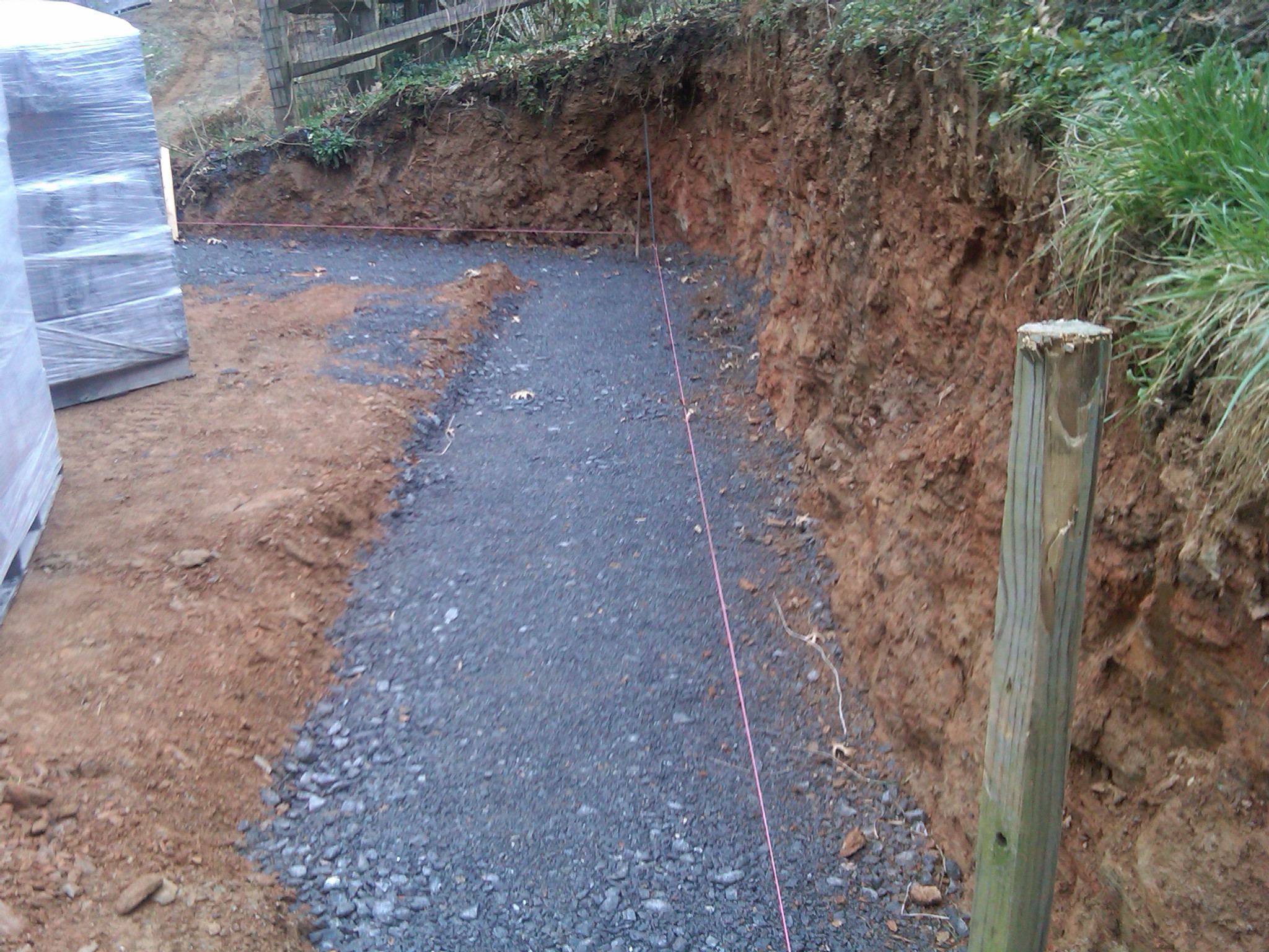

   / retaining wall
Thanks for the compliments, everyone.
My method for a level base isn't very scientific. I leveled it pretty good when I dug out the trench, not miticulously, but "about level". Then I put 8" of crusher run in the trench, tamped it real good, and leveled that with a long 2x4 and a 4' level, and tamped again. I used a short 2x4 and a torpedo level to level it front to back. Then I miticulously leveled each stone as it was placed, both to earth level and to each other. I used the bullet level for each stone and the 4' level to keep stones level to each other. The 4' level would cover every group of three. A big rubber mallet (I think this is the key thing) came in real handy for beating them down when just a little high (I wore out my cheap chinese mallet and had to buy a new one today). Needless to say, I still lifted and placed each stone probably on average somewhere around 2.5 times each for that first course as I would set them, find them too high or low, take them up and add or remove cnr, and tamp again.
What you see in the photos took me 2 long (12+ hour days to do), not including the digging, trenching, and cnr leveling. That took another 8 hours or so. I worked on it today for another 8' or so, but at a much slower pace because I'm worn out. Now cutting through the fence and continuing the steps on up the hill.
Getting that first course level is the most important thing. Then the rest is just mindless, back-breaking, stacking. And it's like the "Prince and the Pea" for subsequent rows. The smallest gravel under a stone will cause it not to sit flat. So, do a good job sweeping when you fill. The rubber mallet helped here sometimes too.
The photo angle of the steps makes it look like there is a step missing, and actually the top step tread is missing, as are all the caps on the right side (I've decided to leave the rest of the caps until last). That top step, when installed will actually be part of a 6'x6' landing where I will be putting a gate through the fence before going up a few more steps.
Hand railing is next. Not sure what I'm going to do there. Probably just use iron piped planted in concrete, with welded pipe rails.

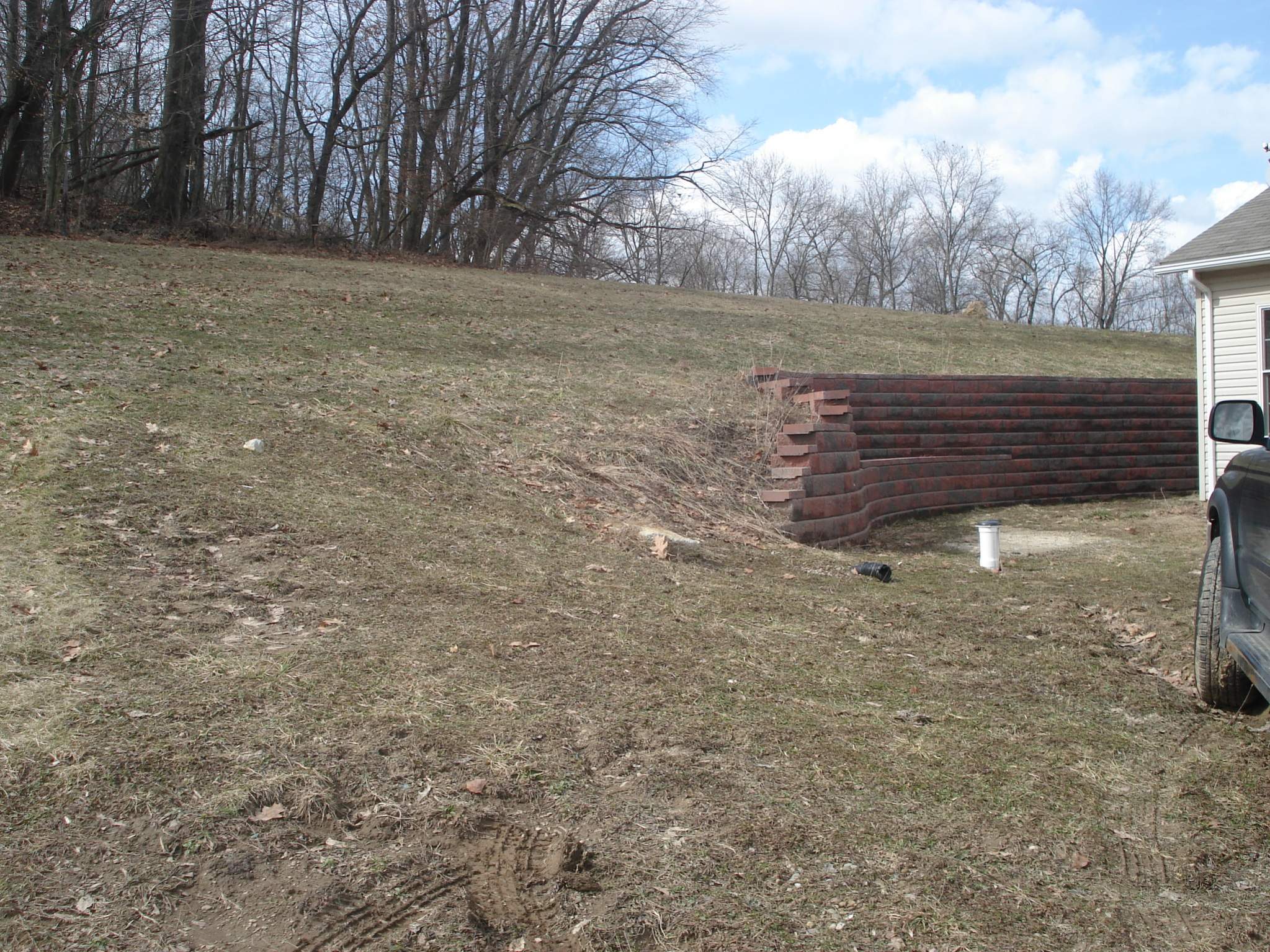

   / retaining wall #7
Gittyup -
Very nice work! I just bought a house with a 50 or 60' retaining wall behind it. I'm going to add a garage so will be extending the wall a bit. Not looking forward to that part of it.....
Question;
I looked closely at the pics, but can't tell if the wall is vertical or stepped back?
When we were househunting, we looked at a house that had a small vertical retaining wall that was failing....although it was holding back a HUGE bank, probably 50 feet high.
Just curious?

   / retaining wall
Gittyup -
Question;
Just curious?
The blocks I used have tabs on the bottom that lock into the row below. The tabs locations force the wall to angle back 5/8" per row. So, yes it angles back, except around the steps, where I deliberately made it more vertical by knocking the tabs off on some rows. This project has been way more work than I thought. So, be prepared for it.
Watch out and plan for your septic (or is it a well cap) I see in your photo.
   / retaining wall #9
OK, got it. looks like that wall will last 4ever!
And yes, that is my well cap that I will work around, thanks!

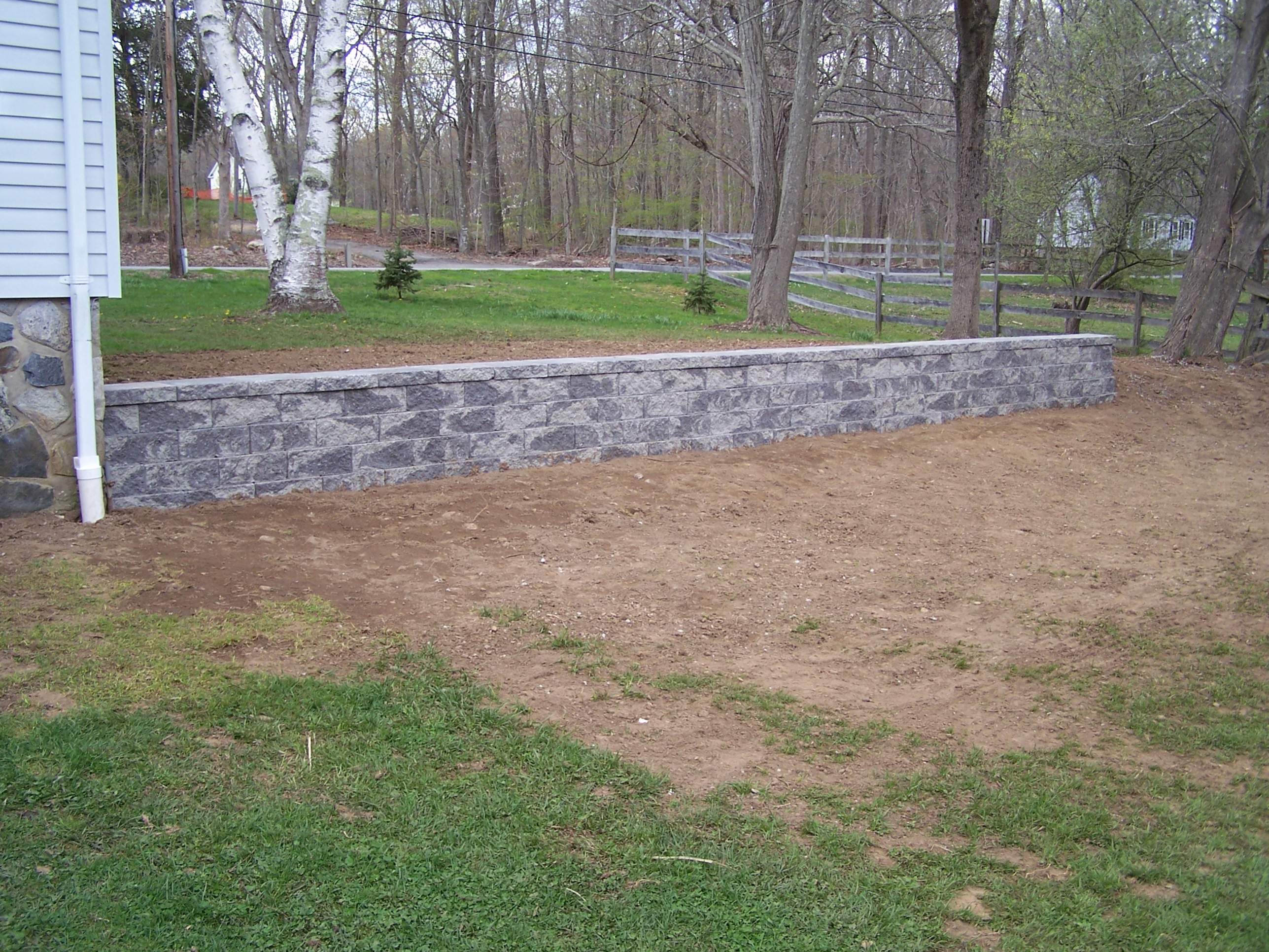

   / retaining wall #13

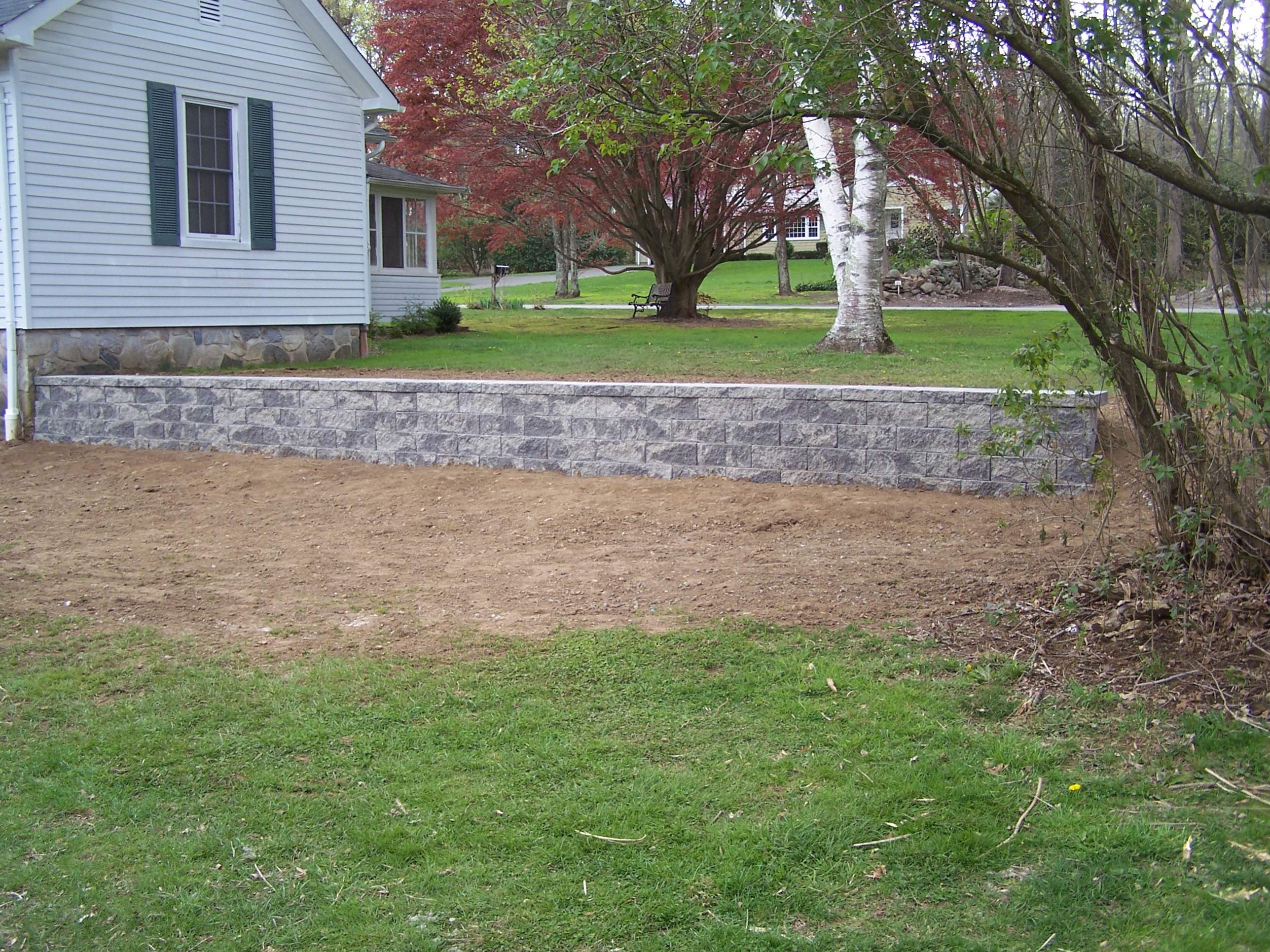

Here it is Gittyup.
Just a straight wall, 32 feet long and 2 1/2 feet high.
You must be a workaholic, cuz there's no way I wanted to be lifting these blocks for 12 hours a day. I probably worked 7 1/2 hours on Saturday and 3 on Sunday before I got some seat time on the tractor and did the backfilling and grading. I cheated a little though. I had my neighbor come over with his brand new blue tractor to do the york raking.
