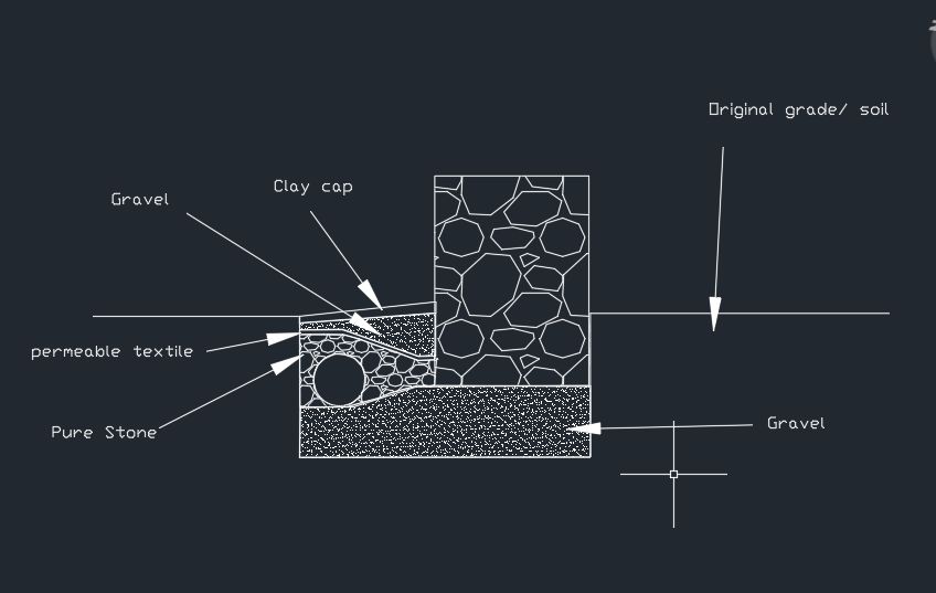

Fill gravel at the bottom too. If you use expansive soil and it freezes, it may move your foundation and you don't want that. The space the stone fill creates is your freeze buffer, so you want it all the way down. And compact it as you go. A jumping jack works well for this. The stone will fill in up to the soil behind at the back of your trench and support the wall from moving just like soil would but without the freeze expansion risk.
   / Putting a drain pipe through a retaining wall #18
You want a non woven filter fabric for the wall. They make various types and grades of fabric. Make sure the fabric you buy is water permeable. Backfill entire depth of wall with uniform sized gravel

You want the water to run away from the wall and a place for the water to flow too, the illustration is how I would personally do it, now I am not sure if you want pure stone below the wall or not but I would think it be a good idea although I am not sure if I would or not. Compacted gravel like 3/4 minus is pretty impermeable so the pipe can be on that (actually better to be on gravel) but the grade should go up from there to the base of the wall like the illustration below. Now only pure stone with a permeable textile would be fine as well as long as you have a permeable textile on top... pure stone has 30% void within it but flow grade is paramount.
