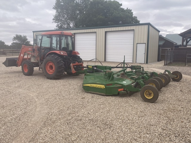

I mowed some today with the 12’ cutter. The 15’ won’t be here until next week. The 12’ is no sweat. I ran it in the 540E with the lower RPM and it handled everything fine. The only time it slowed at all was when I ran over some uneven areas and was mowing dirt. I think I will be able to handle the 15’ no problem.
   / Rethinking rotary cutter sizing
#25
I finally picked up the Deere HX15 and tried it out today. I mowed about twenty acres with it. Part of my property is on the edge of a lake bottom and grows thick and there I had to slow down some but I never stalled the tractor. On the higher ground it handled it fine as fast as I wanted to go. I really like it and it sure gets the job done faster. I made a call and have a buyer for my 12’ landpride at the same price I paid for it.
