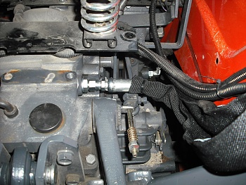

If you don't want to cut the line you can replace it with adapter fittings and hoses, I haven't checked the 2601 yet but it appears to use the same valve for the loader and fitting on the transaxle for the 3pt as the B2x20 series.
If that's the case then the banjo fitting on the valve can be replaced with a SAE 8 o-ring fitting, and the 3pt fitting on the transaxle uses a 3/8 BSPP.

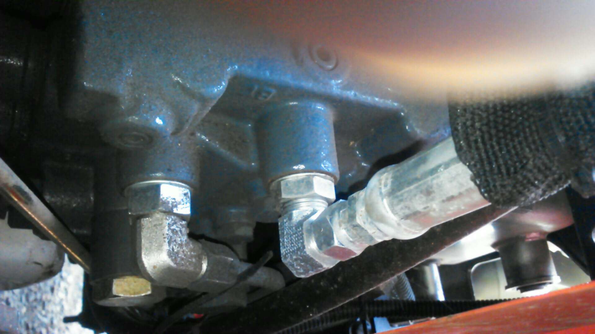

Here's pictures from my B2620 after I added rear remotes, you'll use the same connection for a backhoe.
The loader valve picture won't load.
   / retro fit John deere 7 to kubota b2601 #9
Found a picture of the loader valve
I used a sae8 to jic6 90* to connect the hose
   / retro fit John deere 7 to kubota b2601 #10
