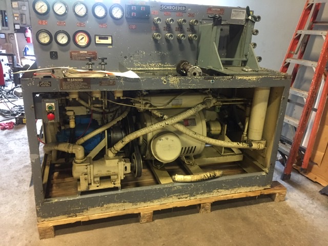

Too bad you’re a little distance from me. Our shop is setting up a 100 hp hydraulic test bench this next couple of weeks. That pump would be perfect to try out.
   / reverse direction
#12
I'm not sure I want to put 100 hp to these old buggers. lol. However, your welcome to bring the motor here and put it in my bobcat, ( just to check it of course) .
   / reverse direction #13
Lol.......not that kind of motor. It traveled from Billings MT and it won’t be moving anywhere soon. Electricians are wiring it this week.
   / reverse direction #15
We’re hoping, it will test pumps and motors dynamically up to 100 gpm/5000 psi. Having a soft start installed to keep the elec man happy.

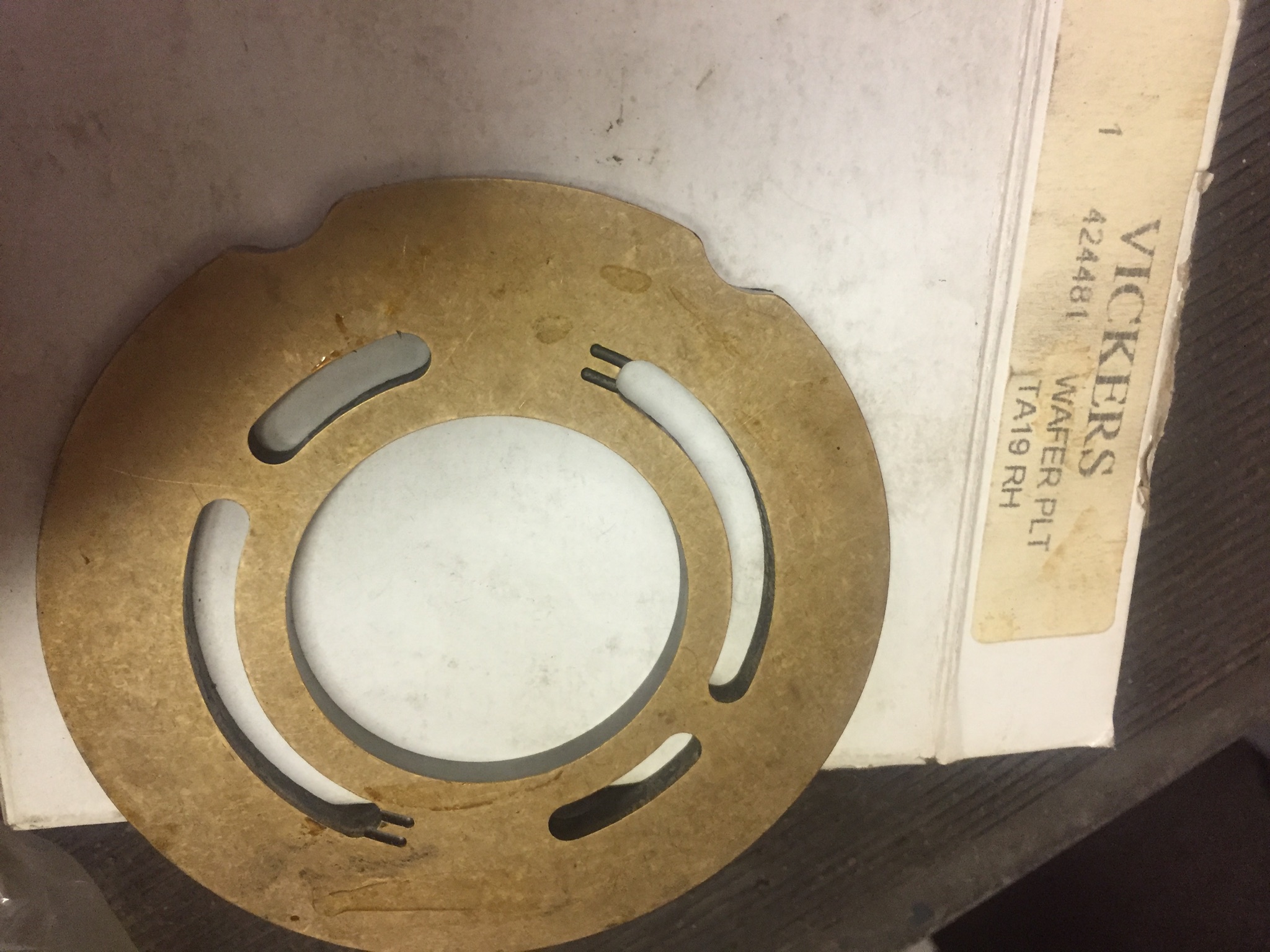

Sundown,
I struck out in finding any parts breakdown documents for those older transmissions. I did find a technical data sheet for the TA1919 series which I believe was similar to the TA1515 and they do show exactly what you are describing in having the vane pump as external charge. So I agree with your finding that you will have to change rotation on the vane pumps but hydrostatics might operate in either direction. Not 100% convinced since still not sure if the port plate, or lens plate is the same on both.
   / reverse direction #18
Oldnslo,
The TA1919 uses a wafer plate that is right or left, if it was his case the two wafer plates could be swapped around between the pumps. But as he says I seem to recall the TA15 pump rotating group is directly riding on the housing, similar to PVB series piston pumps. Not sure, but just an educated guess.
Here is a pic of the TA19 wafer plate, you can see they come in left or right config
   / reverse direction #19
Ooops, I see now you have the info........;)
   / reverse direction
#20
I just dont know if i have TA1515 or TA1919. cant find any numbers on it at all
