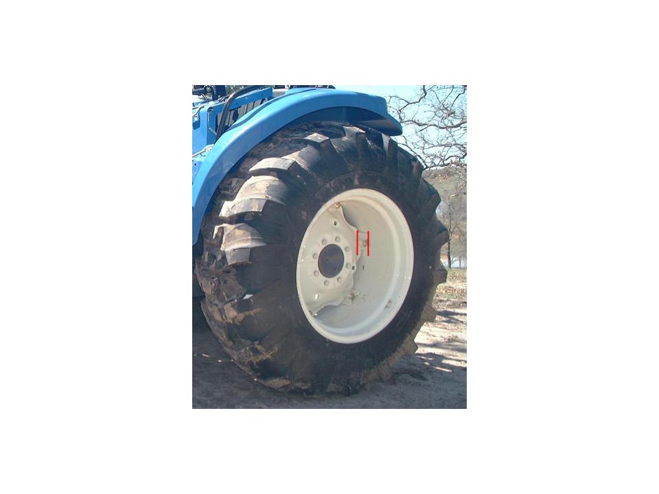

Well we turned the inner wheels today. A jack, jack stands, engine hoist and about 3 hours we had it complete. Man those bolts were tight. I gained about 10 inches of width on the tractor. Plenty of room for the chains. Don't have to worry about the chains taking out the plastice fenders. Now it is wider than mean 72" blower though so hope that won't be a problem.
   / reverse wheels? #16
I know you don't want to bother with another adjustment, but if you see you must change it, you can adjust the wheel width again by choosing which side of the outer ring bracket you mount the inner ring on. If it is on the inside, then you move it to the outside and trim about 5" off your width or whatever the bracket width is x 2. See attachment. However, you do have to reverse the head of the carriage bolt so it comes through from the back of the wheel with the nut on the outside.
   / reverse wheels?
#17
We did look at that when we had the wheel apart and decided to put the inner wheel on the outside of the outer wheel. The other way would have been even wider and I don't think I needed that.
