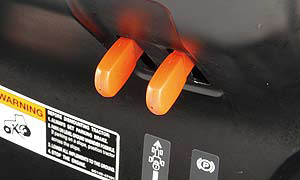

Hello does any one have the same problem when backing up a long way the pedal is so hard to push Ive gave may self a hernia I have to keep a bush road clear to get out every day except sundays has any one devised a hand operated lever Ive even looked at the return spring to possibley change it out for lighter one at my age now 68 my days of owning a kubota maybe be done . thanks from cold northeastern Ontario
   / reversing a B2620 with rear mounted blower #2
on your b2620 near your right knee is there not 2 orange levers on the underside of the dash?
one locks down the brakes and the other locks down the hst pedal (basically cruise control) so you do not have to stand on the pedal for hours at a time when doing what you are doing.

Does the cruise work in reverse on the B? I tried on my BX and it doesn't. I'm just trying to keep my + and - column up to date

On the 2650 I have cruise control but not in reverse , I would much prefer two peddles rather than the rocker set up when trying to back up . The brakes are both on the left so it would be no problem for Kubota to do that . Like mentioned it is very difficult to try and turn and look backwards and use the rocker set up . I guess a back up camera is the answer for now .

Cruise does not work in reverse on B20 series. I added mirrors to my open station so I don't have to keep looking backwards.
