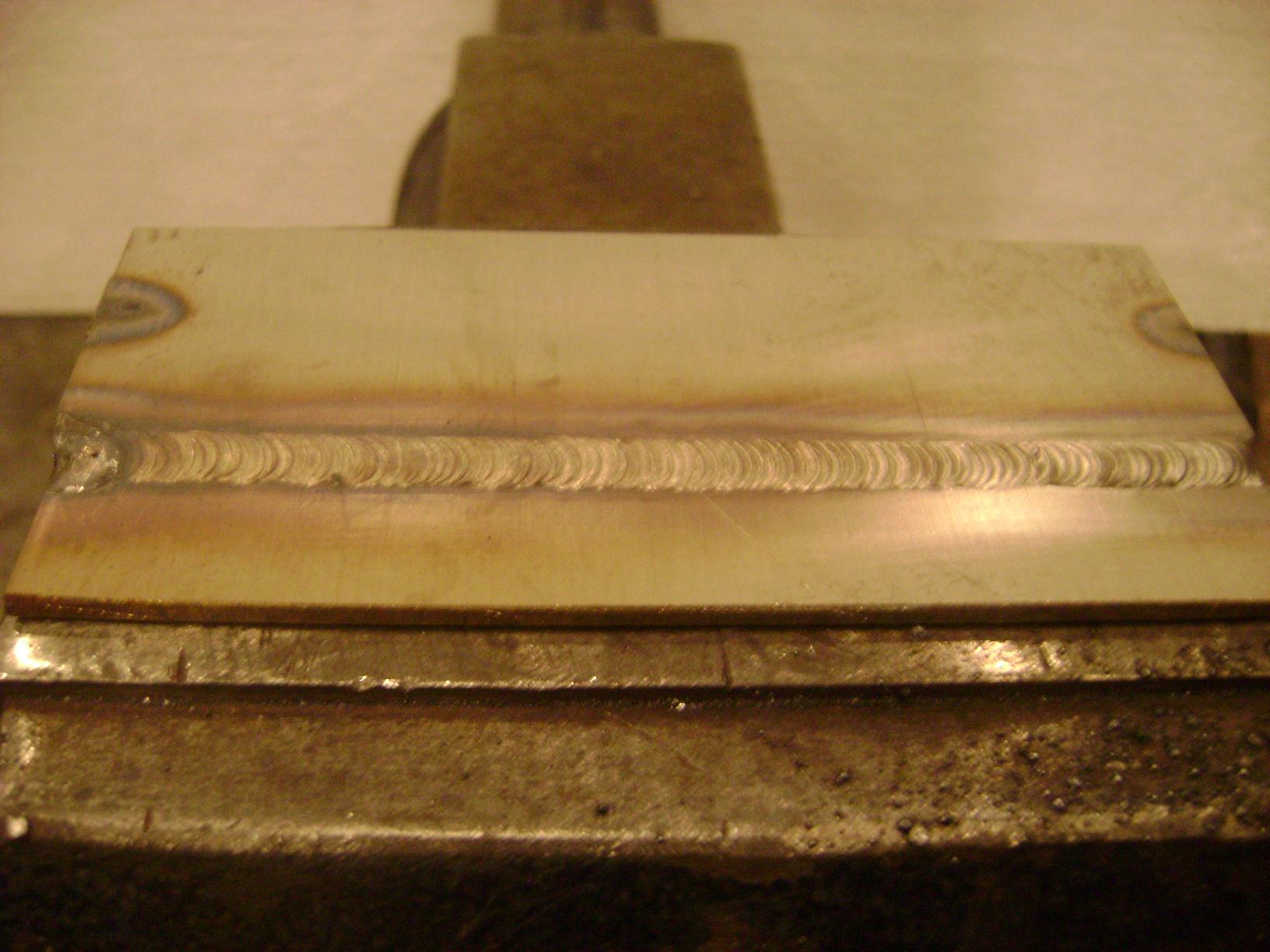

You know you can Tig weld with any DC buzz box, a Tig rig, and a bottle of argon? You can even do aluminum.
DCEN with 100% helium. Pretty much cut your amps in half from AC with 100% argon. Only problem is you have to make short welds, no way to control the heat, as the heat builds up in the material.
Here is some I did on DC with a Tig rig, and a Stainless steel Tig weld I did with my Everlast PowerArc-200.
