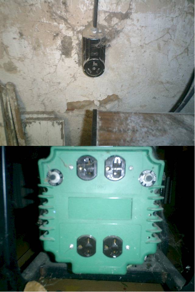

BTW, what do you think of the attached wiring setup? Would this meet code would you say?
Happy Holidays to all,
Bob /w3tcompact/icons/smile.gif

/ Revisiting the PTO-generator question #96
How'd you manage to get hold of pics of Raytheon's new install down at McMurdo, do you know Steve too?

<font color=blue>How'd you manage to get hold of pics of Raytheon's new install down at McMurdo, do you know Steve too? </font color=blue>
No, it just seemed the obvious way to wire it up. Good to know that others also came up with a similar solution.. means I must be on the right track! /w3tcompact/icons/grin.gif
