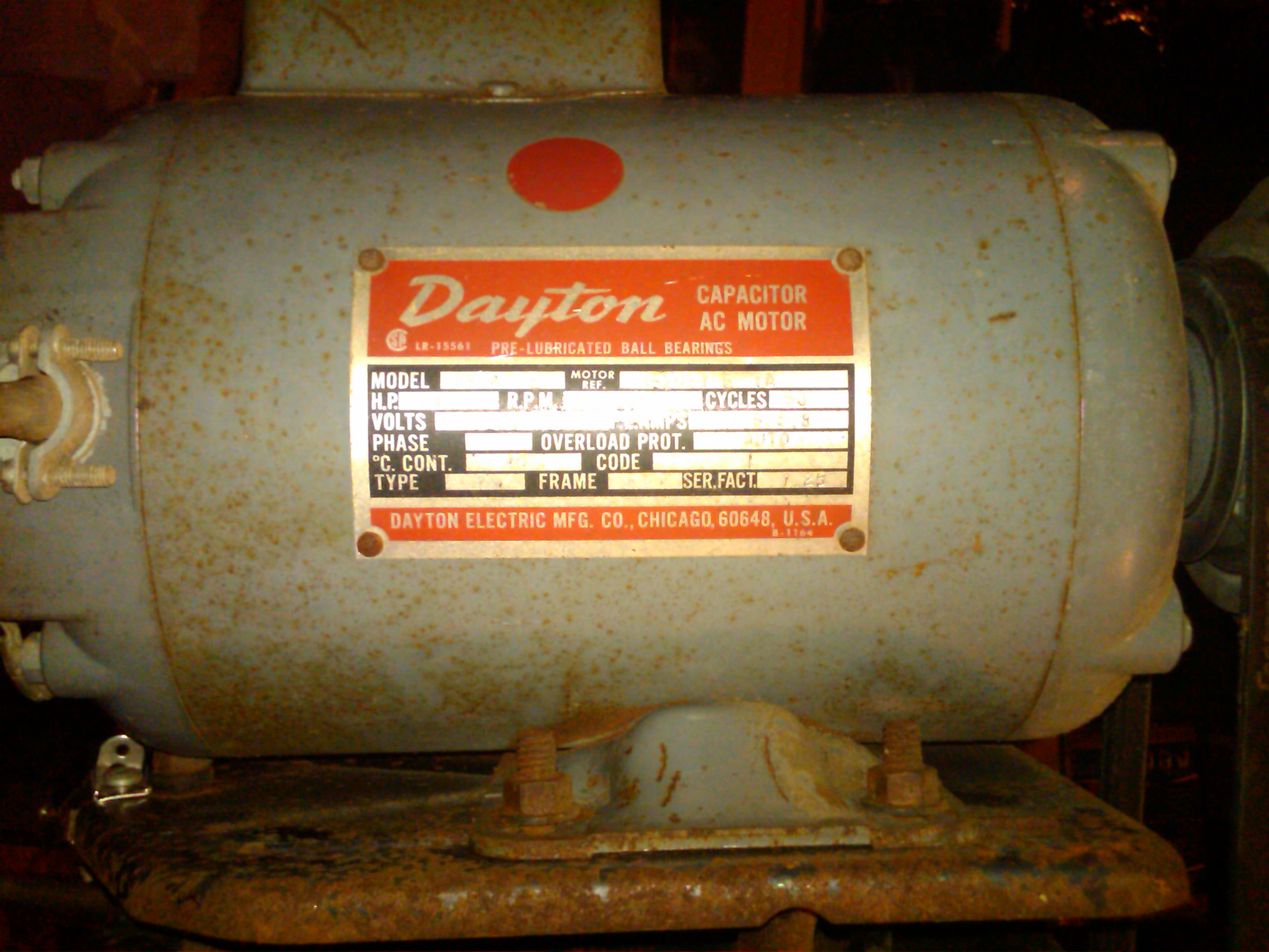

I inherited my Grandfathers woodworking equipment years ago. This equipment is 45 years old and HEAVY cast iron and thick metal. I swear the table top drill press has to weigh close to 150 + lbs or it at least felt like it when I carried it from the back of the truck to the basement:D.
I had stored it at my dads for the last 15 years in his workshop, when he was diagnosed with Alzheimer's and before he passed, I was worried about him hurting himself so I cut the plugs off the equipment. There also was some dry-rot on the wire with exposed wiring.
I am now moving the equipment to my house and plan to rewire all of it as the insulation just crumbles when moving the wires.
I currently have the drill press and bandsaw at the house. The drill press has a switch on it that I feel sure my grandfather added as I cannot find one on line with a switch. The picture show the switch and motor.
Any suggestions on type of wiring to use and would you keep the switch on the press? Most of his equipment has no switches, you just plug them in.

I would definitely keep switches on them and if possible add them to the machinery that doesn't have them. Locate them in a VERY easily accessible area. There's no accounting for safety.
   / Rewiring old Craftsman Woodworking Equipment #4
The old rubber SO cord tends to dry rot like that. Get something Like SJO SEOW etc. there's charts showing what all the letters mean. I like putting foot switches on drill presses. When something goes south while drilling....and it will.... you step back and it shuts down.
Get switches rated at 20amps.

I wouldn't have a drill press that size without a foot switch. Your arms will be turned into papaya leaves before you have time to reach for a switch.
   / Rewiring old Craftsman Woodworking Equipment #7
The wire isn't that hard - any Home depot/Lowes/Menards/etc will have what you need. The letters are more self explanatory than you might think. from my recollection:
S= service cord (basically stranded wire for flexible cords)
J = Junior - lighter duty insulation, but fine for most shop applications, especially if the cords stay put, out of harms way 99% of the time
O = oil resistant. Good to have
W = water resistant, ditto
Anything else is bonus. So SOW or SJOW or anything that at least has those letters in them is fine. That is all you will find at the home centers, and probably all you will find at the electrical distributors (without buying your own 1000' spool...). There are more letters you will see that mean more specific things, but frankly it doesn't matter for most people. At least that is my $0.02. If you are curious what they all mean, google the wire codes.
I remember when the boys who started OWWM and VM and the like were on Rec.woodworking back in the Real Man (tm) days of the internet. Times have changed...
But there is nothing here that is real serious. You just need to replace old wire with equivalent or better type of the same or larger gage (remembering that smaller numbers are larger gage - you never know what people do/do not know in the internet, so my apologies if this is basic to you). Take several pictures before you disassemble in case something goes flooey. Nothing real hard here, unless you are really unsure of yourself with wiring. In that case, find an electrician.

In the power plant I worked at some types of SO cord (generic electrician term for flexible cord) would just get brittle after a few years in heat, like your pictures show. The rubber jacket stuff just wouldn't last. We started getting T rated thermoplastic stuff....most extension cords use this. it's a tad stiffer in cold weather but holds up well.
Nothing really generic about it....
S = Severe Service Cord
O = Oil Resistant Outer Jacket
