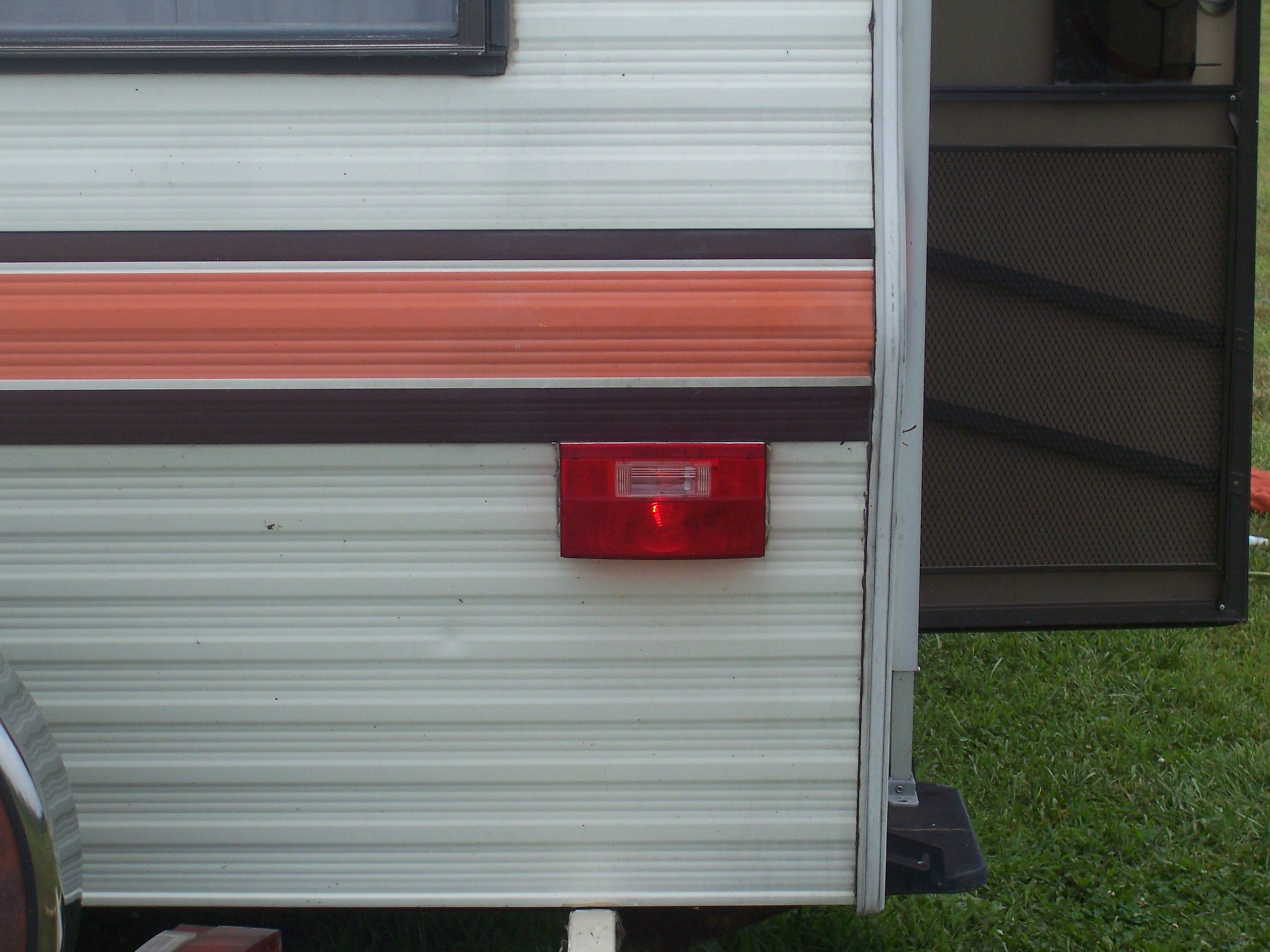

My camper has back-up lights. Never knew they worked until I plugged it into my Silverado with a factory wire harness where the factory actually hooked the reverse lights up. So some RVs actually do use the reverse circuit. Now that I think about it, Mom & Dad's old camper had back-up lights that worked as well, but the truck wasn't wired for them as it was wired my some hack that my uncle had do it and I didn't hook them up either when I fixed his lousy job.
I've now added a picture of the back of our camper right after we bought it. I went through and replaced all of the lights. Taillights I bought the same type that were on it, clearance lights I bought LED. Couldn't get the lights to work. Turns out there was a fuse inside the trailer for all things connected to the truck that was blown.
