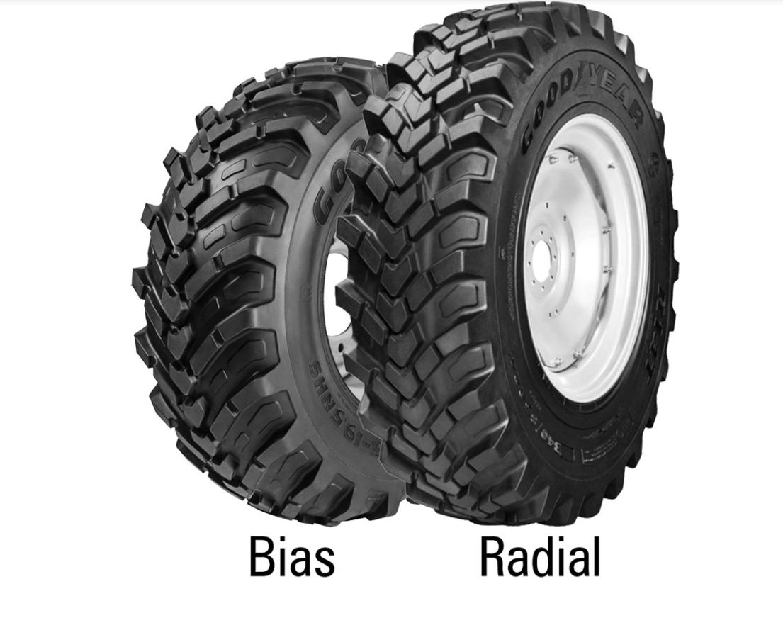

Big difference between R14s. Look like they would be more prone to thorns and nails. Also looks like bias is more open between tread.
   / RF14's: Let's find out.
#9
I wondered about that, though R1's are generally a lighter-built carcass than for example R4's. I'm HOPING the R14's are built on R4 carcasses, which would make sense from a manufacturing efficiency POV, becuase R4's are supposedly more puncture resistant than R1's. The R14's are heavier than R1's - more plies/more rubber, I'm pretty sure. I'll have to compare th weight of 15-19.5 R14's with the equivalent R4's and with the 11.2-24 R1's which were the original option, if the information is available, which I suspect it may not yet be.
I've actually never had a flat in a tractor (My Farmall 340 had some sort of slow leak, but life is too short to fuss with that sort of thing. I just blew a little air in there when I was in a conscientious state of mind, which fortunately I generally am.)
If I get any info on the weight of R4/R14's, I'll post it here. Maybe somebody knows whether they are on the same carcass or not.
