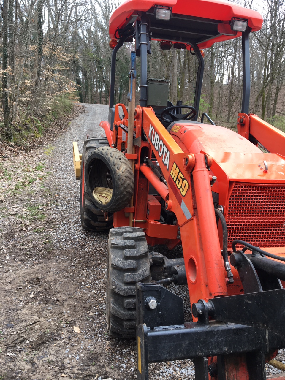

Electric tire groover eBay $60-80.
Chainsaw disk for carving wood on grinder works too. $20-45.
Tire groover allows you to sipe the tread also. Suppose to help snow and ice. Any extra edges help. Have not tired this yet.
R4 rubber is harder and longer lasting than R1.
Had well worn R4 front tires (1000hrs) on the front of the M59. Grooved them (chainsaw disk) for some muddy loader work and bush hogging. Helped.
Sold them and bought extra deep R4 tread tires for the front that worked better.
Hard to beat tread depth for soft ground or mud. Farmer who bought the used grooved tires liked them for his skidsteer.

On the little B26 the R4 are ok. The grooves help with traction with lawn and the little snow we get.
The M59 with the R4 tires has less traction than a similar tractor with R1 ag tires. Been trying to figure out ways to improve traction but not compromise the durability of R4. The extra deep lug, 12ply fronts have helped with loader operations. Everything is on a slope so mowing or bush hogging are in 4wd.
