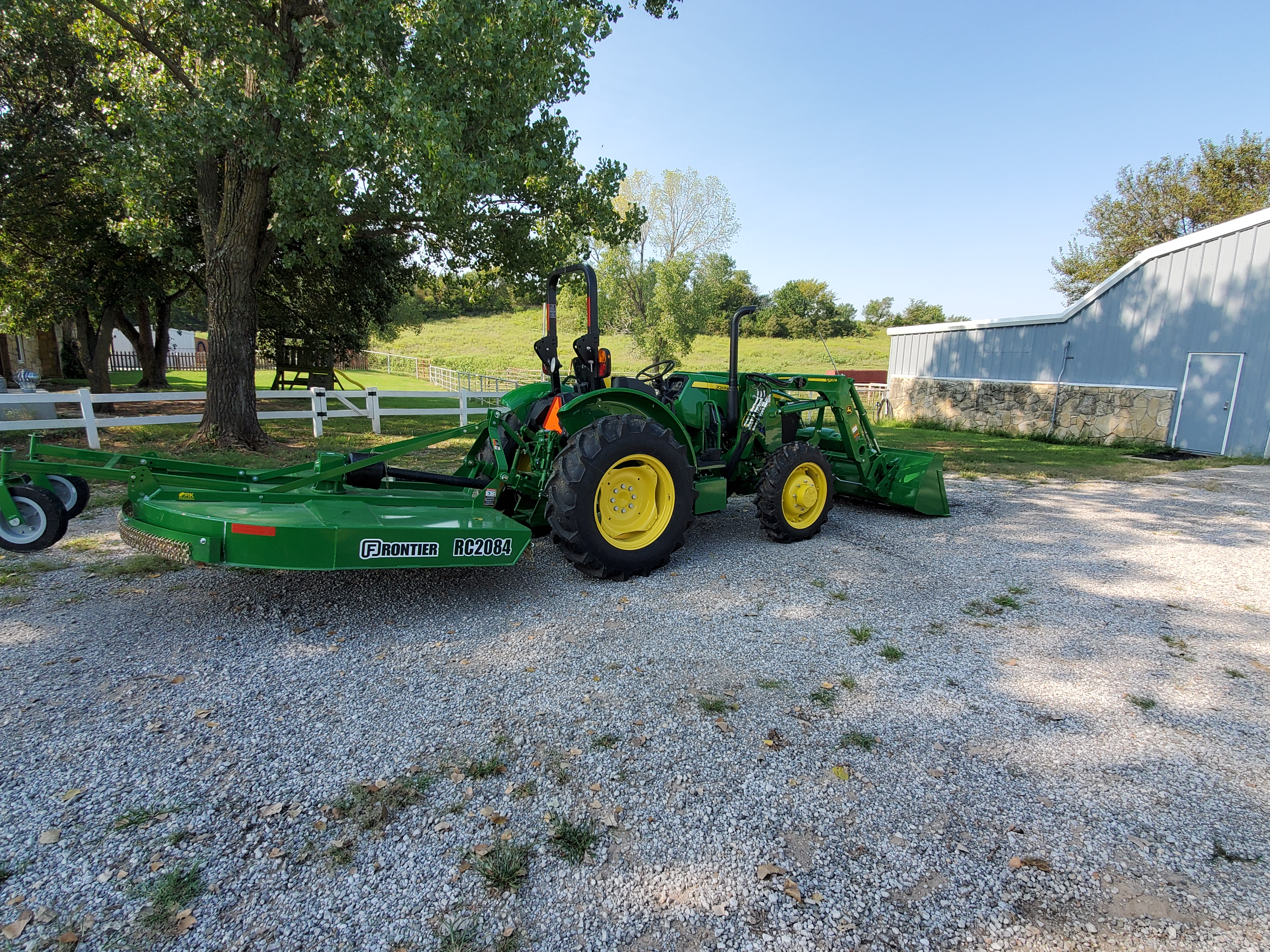

John Deere 4044M
2014 - 4M Series
Compact Utility tractor
Previous model: John Deere 4120
Series next: John Deere 4049M
Manufacturer: John Deere
Factory: Augusta, Georgia, USA
Variants:
4044M: base model
4044R: deluxe model
John Deere 4044M Engine:
Yanmar 2.2L 4-cyl diesel
John Deere 4044M Power:
Engine: 43.1 hp [32.1 kW]
Gear PTO (claimed): 34.6 hp [25.8 kW]
Hydro PTO (claimed): 33.6 hp [25.1 kW]
Capacity:
Fuel: 13 gal [49.2 L]
3-Point Hitch:
Rear Type: I
Control: position control
Rear lift (at ends): 3130 lbs [1419 kg]
Rear lift (at 24"/610mm): 2500 lbs [1134 kg]
Power Take-off (PTO):
Rear PTO: independent
Rear RPM: 540 (1.375)
Engine RPM: 540@2400
Dimensions & Tires:
Wheelbase: 73 inches [185 cm]
Weight: 3770 lbs [1710 kg]
Length: 130.6 inches [331 cm]
Height (ROPS): 100.2 inches [254 cm]
Height (cab): 97.4 inches [247 cm]
Clearance (front axle): 13.8 inches [35 cm]
Front tread: 53.6 inches [136 cm]
Rear tread: 59.9 inches [152 cm]
John Deere 4044M attachments:
front-end loader
backhoe
all 4044M attachments ...
Mechanical:
Chassis: 4x4 MFWD 4WD
Final drives: planetary
Differential lock: mechanical rear
Steering: power
Brakes: hydraulic wet disc
Cab: Two-post folding ROPS.
Hydraulics:
Type: open center
Pressure: 2500 psi [172.4 bar]
Pump flow: 10.2 gpm [38.6 lpm]
Total flow: 15.9 gpm [60.2 lpm]
Steering flow: 5.7 gpm [21.6 lpm]
Electrical:
Ground: negative
Charging system: alternator
Charging amps: 75
Battery:
Number: 1
Cold-cranking amps: 770
Volts: 12
