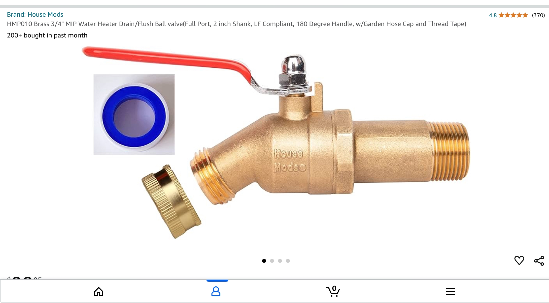

I got these drains off of amazon. They allow full port drainage under pressure. Really empties crap on bottom of WH tank
The cap is important especially in a rental...
I had a tenant's child open a valve just enough to do lots of damage...
Since then I cap and document plus any unused washing machine hookups.

If i had kids, id remove the handle
The newer Rheem hot water heaters don’t have a handle on the faucet to open the drain, they have a slot for using a flat blade screwdriver to open and close it.
I dunno...mine has a plastic handle on the drain, and it's only a couple years old. I've seen those screwdriver slot ones before, I think my old HW heater had one.
