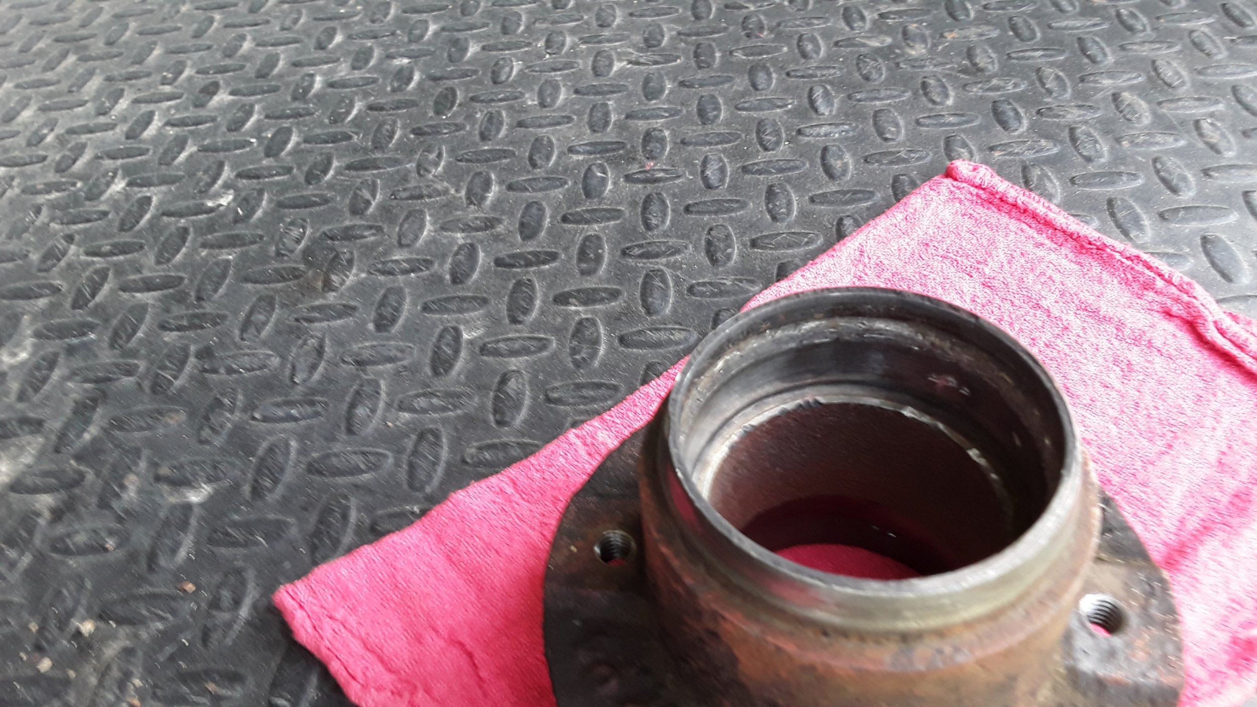

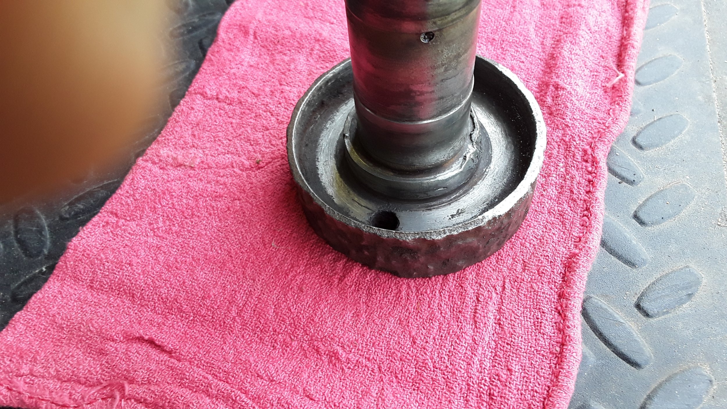

I'll try to get some pictures today and post them. These bearings are actually the same as wheel bearings available at automotive parts stores. I found them listed by all the stores in my area. My only concern is where the spindle meets the inside bearing. It's rolled up a bit from the failure of the old bearing and will not let the spindle fit flush against the new bearing. I know this will cause premature failure of that bearing. As far as the housing goes, also on that same side, there is wear where the seal goes into the housing from the wobble from the spindle which may prevent that seal from seating correctly. I'll get some pictures posted so maybe you can see what I'm talking about.

workinonit, thanks for the reply and questions. First, yes and no in that order. The lower bearing actually came apart inside the housing allowing the lower part of the spindle, the blade end, to wobble around and damage the inside of the housing where the seal goes and the lower end of the spindle that goes through the seal and seats up against the lower bearing. I took a couple of pictures this morning as requested by Vigo327. The housing is worn to where the seal just slips down to where the damage stops. Maybe you can see it in the pictures. The first one is the lower part of the housing. You can see the groove that the bearing caused where the seal would sit. The second is the spindle showing the metal kinda rolled up that will prevent the spindle from seating squarely against the bearing. When I pulled it all apart the lower bearing cage up to the middle section of the housing.
Any ideas? I'm hoping I can clean up the spindle with a 1/2" belt sander and maybe build up that part of the housing with JB Weld and hone it back into shape to hold the seal. Any thoughts.

Yowza, i guess you can’t ignore that. 😳
I think getting the bearing race to sit in its proper position on the shaft will be easy, and getting the housing to hold the seal shouldnt be TOO hard, but getting the sealing surface back on the spindle is probably going to require a lathe and a welder, or maybe just a lathe if you find a seal with same od but smaller id.
Its probably going to depend on the machine shop you end up dealing with whether it is cheaper to repair or replace that shaft. Assuming you could find one cheaper than $800. I would guesstimate a machine shop would charge $100-200 but it really depends on the shop..

I'm with Vigo on this one. Take the spindle and housing to a machine shop and let them work their magic. I don't think you can ignore it, nor do I think a belt sander and JB weld will do the trick. You'll get much better precision with a machine shop.
