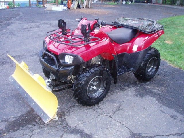

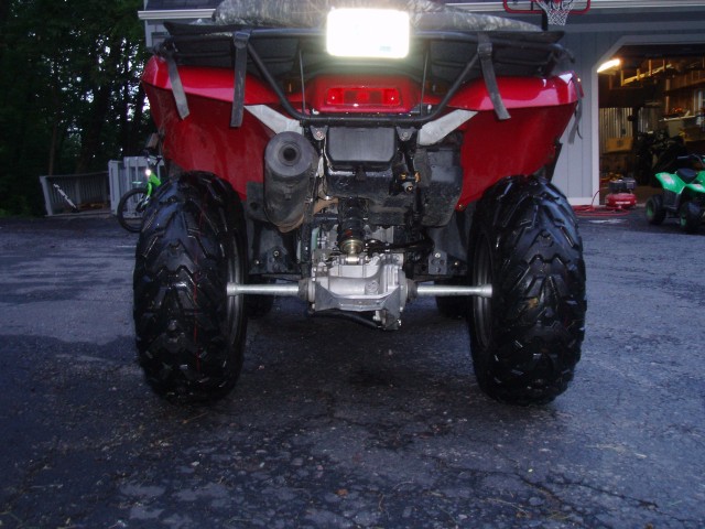

I have a Kawasaki Brute Force 650 4x4. I have to say this quad has exceeded my expectations. It can really pull its own with power to spare. I have used it for plowing and towing and have been real impressed with the machine overall. Needless to say it can climb a tree in the woods if your into trail ridding. Best of luck with your search for a new unit.
