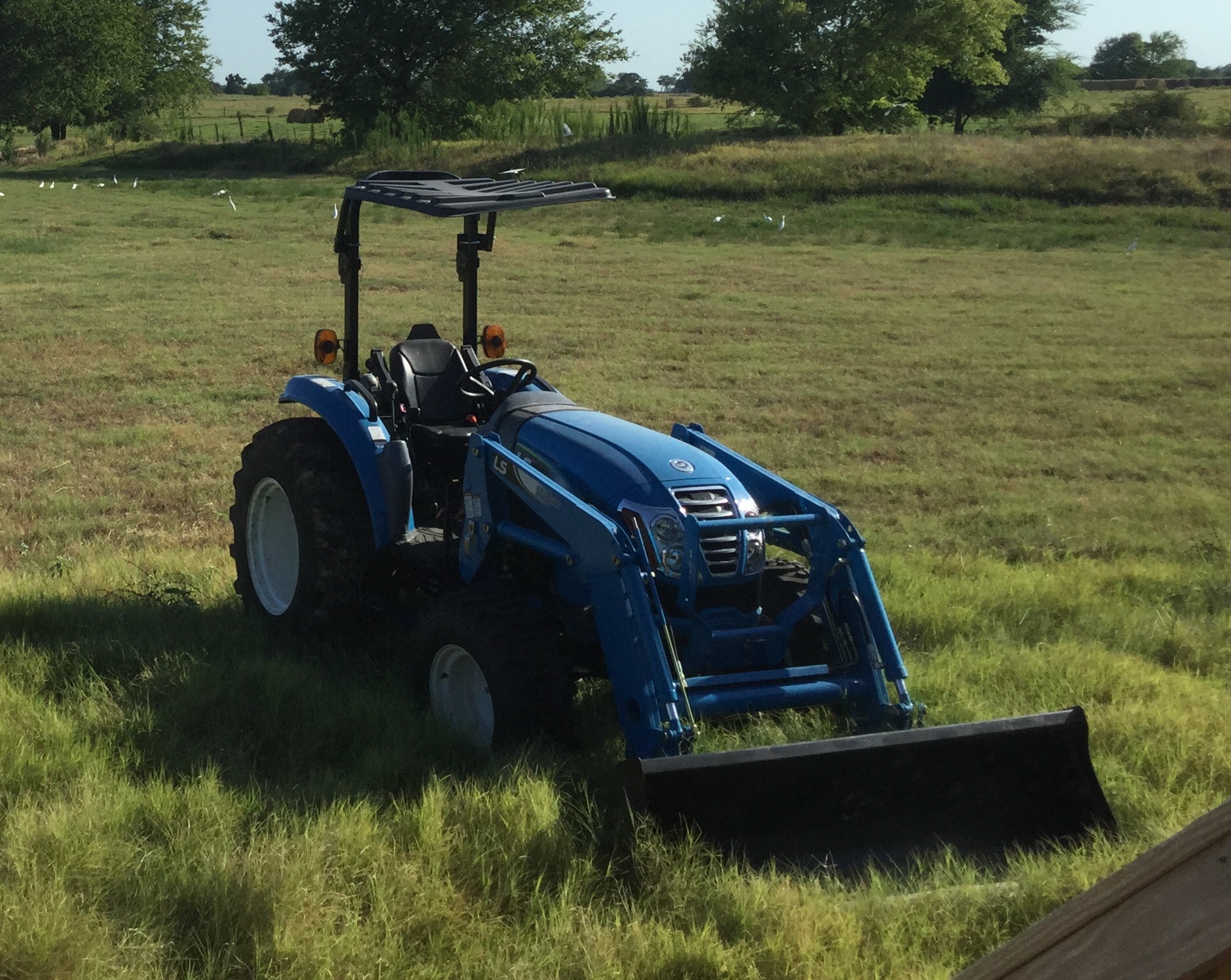

It works pretty well. You do have to drill your own holes on their brackets (at least I did on mine), so make sure everything is lined up really well and clamped or else you end up with a slightly skewed roof.

The cover does not vibrate. And even if it did, there's no way I would hear it over the tractor noise. It's pretty sturdy. The only downside is that rain water collects on mine and drops off the side when I first start moving the tractor. It splashes me a little bit. Otherwise, it's a pretty good cover.

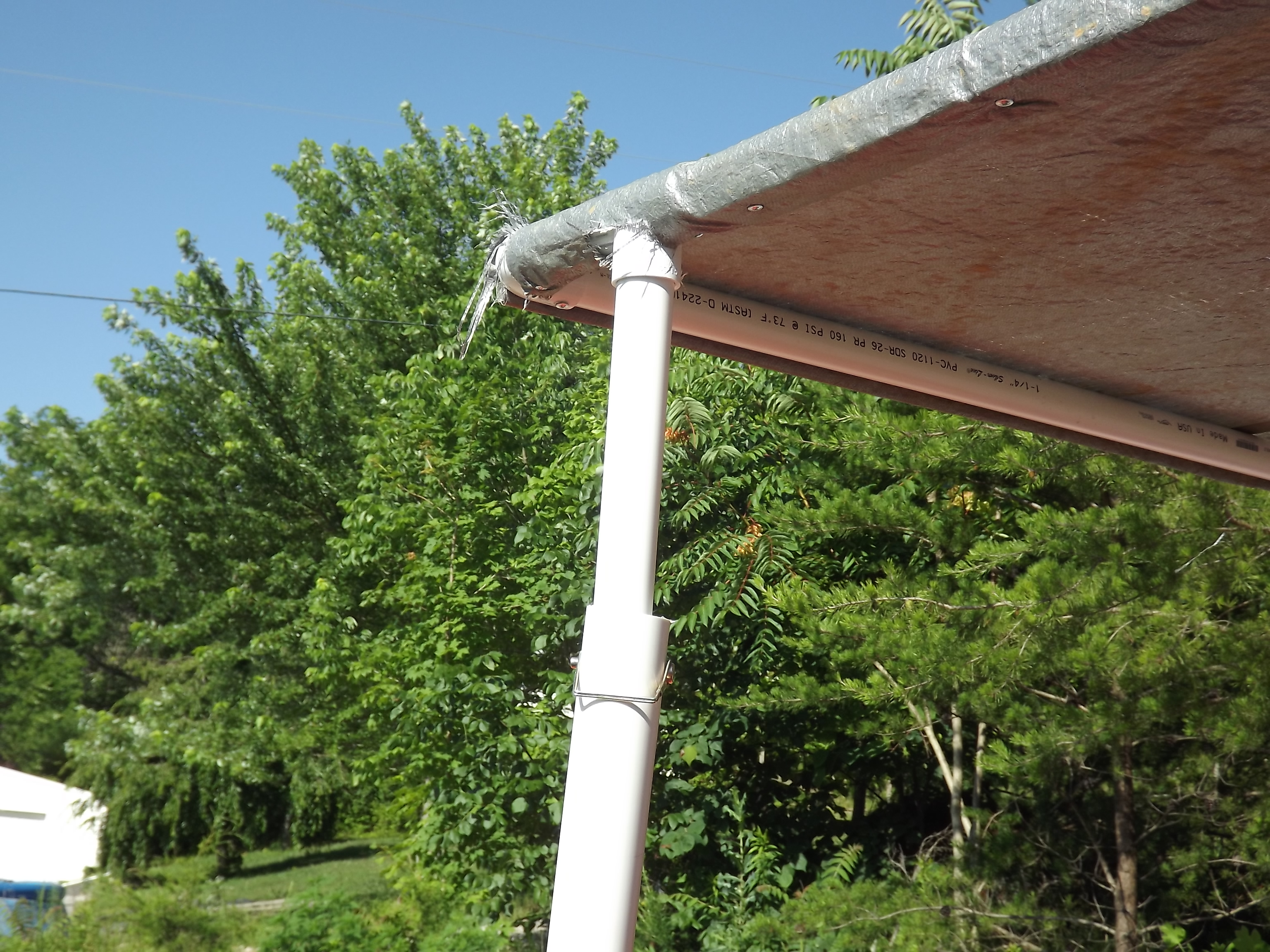

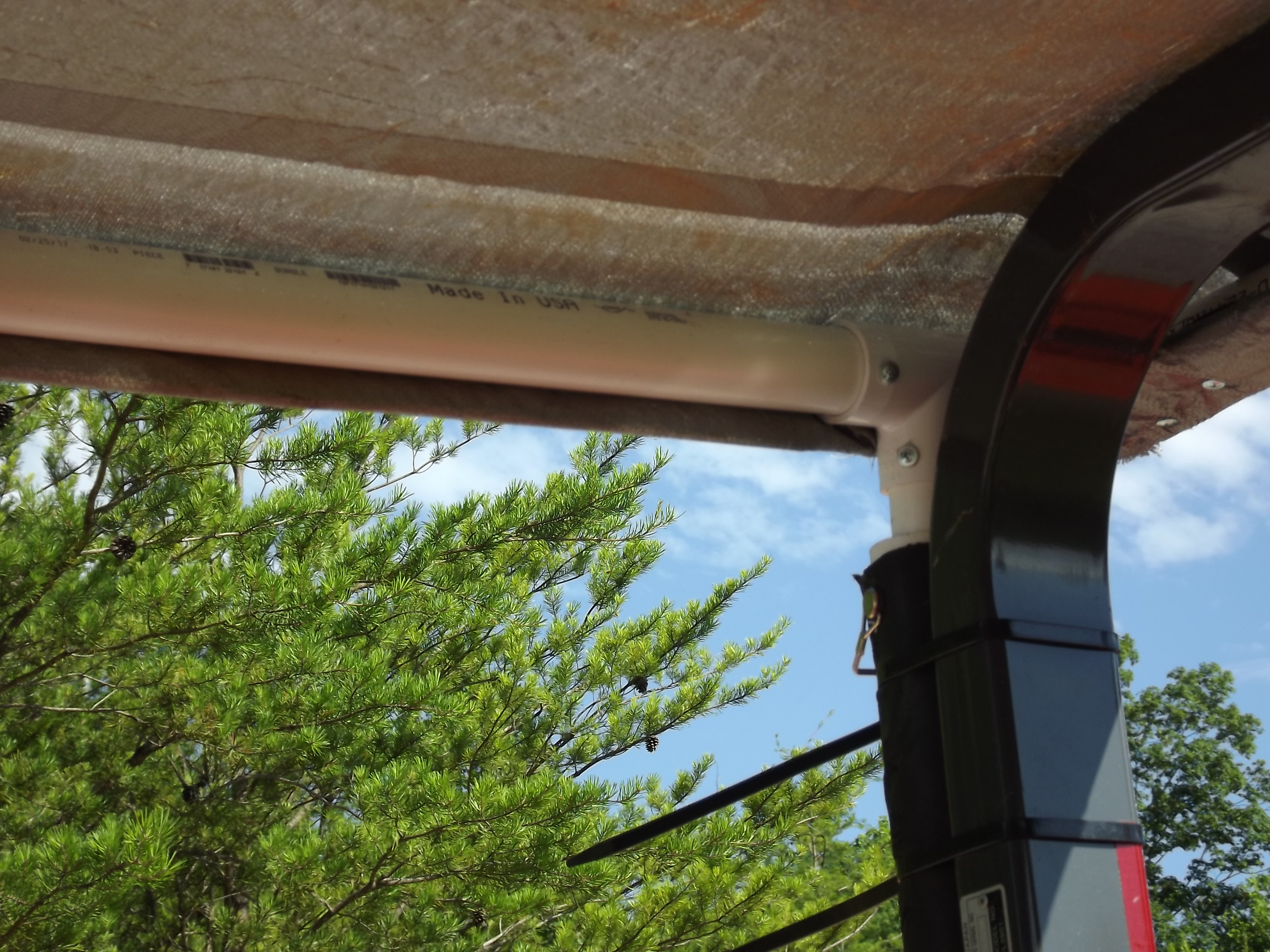

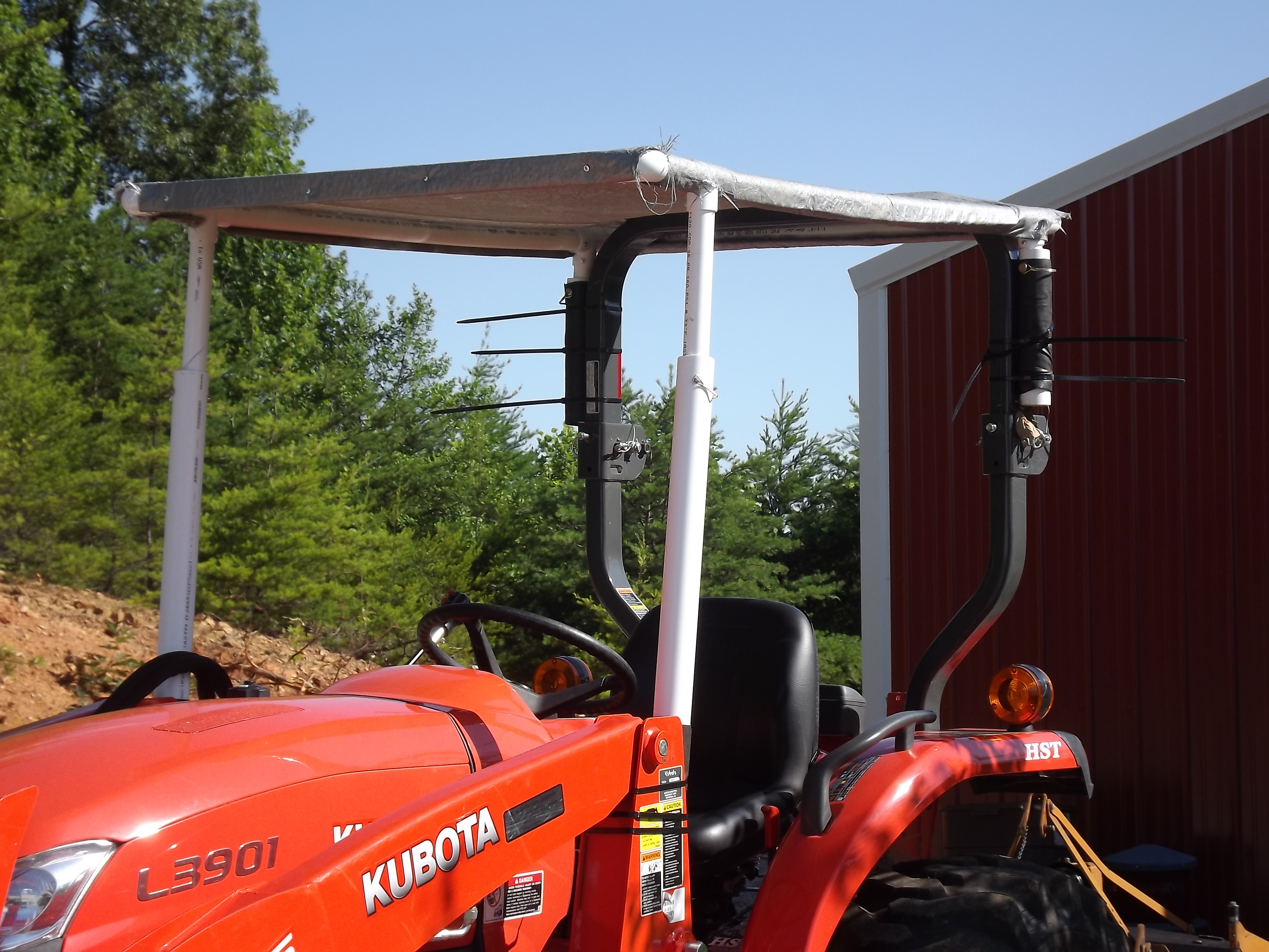

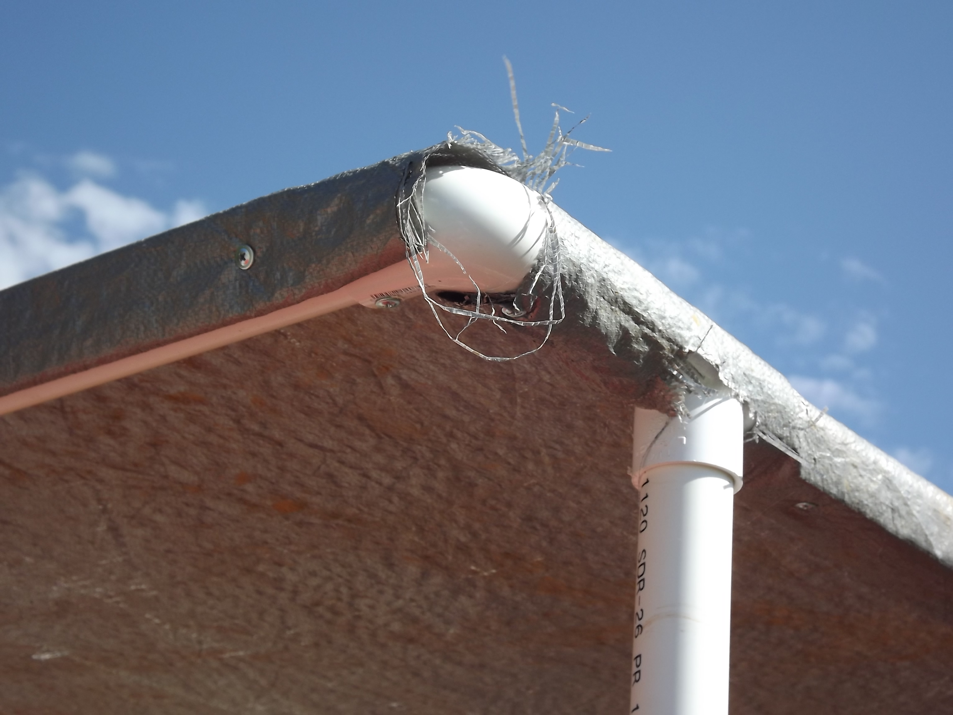

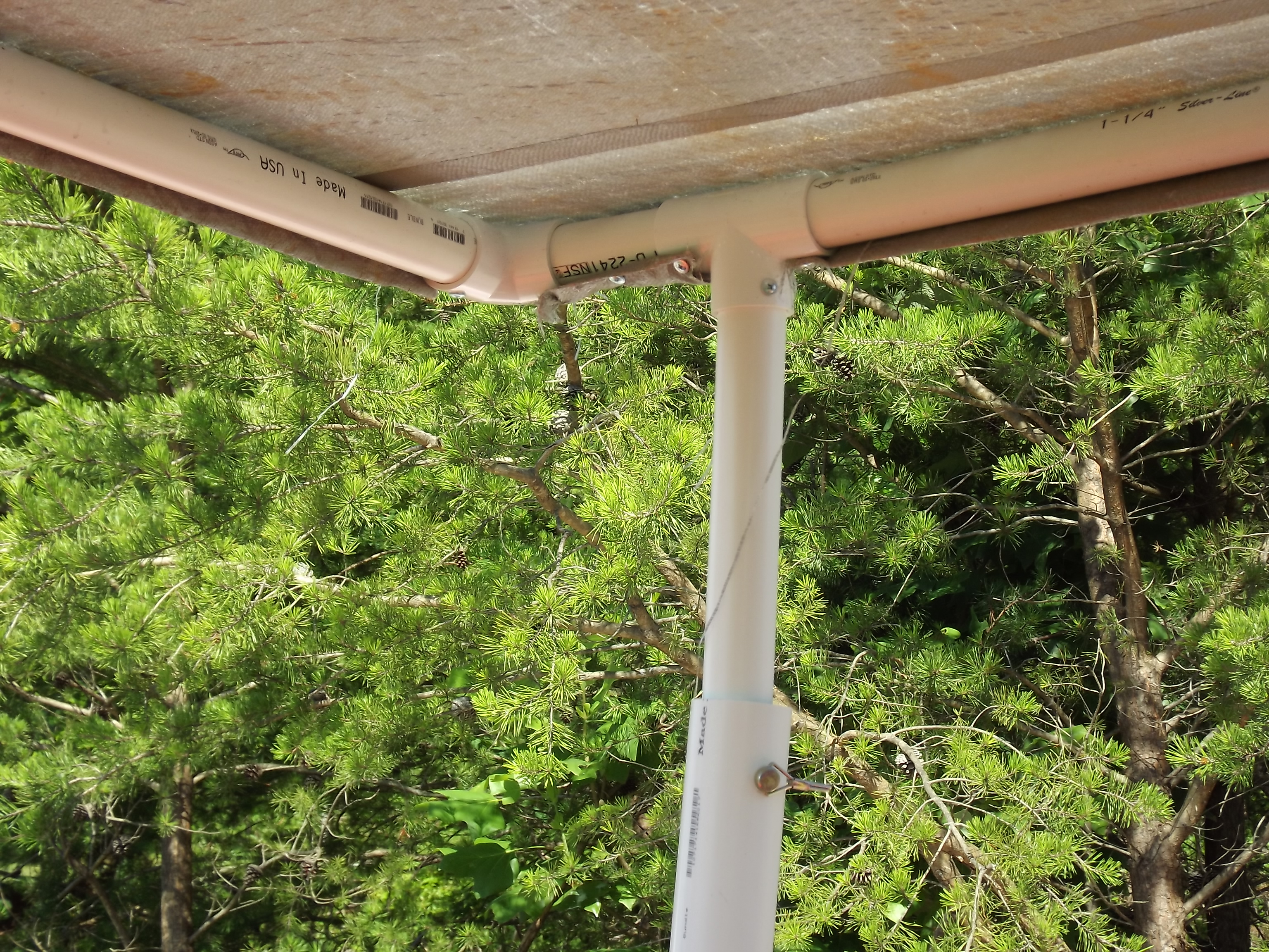

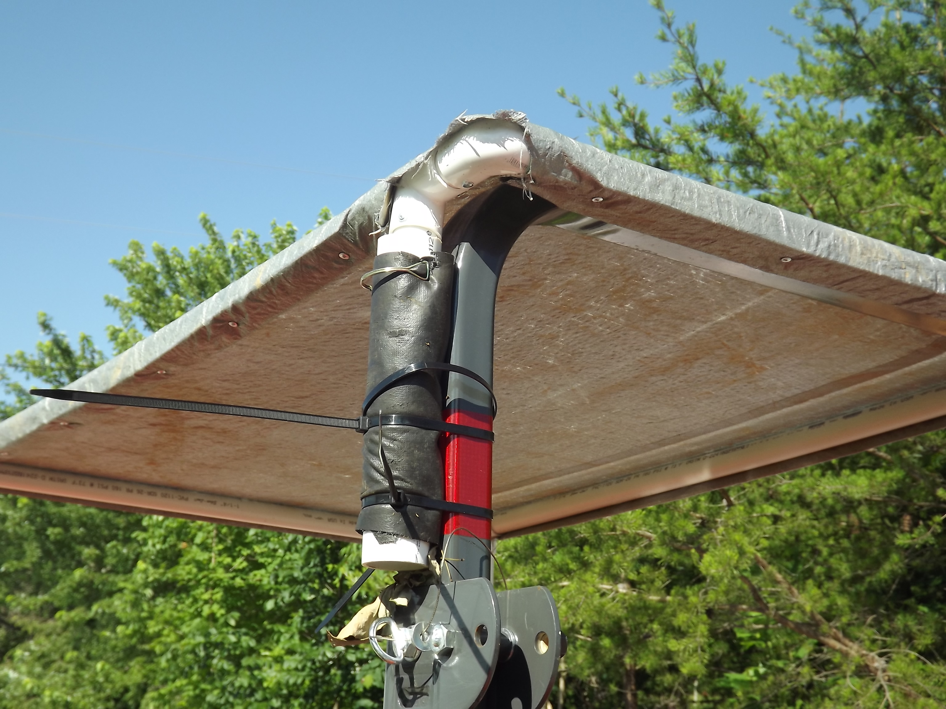

I've bought many of the fiberglas hard canopies over the years and currently have one on my F3080. Sold my Niece a small Kubota Z and had moved the canopy from a tractor to the Z and left it on it when I sold it to her. Didn't realize it's now a $400 canopy.
A few years ago I built a canopy for a F2680e with schedule 40 PVC and a canvas drop shade I bought at a yard sale in Florence, SC on my way home from vacation at NMB. I used stainless steel U clamps with two on each side. I would hit a guy wire from time to time and make it go cygoggle/crooked/off perfect alignment.

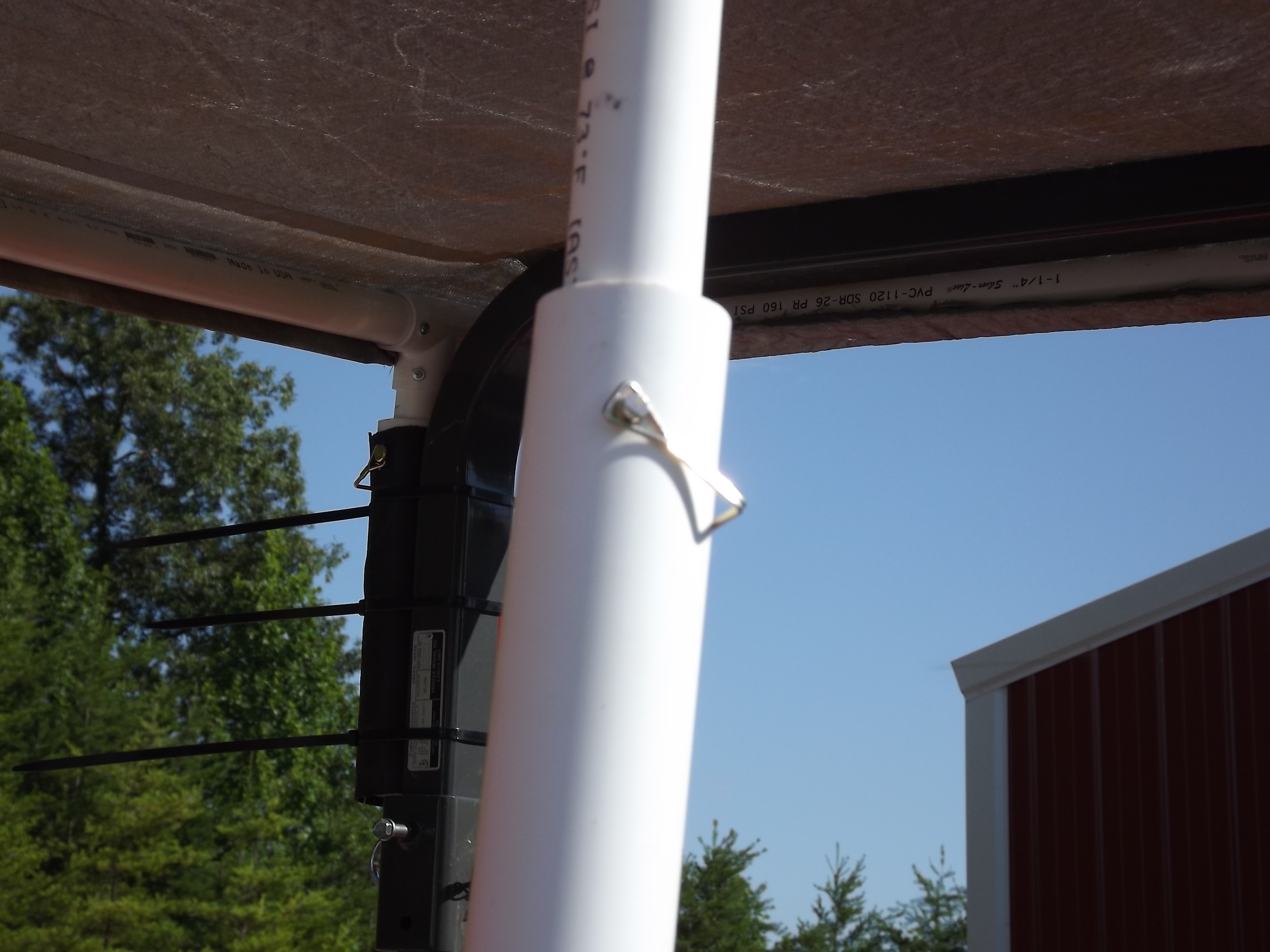

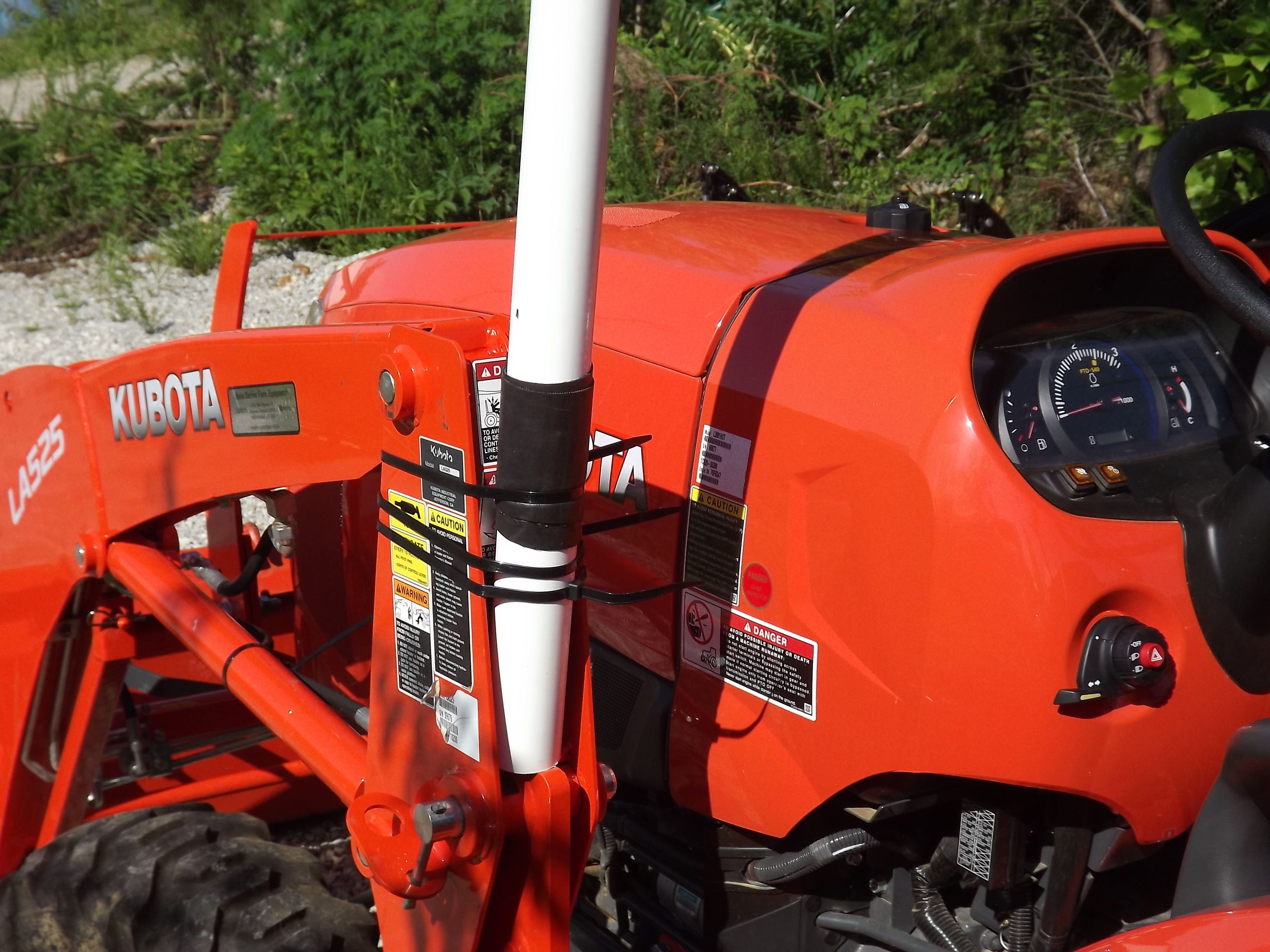

Decided I don't want to pay $400 for one I can't remove by mayself easily, don't want to order one that will feel like cheap junk for $200 or even $100. Also did the cheap junk umbrella thing some years ago. So, went to Lowe's today and bought three (3) 10' pieces of 1 1/4" schedule 40, 4 elbows and two Ts for around $25 with vet discount. Plan to build one with support going down in the front thus reason for two Ts and support arms going down ROPS thus two 90 degree angles/elbows and a bar across the front thus the reason for the two more elbows. I'll clamp the lengths down the ROPS with probably U clamps with some form of rubber between pipes and ROPS and possible will get a section of 1 1/2" to fasten to ROPS and slide the two 1 1/4" arms into it so I can just lift it out to remove top. Haven't looked at how I'll support the two front down legs into the FEL arms that different people that built their own mentioned doing. Don't think I'll really need the two front legs but want to try that to see if it works better. I'll get a silver coated tarp at Harbour Freight or find the one I've already bought a few years ago and is here somewhere. Or just see what tarps they have that will work and look OK. My wife can sew me the cover to slip over the frame with maybe velcro fasteners or I may try grommets and zip ties or small ropes. I'll have to let her decide how best to fasten top. Can even screw it thru top material and into the PVC.
my BIL has a machine shop and would/can do what I need in metal but I can do PVC myself when I want to with no waiting and PVC schedule 40 is strong, rustfree and easily modified with all kinds of pre made connections, joints, angles off the shelf.
Anyway, this is how I'm going for now but I'm flexible enough to do something different if I'm not satisfied.
Thanks for input.
   / RhinoHide Sunshade experience, anyone?

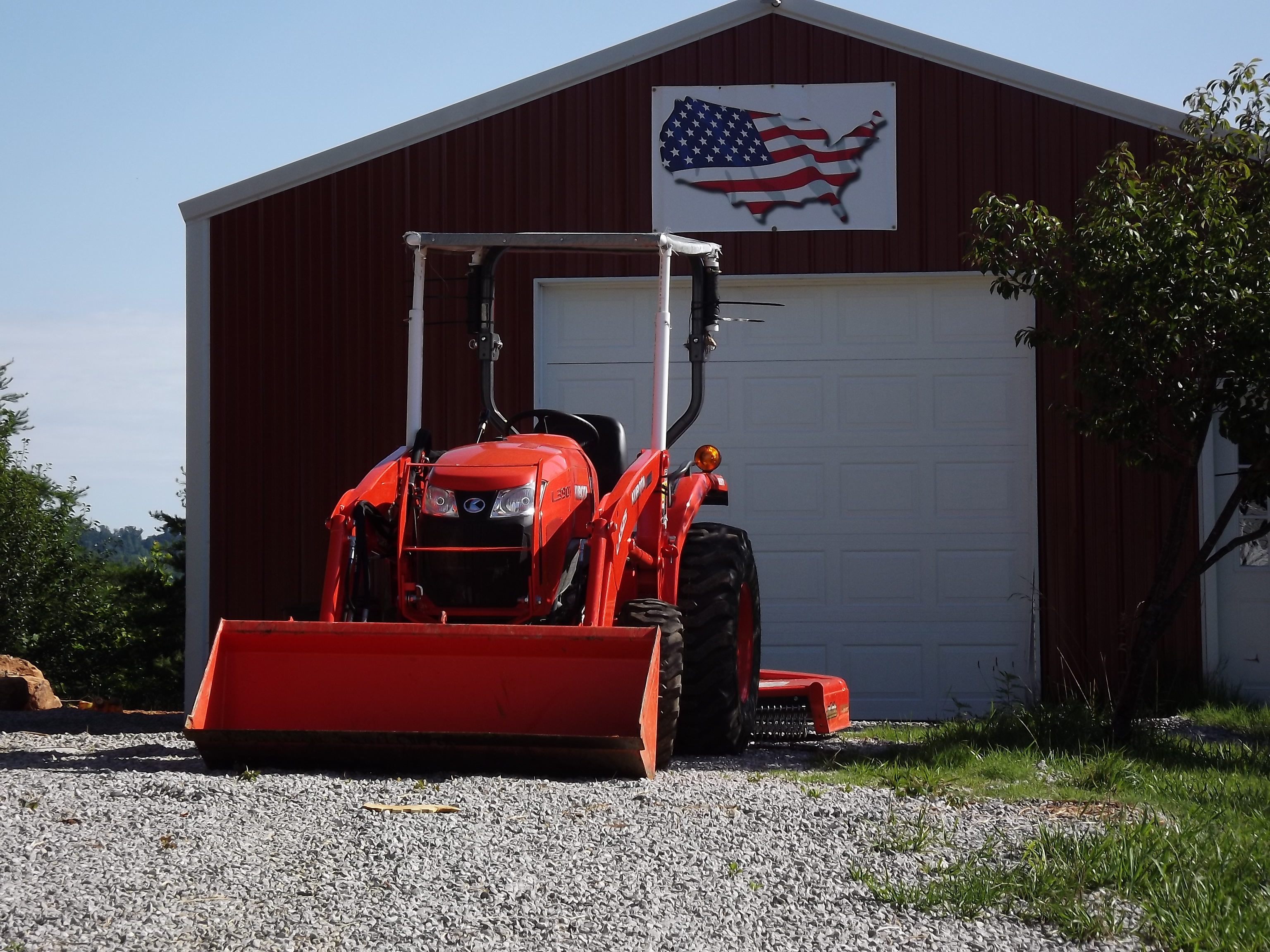

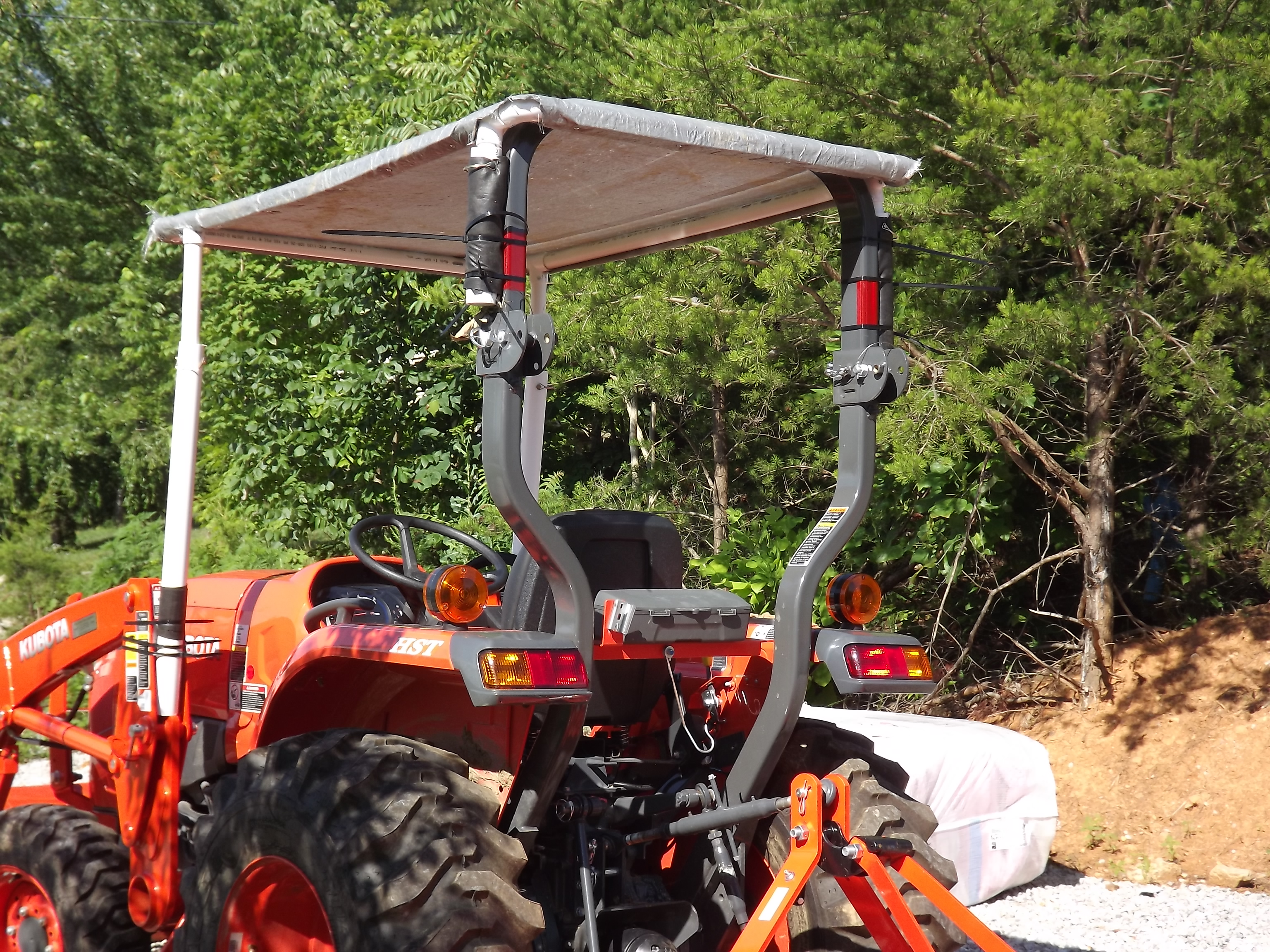

Built my own sunshade for under $50 and satisfied with my creation/work. Easy off and on by myself in a couple of minutes with little effort and no strain. I should start selling them if I get some orange tarps.:D:cool2: I think it even looks good and a few clean up details would make a more professionally finished look.
