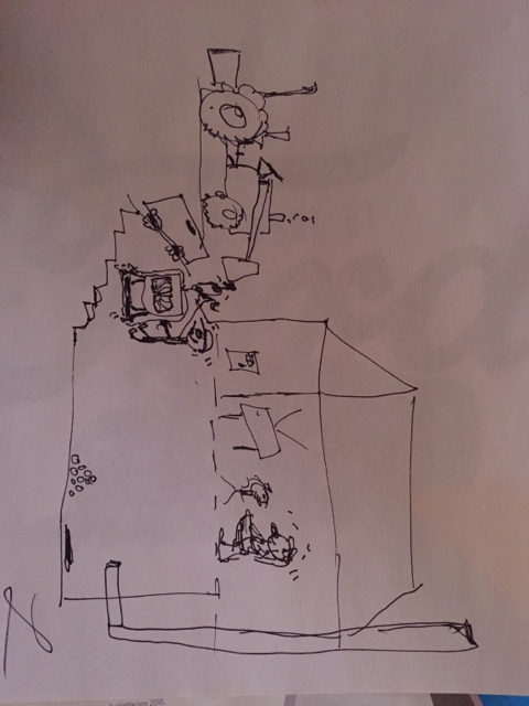

Hi Everybody. Just posted a thread about buying wood stoves. Probably will buy one, so I am wondering how I will get it into the basement. It may weigh up to 900 pounds.
Access to basement is by "dog house", door is full 36 inches wide, 8 steps. I have a Kubota B2650 with a hook welded onto the bucket. The beginning height would be the bed of my Tacoma, or ground level if I have it delivered. I know that I can lift it, but how am I going to get it down the stairs?
The bucket won't fit through the door so I can ramp the stairs. A 20 foot chain would lower it to the basement floor, but how do I secure the stove at the top of the ramp to connect the chain? What are your ideas?

A come along would be the best. If it was sucked up tight when starting between the loader and stove with the body DOWN. Then you could pull the tractor over the door, let the stove down, and then go inside and let the come along down while pulling the stove down. Course this would work better with a buddy. ImageUploadedByTapatalk1452654379.625777.jpg

A chain fall would be way better. Comealongs suck for releasing.
