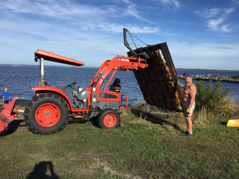

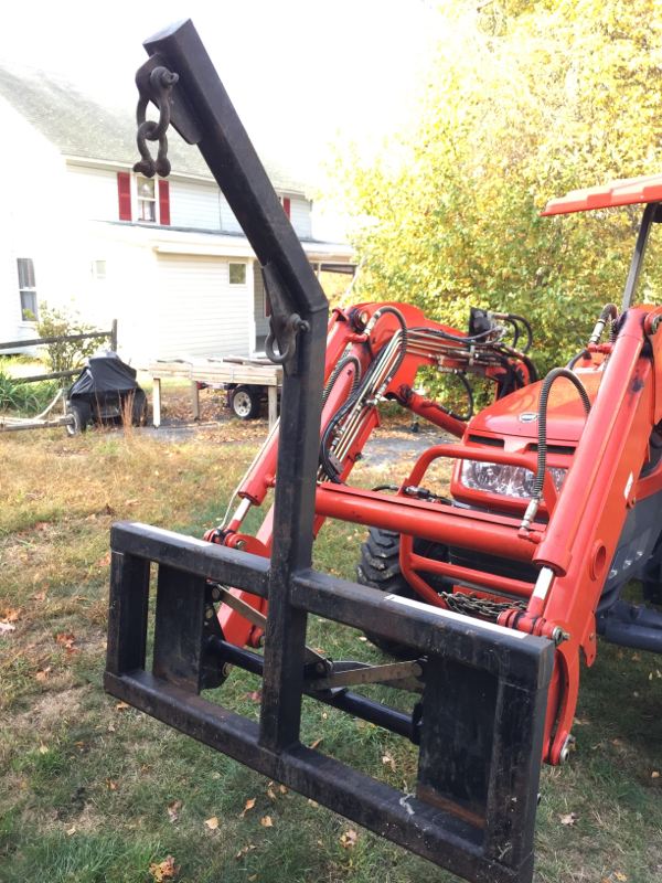

How about a tree boom? Does your tractor have SSQA? Tree booms are not terribly expensive and have multiple uses. Allows you to extend the reach of the loader, is very narrow and when "dumped" can lower something about 4 feet below grade.
I use one to lift a swimming raft up from a seawall. Your process would be the reverse.
