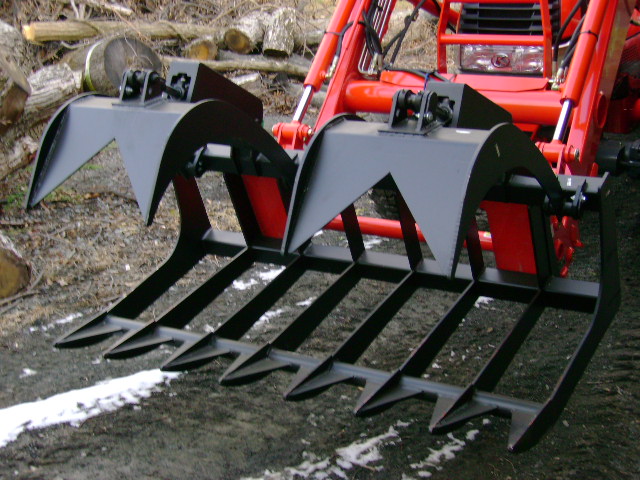

I agree with KentT. A grapple is the ticket for moving brush. I love mine.

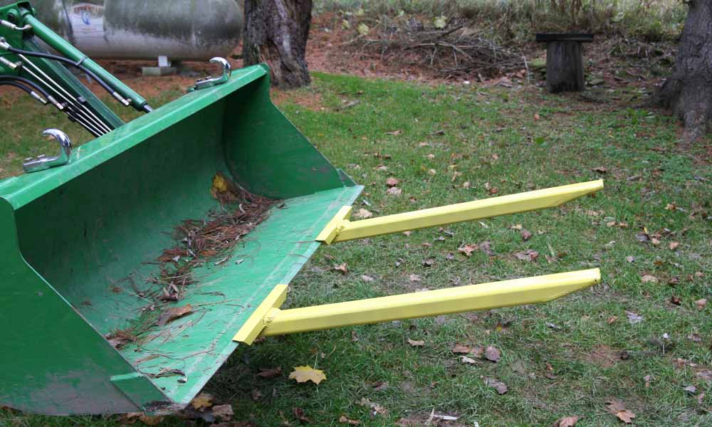

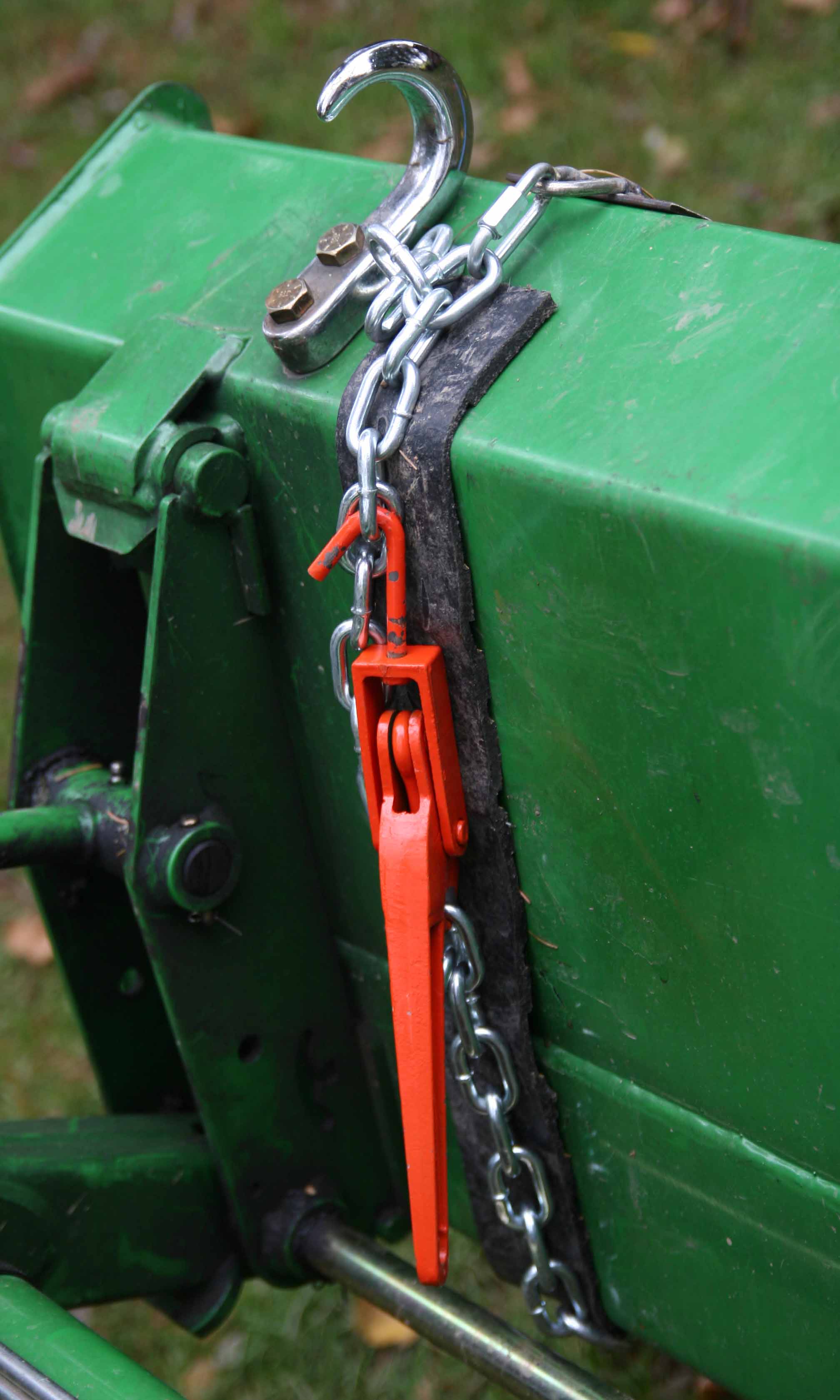

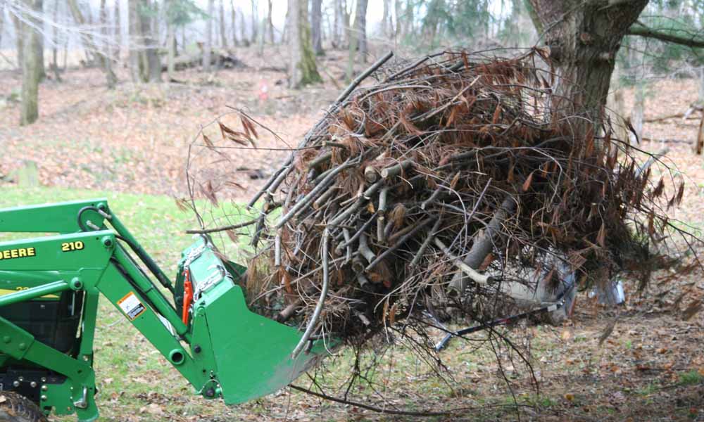

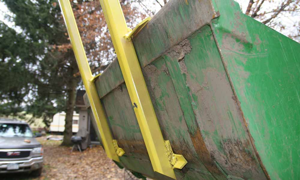

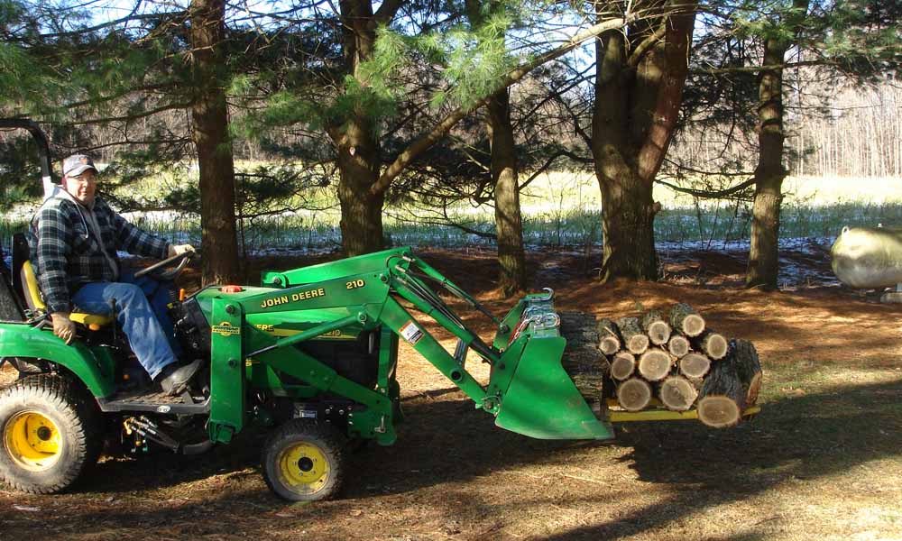

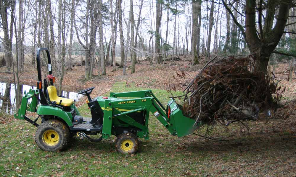

I am clearing a small amount of land...but each load is about as large as I see in other photos. A friend of mine built for me a pair of forks that fit right on the bucket and chain around the back. I've attached a couple of pics of the brush piles they are capable of picking up. They never loosen up or move around on the bucket. I've picked up loads that are as heavy as my FEL can lift and they don't bend the bucket or break. IMO this type of fork is as good and cost effective as you can have. They are made from 2" square stock. Because I have the bucket behind them, I am able to drive right into a brush pile and pick it up all at once. They also slide right under a fallen tree and pick it up to move it. Occasionally I have to cut off a part of a tree in order to balance the load...IMO this is the only place a grapple would help, but at a much larger cost. I also use them to pick up the ends of larger trees to chunk up with my chain saw. A fair night's work to build, but not too costly. Just my opinion.

   / right implement for brush removal #8
DaveK,
That certainly looks effective. I'm surprised however that a large load of brush doesn't fall out and leave a trail of debris as you travel with the load. Perhaps your load is a perfect type with nicely stacked and oriented branches. When I pick up big piles of chopped up mixed brush I need to take a big load and squeeze the grapple tight to prevent the load from falling apart and out of the grapple as I travel bouncing along.
   / right implement for brush removal #9
IslandTractor,
Yeah I do lose a little bit if the brush pile isn't ideal, but the tradeoff on cost makes it worthwhile. If I had a lot more clearing to do, I would take a hard look at a grapple setup.
