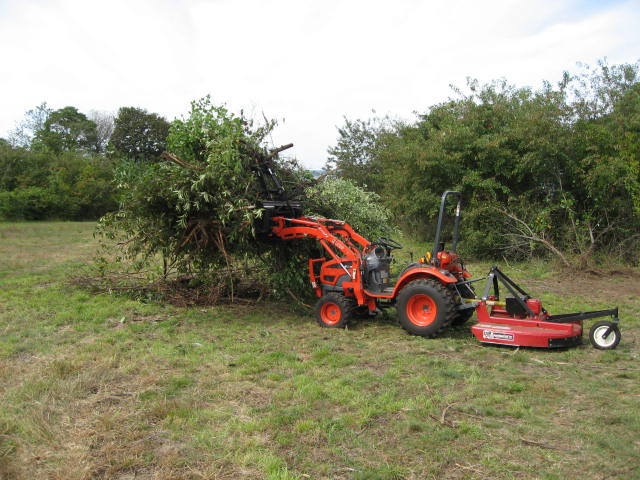

You said it Bro! For anyone with significant land clearing, you should think of a grapple right after you get your bush hog home.
One of the nice things about grapples is that even smaller tractors can do essentially the same job as 50+hp tractors moving brush. 21hp tractor with a $700 grapple works pretty much as efficiently as the big guys.;)

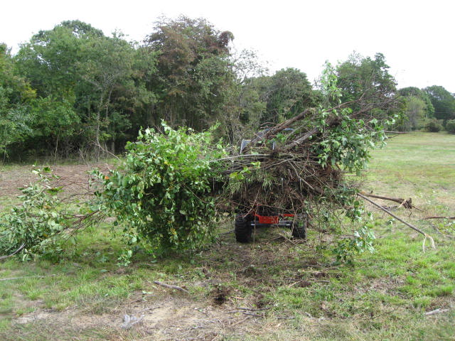

I'd have to unfortunately agree with you there Ed. You make it difficult for me to justify my big machine. Sometimes your pictures look like the brush pile is carrying the tractor!!;)

Uh, do you tow anything bigger than a 48" bush hog or 60" finish mower?:D
Point is that for the brush clean up duties the smaller machines are perfectly adequate. My point was not to dis your monster machine but to clarify that owners of small tractors can get great results by adding an inexpensive light duty grapple.:cool:

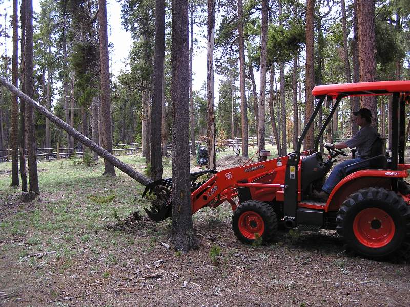

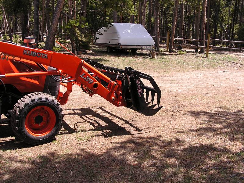

The Anbo rake/grapple for our Kubota L39TLB works excellent for many different jobs. You can use it to rake up a bundle of brush and then grab it and deposit it elsewhere. Dirt will fall out between the tines which are spaced 6 inches apart and are offset top and bottom. It will be one of our most used attachments for the L39.
Pulling a tree snag down by grabbing the root ball and slowly backing up and letting it slide down another tree.

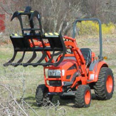

Millonzi Light Duty 48" grapple. Mine is QA but it can be ordered with tractor FEL specific pin ears too for about $150 extra I think. Millonzi advertizes on TBN and you can reach Joe Millonzi via PM using his TBN handle Joe@MI
I've used mine for over a year now and remain impressed that this grapple would be a great match for any tractor with an FEL that can lift at least 800-900lbs at pivot points. Although there are many much more expensive grapples, I have yet to see a situation where mine little combo could not do essentially the same job. Grapples are not like bush hogs where there is a clear advantage to bigger. You can rarely pack a grapple with more material than the FEL can lift and because brush sticks together a smaller grapple can snag just about as much as a much bigger grapple.

I would suggest you consider why you need a 66" dual jaw grapple as you can get the LD48 for much less money, it will leave you with more lift reserve as it weighs only 280lbs, and, in my experience over the past year, there has not been a single time I wished I had two jaws. You may have perfectly good reasons for wanting the wider dual jaw grapple but just don't make the mistake of thinking you need to match your bucket size.
