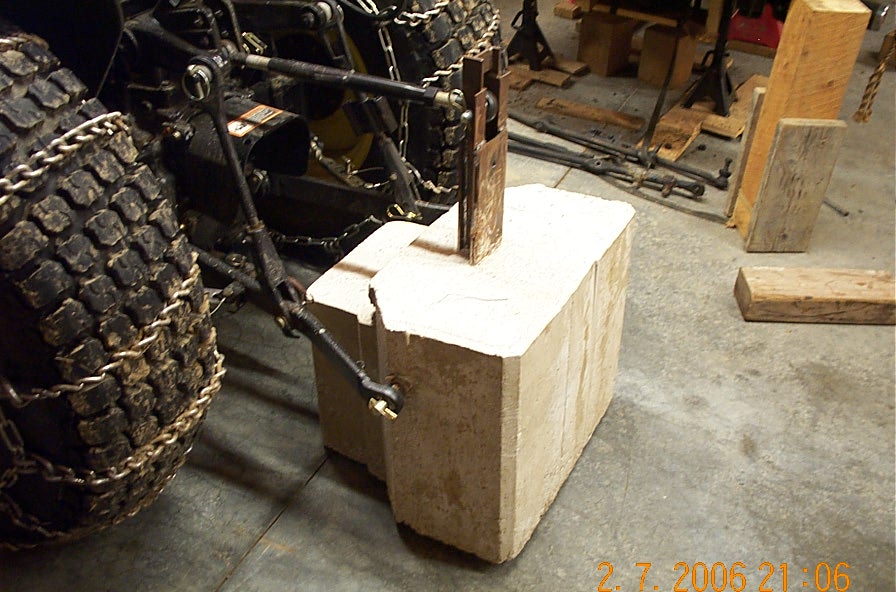

I also wouldn't lose the benefit of ballasted tires. My 3320 has loaded tires plus I built a weight block that I figure is around 500 pounds. See attached those extra pounds might come in handy some day when you have a good load in your bucket and you aren't exactly level!

OH, by the way Red Horse, that is a very nice ballast you got there !!! :thumbsup:
