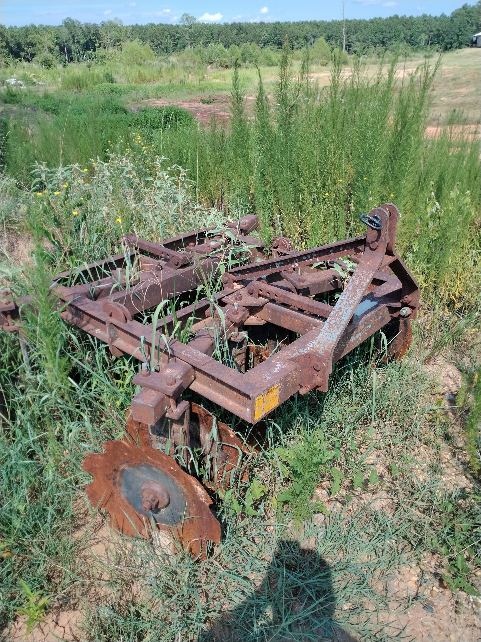

Just get one that is heavy made. This one is a Ford. Tuffline is made like it. There's a few brands.
The OP's JD 4410 weighs 2,900 pounds. It is probable his 2,900 pound Deere can only pull a light, box-frame Disk with 18" diameter pans, 60" wide (~52" operating width) pans spaced 9" and still be able to use the Disk's three (3) or four (4) gang angle adjustments. You can smooth with an implement weight of ~37 pounds bearing on each pan. To cut/penetrate could require twelve (12) or more tractor passes over the field, NOT GOOD FOR CLAY.
If the OP's tractor has loaded rear tires and R1/ag tires it might, MIGHT pull a Disk with 20" diameter pans, 9" pan spacing, 60" wide, NOT set at the most aggressive gang angle adjustment. To cut/penetrate in 1-2-3 passes requires ~50 pounds implement weight on each pan, which is a minimum of 20" diameter pans, spaced 9".
