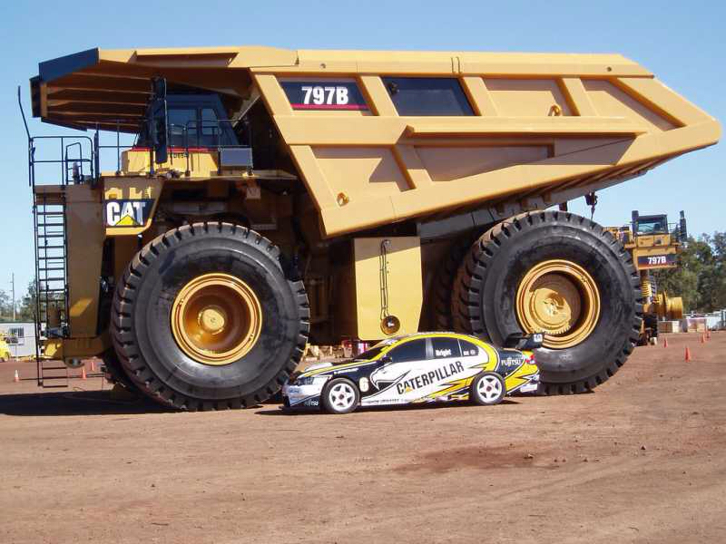

The 797B runs 87 pounds of air in their tires. We targeted 400 tons a load on them. My F250 requires 70 pounds.
   / rim guard and proper inflation #29
Now that is alot of foot print there.
   / rim guard and proper inflation #30
so...... you can load over 300 tons on it???:confused3:
Well as long as the aluminum does not deform :D
