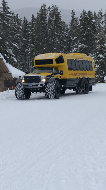

This truck runs 8 psi. A F-650 with regular tires probably runs 80-100 psi. IMG_8735.JPG
   / rim guard and proper inflation #59
   / rim guard and proper inflation #60
Yep. I used a Big A as an example. :)
I bet the F-650 with regular tires rolls on firm ground with less friction though.
