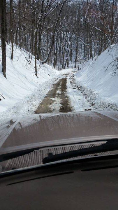

It's the 6 footer, depends on job, can pull it with BX, B or ford 4000. Has 40 gal of hydro oil in drum as rust retardant. Some wet early springs I pop BX into 4wd and mow thru standing water, yes it makes ruts. 3-5 days later I can roll lawn.
When I use it neighbors get their 2wd turf tired lawn tractors out, fill their rollers and get stuck in the first soft spot they encounter.
2 problems, isn't 3pt can't lift it off the ground if meeting neighbor on 1 lane hill. Impossible to back uphill. Roller follows existing contours, destroys a crowned 1 lane road.
