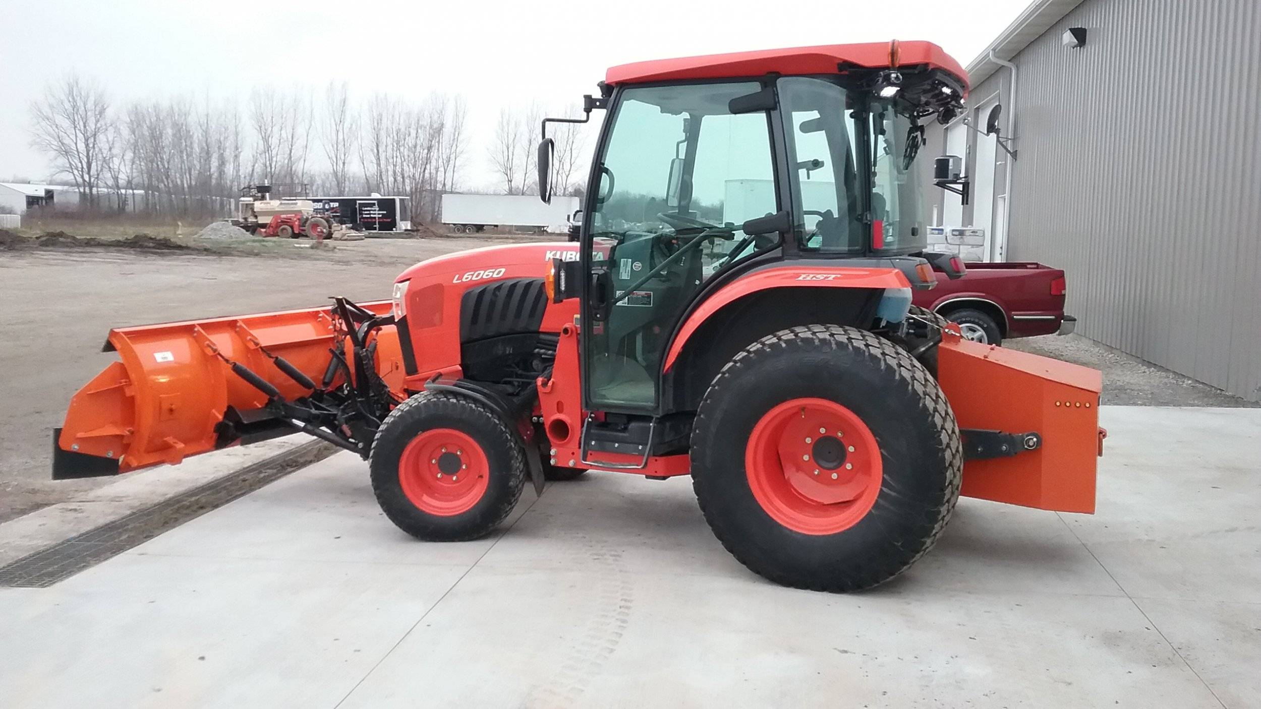

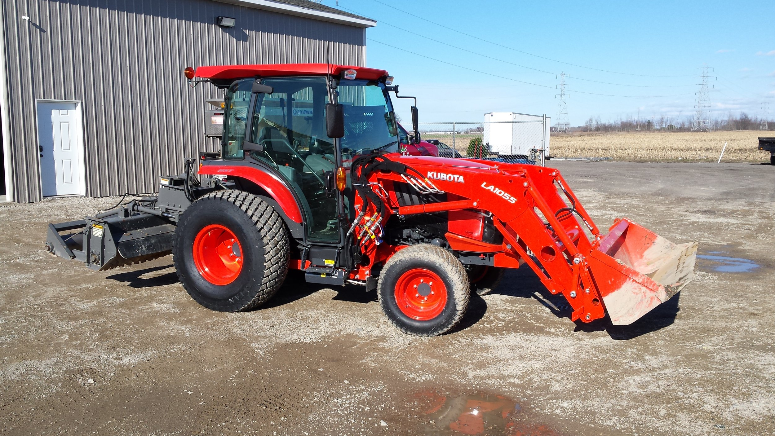

So, i figured i'd show the 2 most common ways my work machine is set up to detail how different applications may warrant different ballast.
For summer use I have no fluid in any of the tires to help minimize ruts on soft ground. Since I always have a 3pt implement that is at least 1000lbs and that sits close to the ground, i dont have to worry about heavy loads out front or slopes. Ive moved 2200lb pallets of paver blocks in a pinch without issue.... other than the weak ass steering.
For winter use i have all 4 tires fully loaded as well as a 1000lb weight box that i built to be tucked in as close to the tractor as possible. Its actually heavier in front of the 3pt links than behind. I specifically went this route because i plow some very populated areas like a news station, dialysis center, ambulance depot, etc. and wanted to keep the footprint as small as possible and minimize transferring weight off of the front. Total weight of the whole rig ends up over 7000lbs despite being very compact and that makes it very stable and comfortable to operate.
I guess the TLDR is that everyone uses their tractor differently and will have a different optimal setup for their specific applications.
