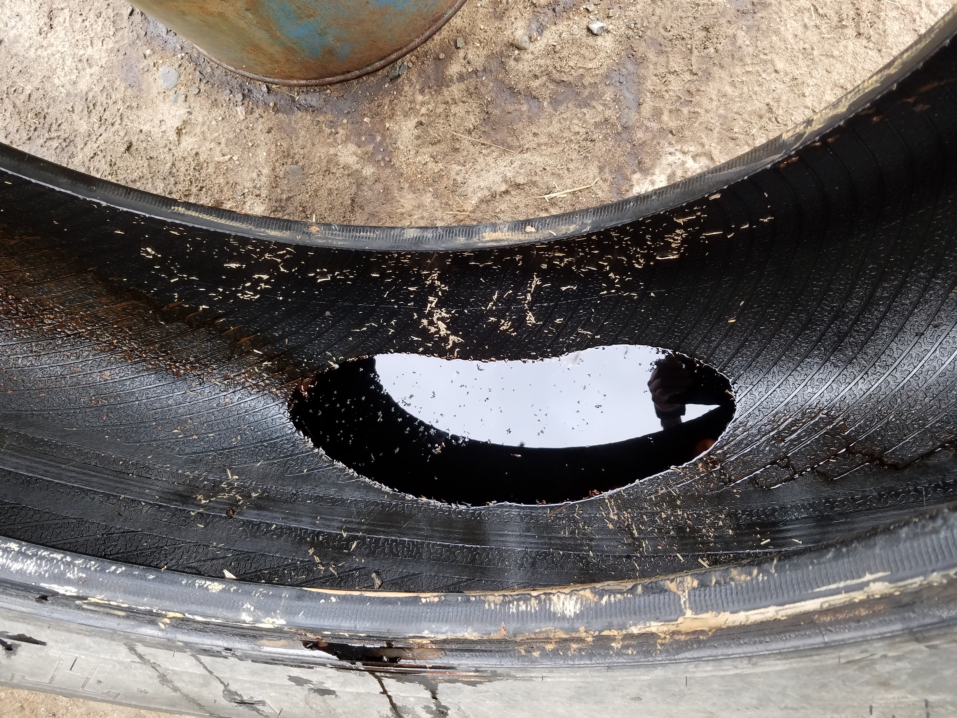

Dropped by my nephew's this morning and saw this tractor tire being repaired. I recognized the Rim Guard right away but was surprised by the rim rust (thought Rim Guard was supposed to prevent that) and the sticky mess. Rust is just superficial, but they said this has been the most miserable tire repair ever (and they repair many every year). When I left they were pressure washing everything in preparation for installing a tube. The tractor is 6 years old I believe - he bought it used 3 years ago. Tires are Titan radials, made in Des Moines, have good tread remaining but are cracking. Leak was not from a puncture - it was just oozing through the inner carcass and an exterior crack. I believe he has 14 tractors ranging in age from ancient to 2 years but this is the first time he ran across anything like this - it is his first experience with Rim Guard. He said the dealer told him it was the original buyer's request. Is this typical?
/ Rim Guard #2
Looks like the rim guard may have attacked the paint but not the metal. Not sure how typical but if it was calcium chloride I'm sure the rust would be much worse

Prior to retiring, I was responsible for product Support of several thousand machines produced in the construction equipment industry. Tires were factory filled with calcium chloride. During all my years I had zero complaints of rim damage. No tubes - Titan was our wheel supplier and they said at most we would see a rust scale develop until the free oxygen was depleted. There was little free oxygen because we inflated with nitrogen. Tubes, however, cause problems. Salt water escapes, possibly during pressure check, and starts rusting around the valve stem. This rust progresses until the rim is shot. Due to manufacturing in several countries, I inspected dozens of rims after test tires were dismounted and never saw any significant rust let alone this severe stripping of paint from the rim. I will be visiting my dealer next week, will show him these pictures, and ask if this is atypical of Rim Guard.

MHARRYE, do you have any update, what did your dealer say. I think there are so many products out their that companies market that never hold up to their claims. That rim does have rust on it. Most products fail after many many years and we just don't know about it because they are hidden from our sight and once they are discovered most people don't bother to warn others. The best thing you could do is send pictures to the company who manufactures rim guard and post what their response is. Most these companies will dispute a claim because you can't prove what the rim looked like before you inserted the rim guard, and that's how they get to protect their claims how well their product worked, I had another thought, if the tires was not filled over the entire rim the top portion of the rim would be exposed to air and moisture and maybe that's how the rim started rusting,

No discussion with dealer. Removed the Rim Guard (did ask the dealer what they were filled with) com the other tire to maintain balance, tuned both, and put back in the field. After all the hype that Rim Guard is the ultimate, I had to post this picture. Note there is no significant damage to the rim, only surface rust. I don't know if the problem was poor paint quality at the rim supplier or something else.

I read this post and called the company selling rimguard just prior to getting my tires filled with rimguard because I was curious what they would say, so this thread was brought to their attention, the company told me that there are many variables and different situations, and he named a few of the obvious ones, tires filled previously with calcium chloride and a few others, but the company said they stood by their claims. So that was my personal phone conversation I had with rimguard, and I did fill my tires with rimguard and my tractor is brand new, so I will keep you updated on the condition of my rims ten years from now.
