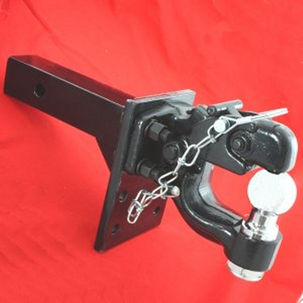

For those who have run a ring and pintle hitch trailer, does the trailer bounce around and make a lot of clunking and clanking noise when towing either with a load or empty? Seems to me there is a lot of slop in that arrangement, much more so than with a traditional ball hitch. A ball hitch trailer can be a noisy thing going down the road empty, not so much when loaded though.
/ Ring & pintle hitch question #2
Pintle hitches are made for rough, off pavement, uneven terrain and slow going. They are not intended for highway use which ball hitches are designed for. That said there are combination pintle and ball hitches. 203075-2.jpg I have something like this on my off road truck. When towing with the ball and a matching ball hitch it is no worse than a regular ball hitch.
Often most of the rattle and noise is in the receiver and not the hitch itself.

I have a few military trailers with pintle hitches. If you're towing them with the setup above, which is a combination hitch, then they are a bit sloppy, and with a lightly loaded trailer, you'll get some commotion out of the hitch if the going gets rough, particularly if the trailer is empty. If I use an actual pintle hitch instead of the combo, there is little noise or detectable slop, even though there's obviously more than a ball... Once you load the trailer, the tongue weight keeps it quiet, for the most part. At least when towing down the road.
The plus of a ball hitch is that it's relatively quiet even when the trailer is empty, with little tongue weight.
The plus of the pintle is that it will handle quite a bit more tongue weight, it's less fussy to hook up, and as I see it, your trailer is less likely to disappear, or get borrowed all the time. :)

BTW, A ball hitch should not be making much noise at all if properly adjusted, but often the insert fits loosely in the receiver and makes for some noise with an empty trailer. This is particularly true on unibody vehicles, where the hitch bolts to the body, and all that sheet metal acts like a speaker to amplify the rattle...
Loaded, you should always have enough tongue weight that you'll hear little noise with any hitch type...
