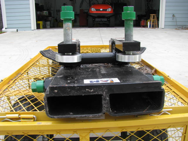

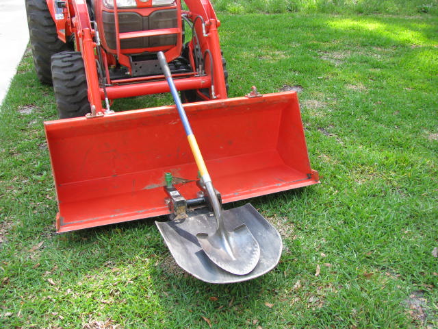

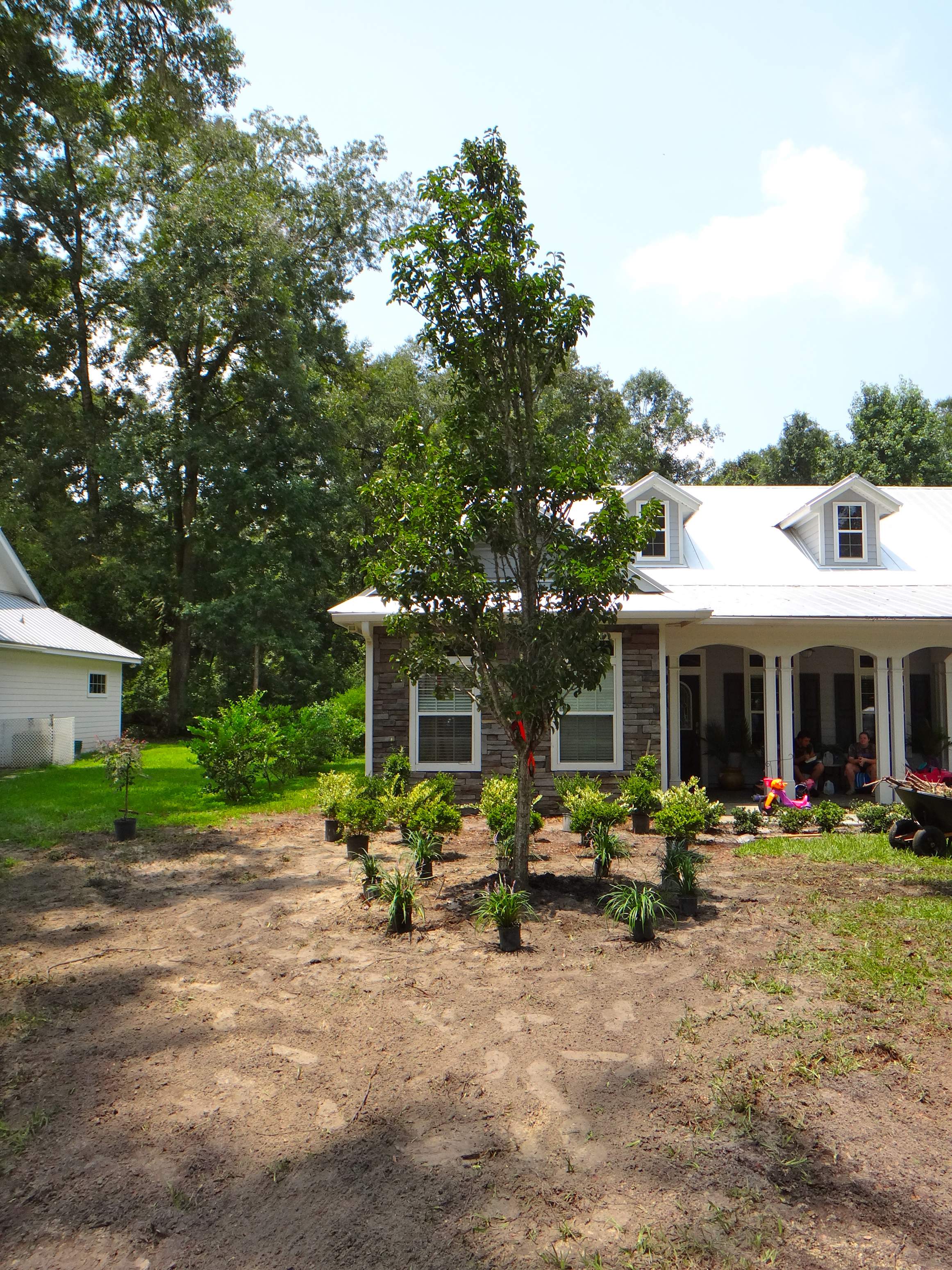

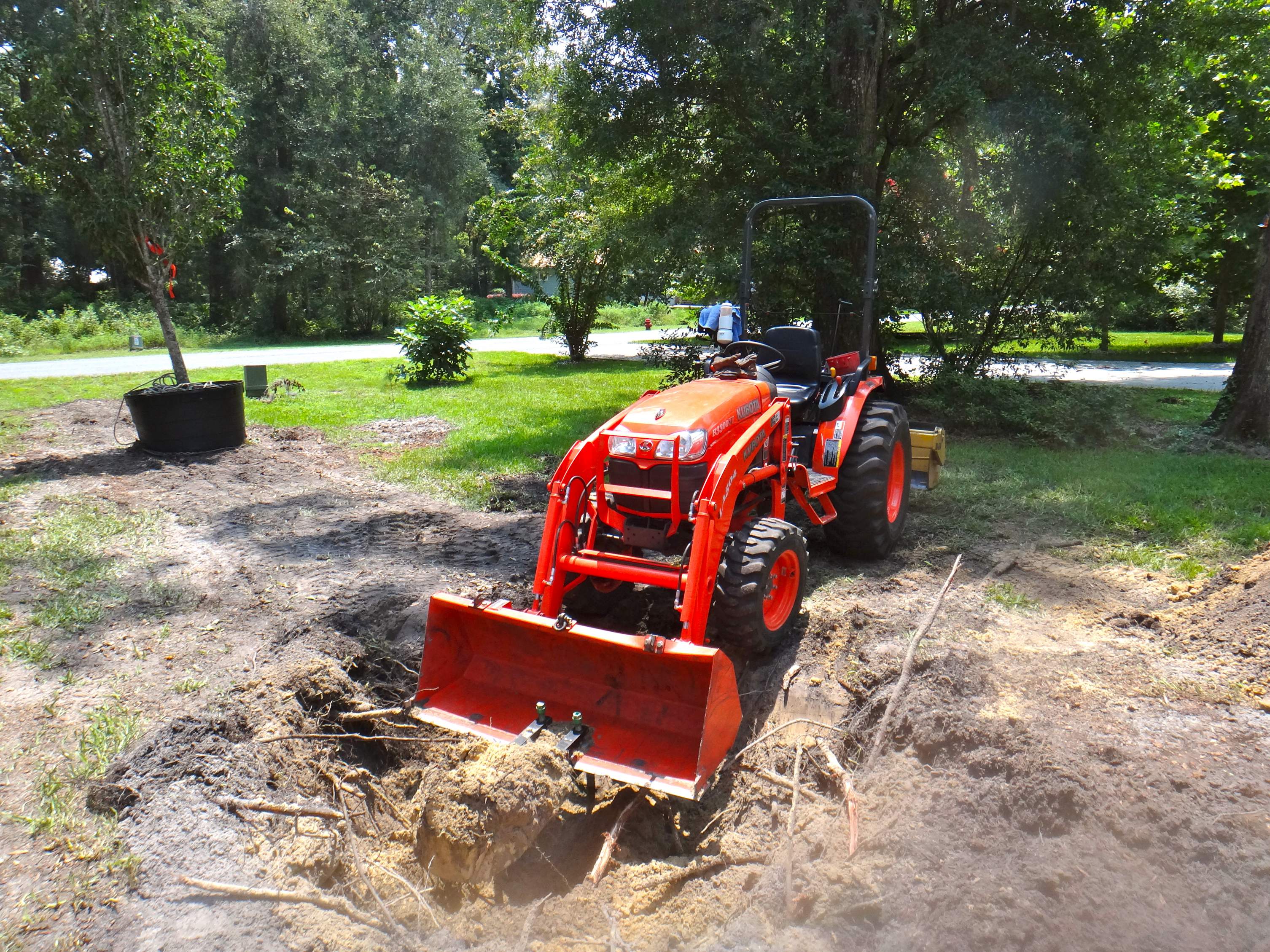

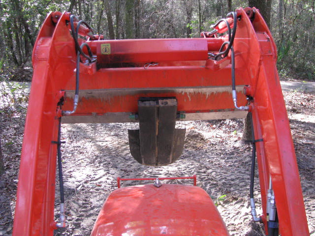

Below are a few photos of my Bucket Spade.
Mine is from Bucket Solutions. It clamps on the bucket using a wrench but also has female receptacles for pallet forks on the back.
Tractor and Skidsteer bucket spade shovel
From reading this thread it seems Rip & Dig would be better for trenching, a Bucket Spade possibly better for tree planting and large hole excavation. ( ?? )
I do not recommend Bucket Spade to anyone with an FEL equipped tractor loader lighter than my B3300SU at 1,900 pounds. It would excel on a tractor loader with a weight of 2,500+ pounds.

I do like that you can dig deeper with the fork mounted shovel.
I like the bucket teeth on the Rip and Dig. I can work it front and back to loosen hard clay in the hole or ditch.
They are both good tools.
   / Rip and Dig FEL Accessory - Review #18
Agree. The ripper does look useful too especially if you are taking out lots of saplings with a smaller tractor. Rip roots on one side and then push it over more easily. Probably not that much benefit for a bigger tractor which could push over the sapling without ripping. I doubt (but have obviously never tried) the ripper thingie would be very efficient or work at all with bigger trees. For bushes and saplings it seems to me it would be great.
One benefit of the forks mounted version is that you can have a standard bucket with a toothbar. I don't think these bucket spades can be mounted on buckets with bolt on toothbars. On the other hand, having the rip and dig spade obviates some of the need for a toothbar.

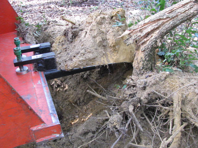

I made a wicked 'tooth' using a front axle from my old pickup,
Fabricated the attachment similar to clamp on forks only much more HD.
The 'tooth' is about 16" beyond the bucket lip. Works great to pluck stones and rip out roots.
While narrower (only 1 1/4" diam) it sure tears up a slit in a hurry and plucks rocks real time.
Cost was my time and 1 doz welding rods + scrap on hand.
