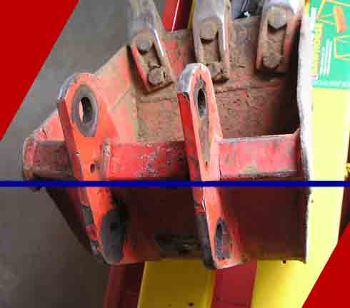

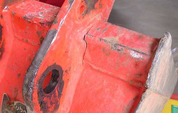

Don't think any items such as this,will have a weld failure due to splatter or a normal arc strike,also don't think on an item like this convexity or concavity[normal amount of either] will either.Codes allow both to a certain amount.
Most welding codes allow some undercut,[1/32],and again,don't think 1/32 or even 1/16 would cause this.
Now,lack of fusion,yes,lack of penatration,yes.
I will disagree since the weld appears to be intact and the crack started at the toe of the weld and not within the throat area, therefore I believe it was undercut that initiated the crack.
   / RIPPED MY HOE BUCKET OPEN LIKE A BEER CAN TAB!! #52
the failure looks to be in the weld heat affect zone, as mentioned before. it looks like the weld ripped out where it joins the metal. One thing that can do this is lack of preheat. A small defect at a point like this can grow, hope all goes well on the repair

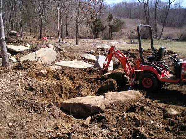

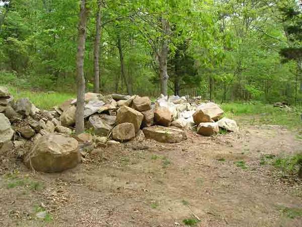

I have also destroyed my backhoe bucket but it is not Kubotas fault it is from abuse my land has more rocks than dirt my tractor has been used to remove dozens of large rocks and tree stumps most of which were too large for my little tractor.
I noticed the the bucket had started to bend but did not see any cracks then I noticed it was distorted and cracks appeared it looks like metal fatigue that square tube is pretty thin the sides bent in so I opted for a new bucket and I am not using it so hard.
A couple of pictures show some of the rocks my tractor has moved.
Dave
   / RIPPED MY HOE BUCKET OPEN LIKE A BEER CAN TAB!! #54
Dave
View attachment 130573View attachment 130572View attachment 130574View attachment 130575
Those would be enough to give any BX a workout. Some appear to be close to 1 ton or better. I had luck pushing larger stones onto a steel plate and skidding them out.
http://www.tractorbynet.com/forums/projects/102305-pennsylvania-stone-wall-project-4.html
I concur with your assessment, its Cyclic fatigue from repetitive use, this is identified as you mentioned from the bending you had observed prior to the failure, much like bending a piece of thin sheet back and forth many times until it breaks, also note it failed within the heat affected zone (HAZ) adjacent to the lower toe, which would be prone to this type of failure under extreme repetitive use. This is also the thinnest member of the two parts joined, and the weld shows no signs of failure. (paint tightley adhered and intact showing no flaking nor cracking).

You can't say one way or other,cause you all can't see that picture any better than me,I still would bet money that u.c. did not cause the failure,but without a better picture,none of us can be sure EXACTLY what caused it,[other than using it]..
As far as preheating,you do not need to preheat this material above 50-60 degrees,bet its just plan old carbon steel a106 pipe or a36 plate,preheat will do really nothing assuming metal was dry and clean before they welded on it,buildings/bridges/pressure piping is fabricated every day without preheating,codes don't say you have to on lower class carbon steels above about 50 degrees.
So,ice did not cause crack,not preheating did not cause crack,splatter and arc strikes did not cause it,concave or convex fillit did not cause it!
Which leaves lack of fusion and or lack of penatration,[cause I don't believe u.c. caused it either..
