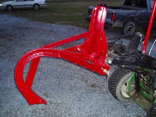

Finished the Ripper.

Maybe you could attach a tube and wire spool holder and use it to bury cable.
Bob Rip
/ Ripper Plow #15
Nice job!!
But in the heavy red clay of NC the PT-425 doesn't have enough power to use anything bigger than the Power Trac Potato Digger!! /forums/images/graemlins/frown.gif
/ Ripper Plow
#16
Yes 14. I think that the potato plow would put more power in its bite because the digging point is closer to the PT. I would recomend to anyone building one that they stick close to the PT design. I built mine like I did because my dad wanted it that way. It was mostly for him. (But it does work well)
