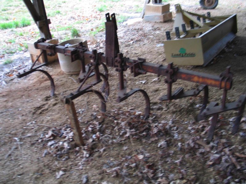

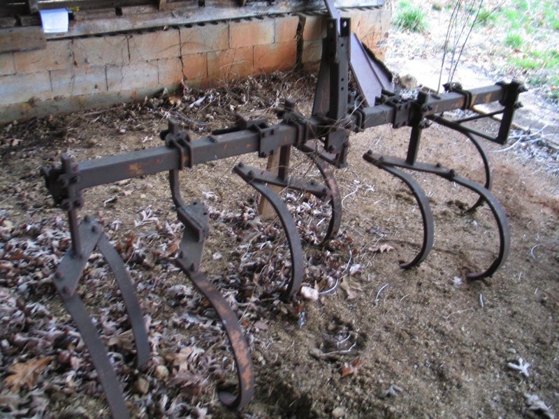

I'm not sure this is a ripper, but it is missing some prongs/teeth. I am figuring 3 of 9. First question is where can I find these? What exactly is this used for? I am wanting to rake some roots, debri up from a field I am clearing before disking.
Thanks for the help.

With those bolt on tine brackets, it looks like some type of row cultivator that you can adjust the position/width to go between planted rows. I don't know about direct replacements, but you might try

That is a cultivator and pic shows 2 bolts in the sweep? If so, any store that sells field cultivator sweeps such as TSC should have replacements just as long as the bolt centers are the same.

we have a ford cultivator with similar spring shanks

If that is in Nashville, I think you should just get rid of it, that old rusty thing should not be around, matter of fact, I may be able to help you out of this dilema :)
But really, any of the tractor shops have those or can get them through Tisco or similar. Everyone seems to have a slightly different name for them but just bring in an old one and they can match you up.
