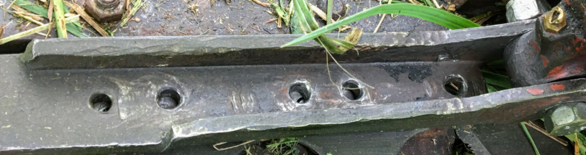

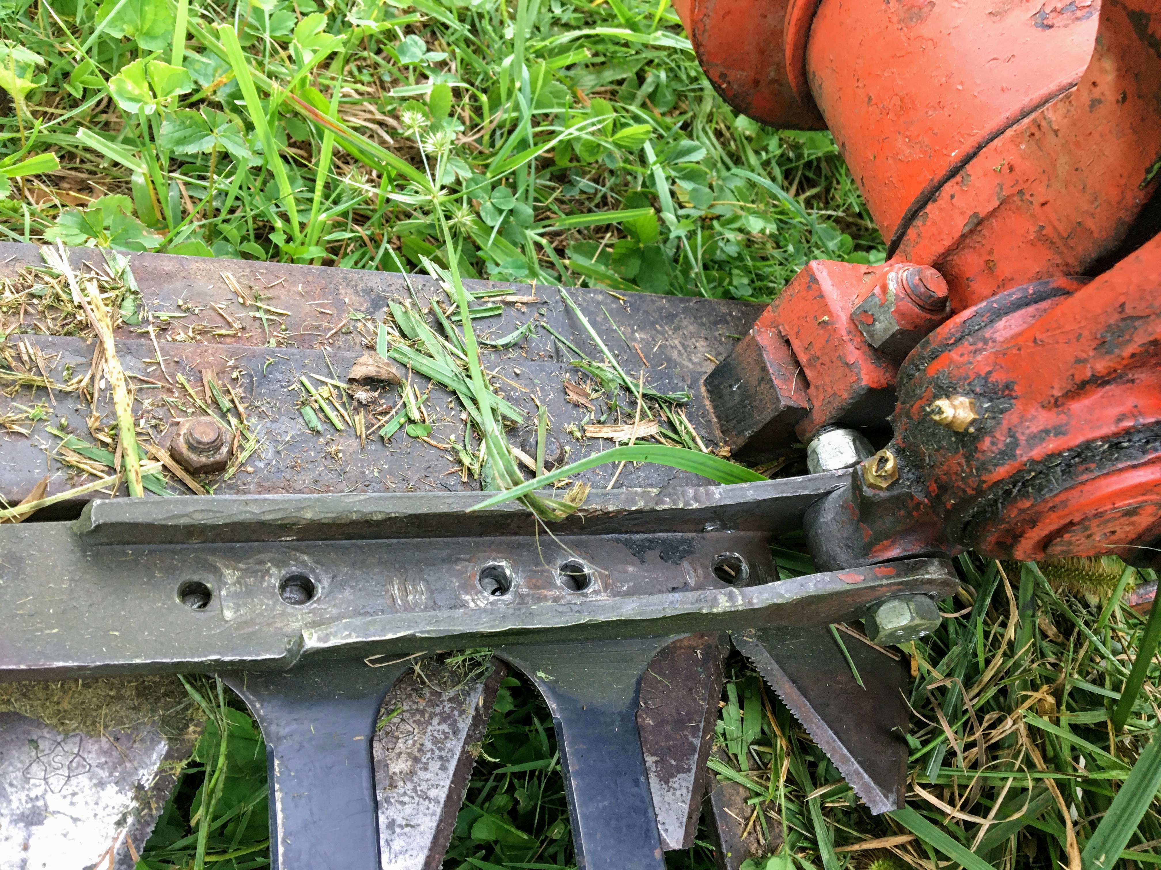

After I bought the mower, it lost two guard teeth while mowing for the first time. They attach via rivets to the power head - I ordered the rivets and the new teeth from the manufacturer.
However, being new to this, I am not sure how to set the rivets. I bought one of those tungsten bucking bars to put on one end of the rivet and just used a sledge hammer on the other end of it, to flatten it. However, when I start mowing, after 15-20 minutes of running through a field, the rivets just pop/break.
How is this done properly? What tool(s) do I need? I am attaching a photo of the setup. Thank you!

Wow, looks like you got angry at it. :eek: Don't forget to replace those grease fittings too.
Are the rivets countersunk on the other side? Let's see the rivet(s) you're trying to set. Typically they are NOT set flat. You don't just beat on them with a hammer. They won't hold as you've found out. The holding side(s) should be domed. I've set so many rivets on old car frames, I own many rivet sets and an air rivet hammer. These aren't the Horrible Freight air hammers, they were made to set rivets. Mine will set a 3/8" steel rivet in seconds.
Without the proper rivet setting tools, use one of the type pictured by Bruce (bcp), if it fits. However, they don't look like they have the clearance depth for your application. OR, have someone else set the rivets. You're crapping-out your equipment. :rolleyes:

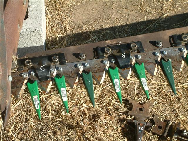

I use nuts and bolts to repair my Massey Ferguson 31 sicklebar mower. Tractor Supply has them.
Grain farmers use them to repair the long sicklebars on their combines. Rivets are a thing of the past.

I have set many rivets using a hammer,
as was mentioned you can't be gentle with the first hits as they need to swell and fill the holes.
Looking at the picture you have posted I am wondering if the assemble is set up correctly.
In the picture it almost looks like the guard to knife is backwards, it looks like the bevel of the knifes and guards are not in shear,
but backwards it may just be the picture.
But losing the end sections seems to imply a strain on those only.
