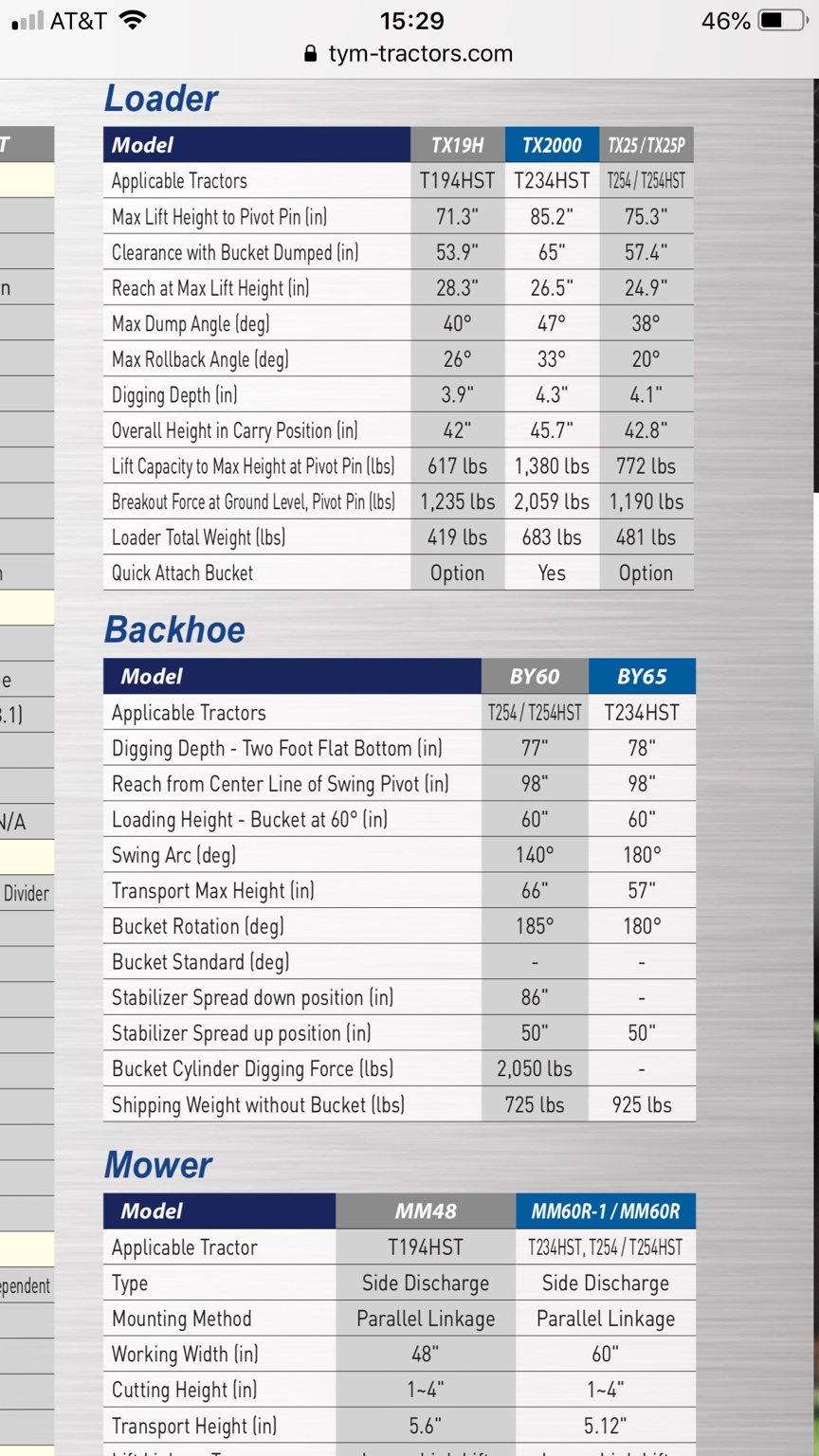

Wow, I went on TYM’s website and they themselves did not list a hoe for that machine. Maybe they were in the process of making one. IMG_2389.JPG
Mahindra does list one on their website, but I think I can find better things to spend $5,600 on then a tiny backhoe. It beats using a shovel but pricy.
