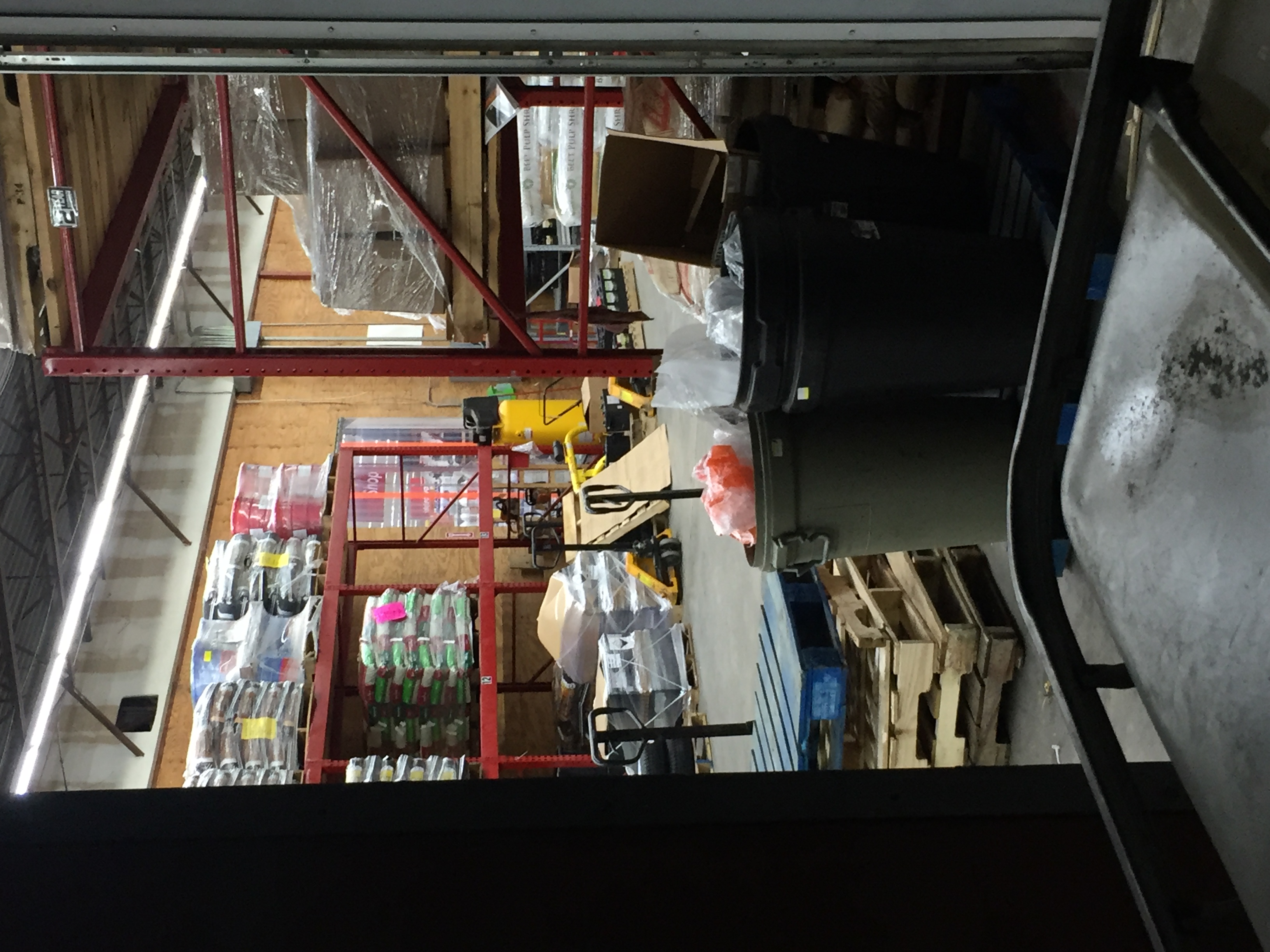

I think that it is a case by case situation on the service end I have not had need to return for service but have walked through the service area which is at best a small engine station cramped up with medium to large equipment and the mechanic ( as in only one ) only works three days a week, add to that the lack of secured area if you leave equipment over night meaning that it is left outside unsecured.
At my RK dealer they can only fit two compact tractors at one time in the single bay and the bay is poorly lit making the mechanics job more difficult in my opinion. Having said that I have heard others say that their service center is good and they have had good experiences in dealing with them, so get to know your store and it's service people to aid you in your decision, I love my RK24 and for the price and set up would make the same purchase again.

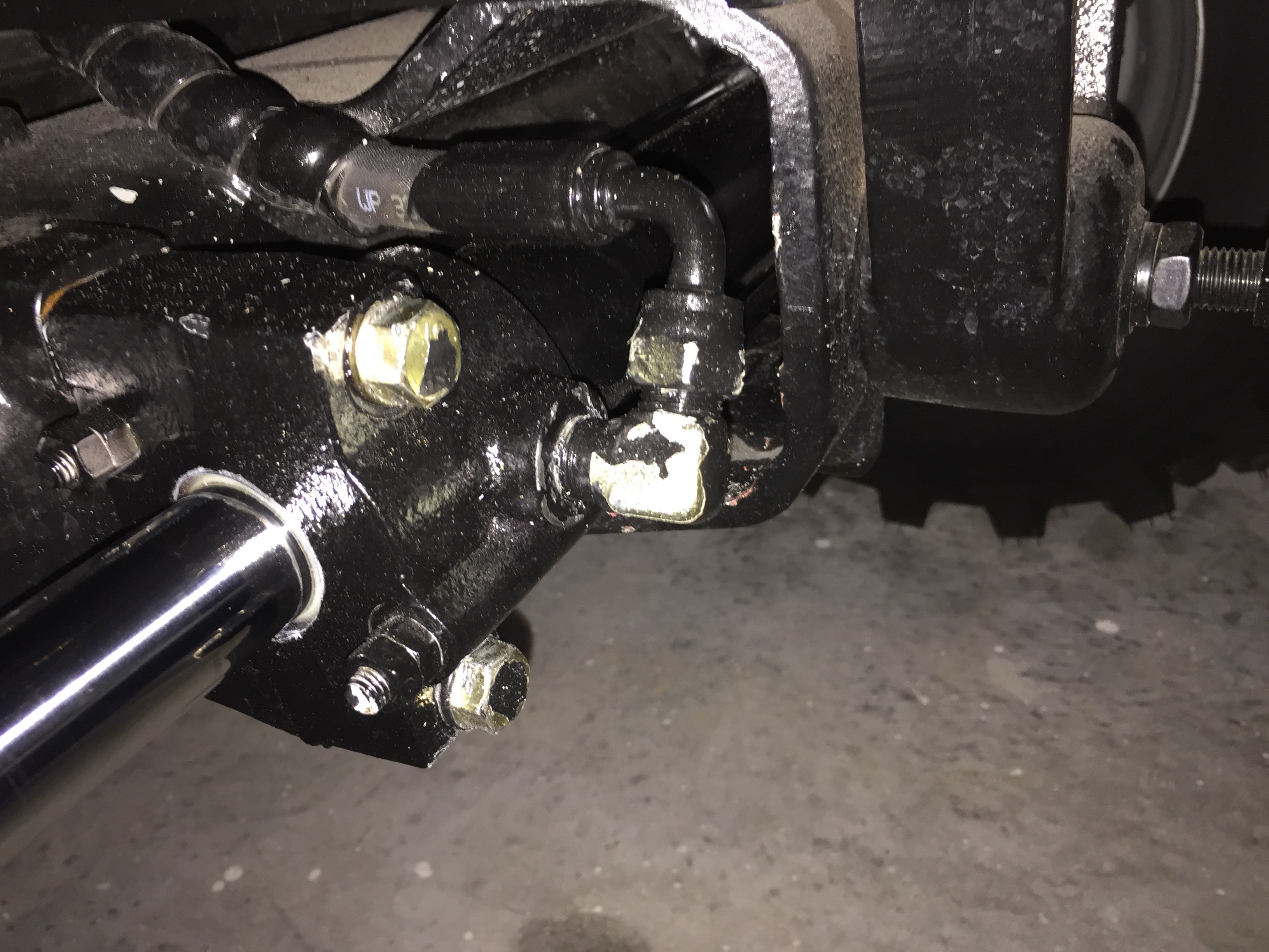

That said, my RK55 developed a hydraulic leak at one of the steering shafts. Since I assumed it would be covered under warranty, I did not wish to bother with it myself. The leak was small so I monitored it during the mowing season and added hydraulic fluid to the tractor when needed. Considering the cold season and my 50 hr service coincided with one another, I decided to take the tractor in to have the steering cylinder assy replaced (seals are not replaceable, must replace the whole unit) and since it was already going to be there, I figured I'd give them a shot at my 50 hr service.
First, my impressions of what I assume to be the service area. The space Rural King moved into used to be a K-Mart, so I think they are working with the cards they were dealt as best they can. Here's a few pics of the back area where my tractor was stored when I went to pick it up. My tractor was sitting next to the yellow air compressor tank in the second pic, and several pallets of product had to be moved from behind it in order to back it out. I think if they had to have a couple of RK55's in there at once, it could start becoming a little cramped. Prior to the tractor being accepted for service, it was pulled into the bullpen area on the side of the store which is protected by chain link fence, but not covered from the elements.

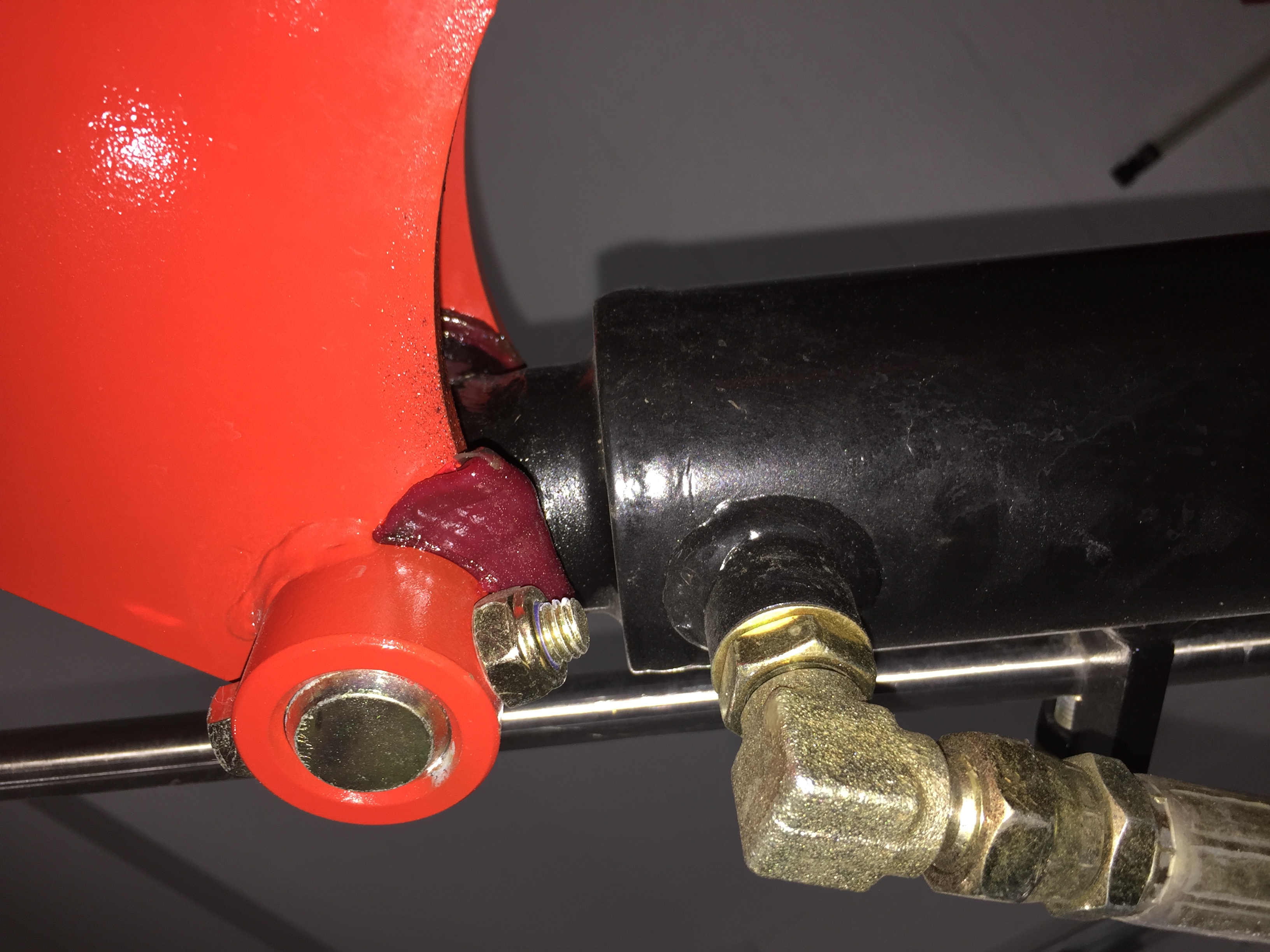

1. Mechanic was a little heavy handed with tools when replacing the steering assy, so paint chipped off several components (pics below). Not a huge deal, but avoidable in my opinion. I wrap my wrenches with electrical tape to keep from marring painted finishes when necessary.
2. Oil residue is apparent on several components where it was either spilled when filling or emptying and not completely wiped up. To be expected I guess?

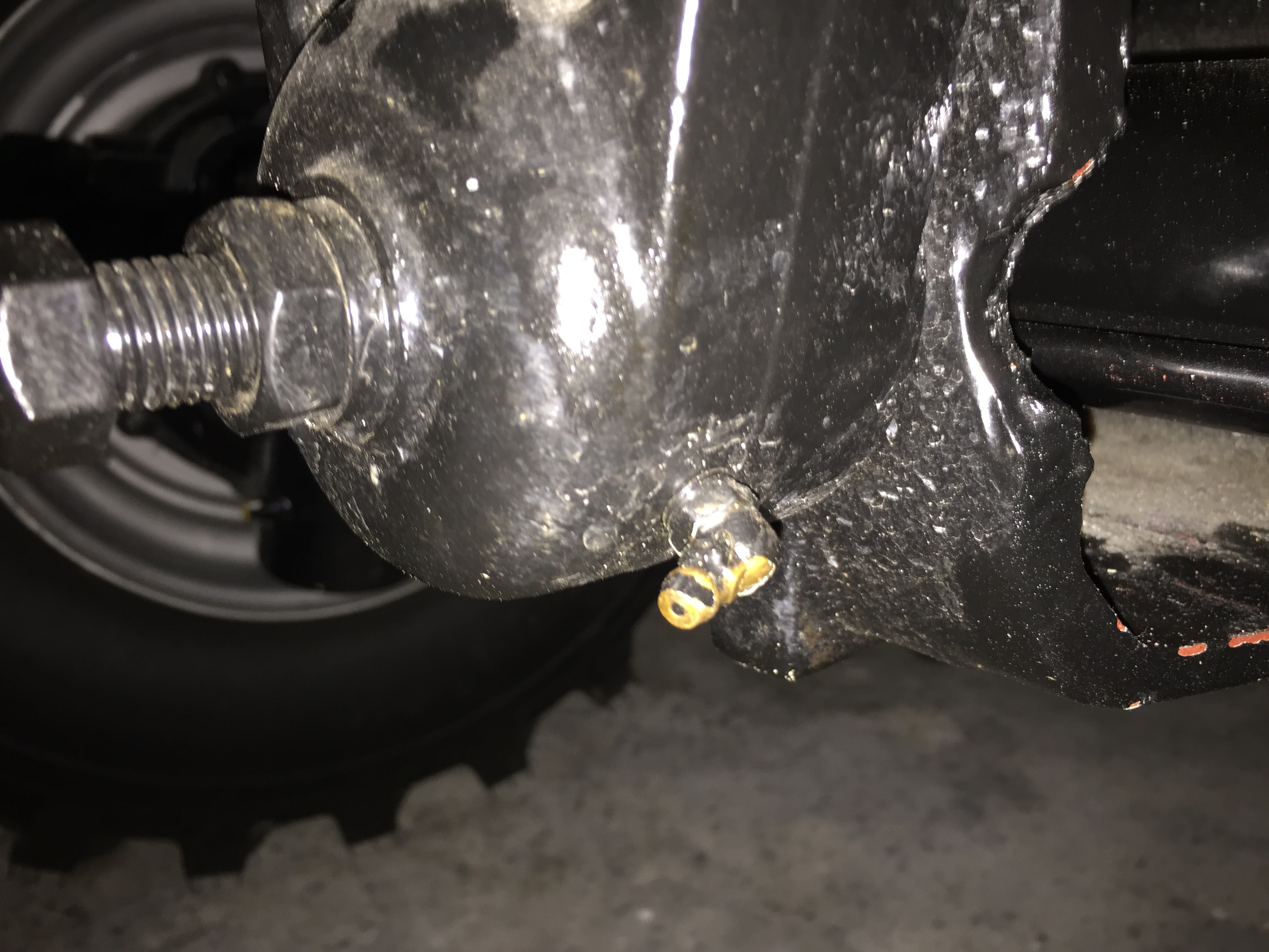

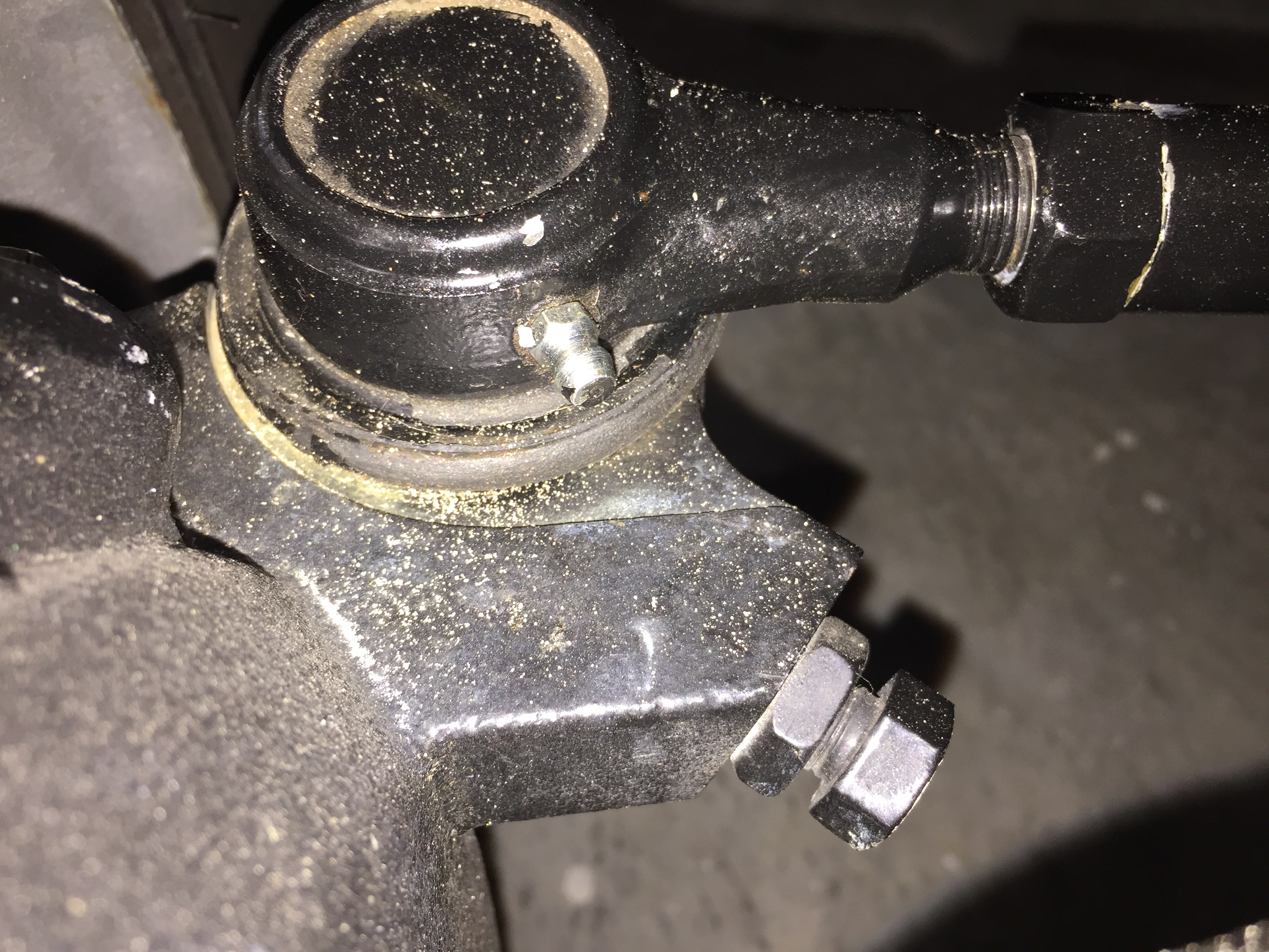

3. Whomever greased the loader zerks, used a LOT of grease. And, unless a completely different and totally fastidious individual greased all the zerks on the underside of the tractor, none of them got greased at all because the fittings are all bone dry. Pics below for comparison. I prefer all of my zerk fittings to be cleaned thoroughly after greasing so they don't attract dirt, so this is probably a blessing in disguise as I have quite a bit of cleanup ahead of me on the loader.

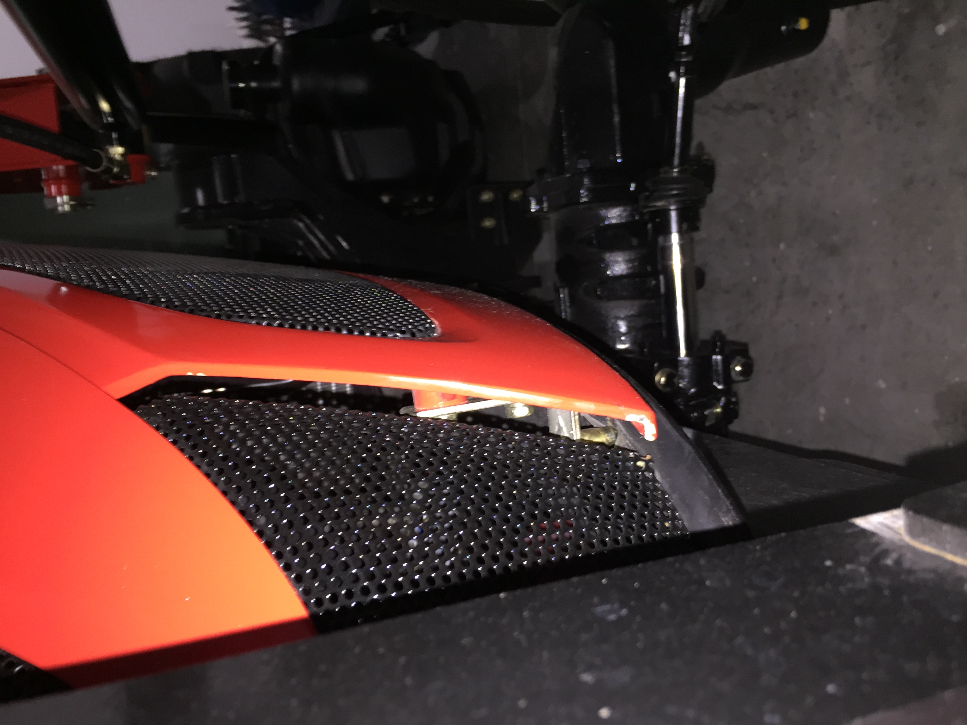

4. One of the hood panels was not installed correctly as shown below.

The chipped paint on fittings appears to be systematic of the machine. I.E., the grease zerks that didn't get serviced also have paint chipped off. I don't think taping the wrenches would have done much to minimize the chipped paint.
The missed grease zerks appear to be systematic of the mechanic not being familiar with the machine or machines of this type in general.

The chipped paint on the bolts/fittings is somewhat typical. The factory paints these components after assembly with a pretty thick coat of paint, and it's really meant for the castings and major components, not really the bolts and fittings (many of the bolts and fittings are plated and not even amenable to painting). But they get this thick coat of paint too, and it's the first thing that chips and flakes off when doing a service. Sometimes the mechanic will even have to chip off the paint just to get a wrench on. So that all seems typical to me.
