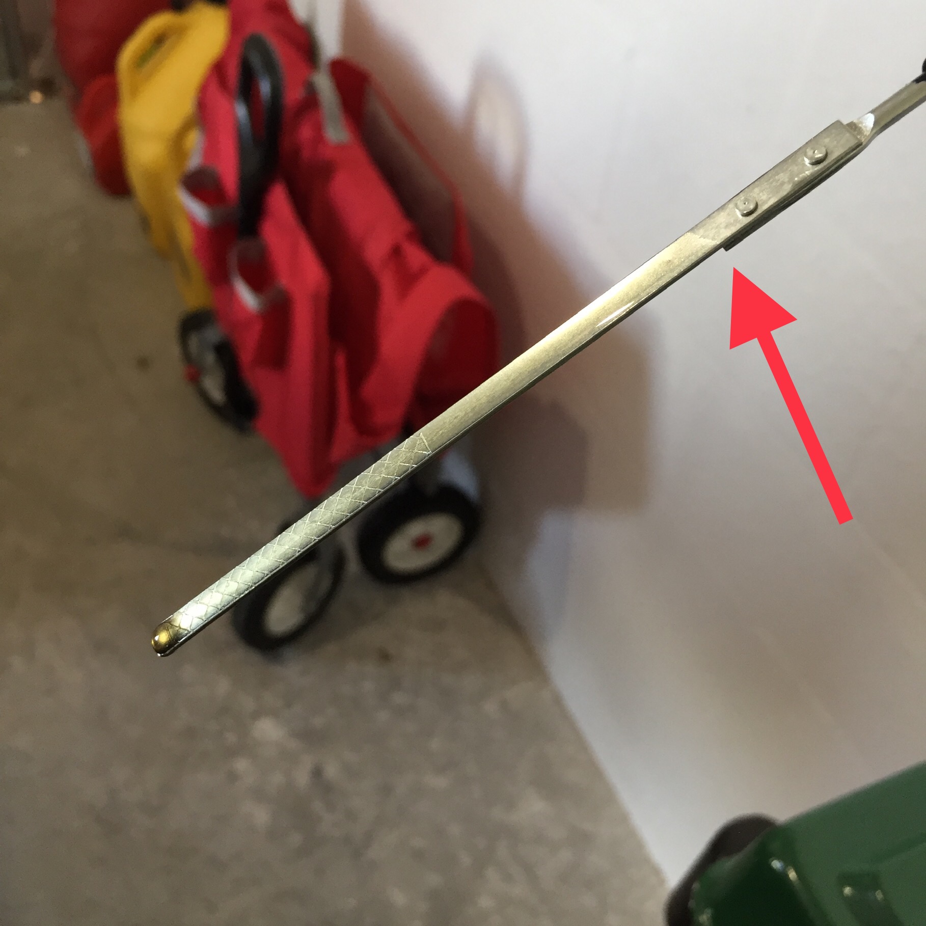

You are very welcome. Unfortunately I have an update to my original post. Just checked the engine oil. It appears to have been overfilled by quite a bit :confused:. I hope the twelve mile drive home in this condition did not do any harm to the engine. Guess it all depends upon how much extra oil the height on that stick represents. Are we talking ounces or quarts?

Just think, it could of been worse. What if NO oil was on the dip stick?

Ha! True - I definitely prefer overfilled vs. under. Just worry about foaming and pressure loss. Tractor seemed to run fine, but I won't be running it again until the excess is drained.

Is there a boat mechanic close by with a oil sucker. The one I use sucks the oil through the dipstick tube.

Had not considered sucking it out - good idea. I have seen those small pumps you can hook to a cordless drill. I am going to let RK deal with it though.

It would be good to at least get it on record anyways.

If you know what oil foaming is, you will not be the least bit happy with an overfull oil pan.
Just think your oil in the pan looks like the top of a rapid pan of boiling water. Suddenly your oil pump picks up a mixture of air, frothy oil and oil. Then your oil pressure drops to zero.
Still want it overfull!
