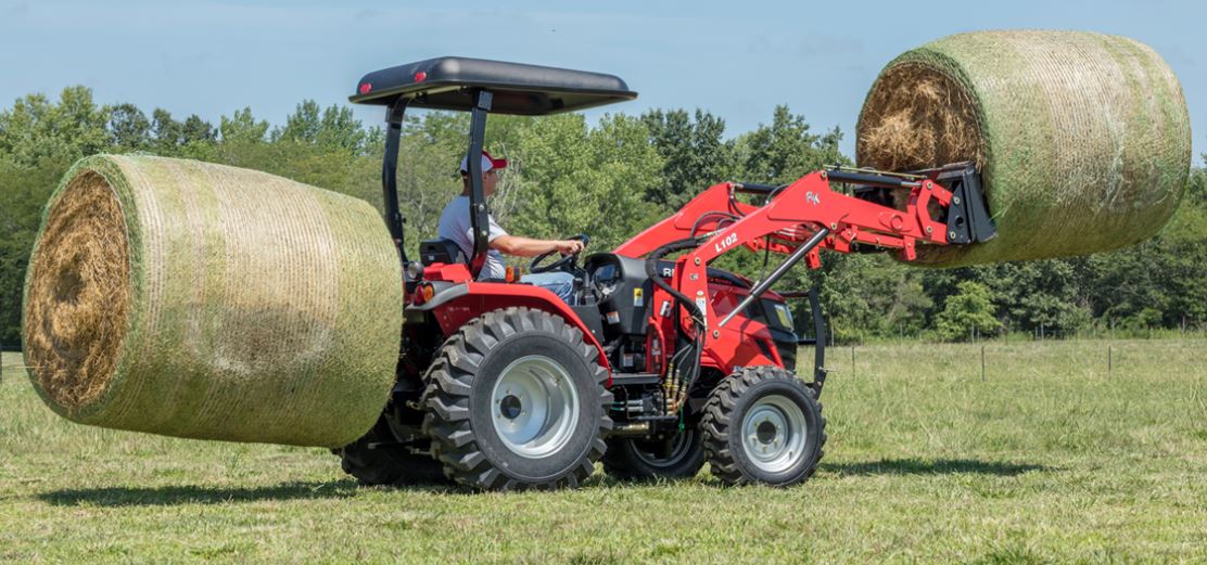

Question for you. On an RK37. I'm looking at putting a bucket mounted bale spear. Can you tell me 'about' what weight ( round bale ) I should be able to lift on that spear? 1500#?
Ps.. this is a real question.. not fishing for an argument over specs, etc.
thanks
This answer should be interesting....
Soundguy, I pulled up specs on a loader that gives specs for pivot pin and 500mm (1.6 ft) from the pins to get an idea for this. RK lists 2116 at full height pivot pins not 500mm from pins. Based on the other specs you lose roughly 25% capacity at full height when you look at the 500mm from pin spec. Keep in mind the center of gravity/load on your bale is 3' from pivot pins which will degrade the lift performance even more. Based on the other loader specs your lift capacity 5' off the ground and 500mm from pins is the same or a little more than the pivot pin specs at full height. So say almost 2200lbs at 500mm from pins when loaDeR is only 5' high. Now the RK guy said the loader lifts more than specs but for safety they understate. Of course some good ballast would be in order as well. I am curious what the official #'s stated will be or will any numbers other than pivot pin be expressed. This is where RK would be better served to put 500mm from pivot pin #'s out there - so customers can pick the right tractor/loader for their application. I say u can lift the bale and move it around but u can't stack bales. :2cents:
These bales weighed 1100 lbs. when we did the photo shoot. Specs are good for comparisons and apparently a lot of debate fodder. The real world is the decider. Our RK37 with L102 loader can do anything that a tractor in its class is expected to do.
