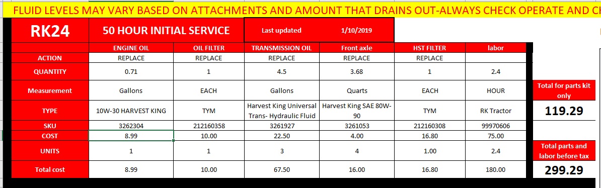

RK had everything but the filters and a quart of gear lube they weresold out. They shipped them to me after a bit of a run around. my trans did not take the full amount. I think I ended up adding back about 4 gallons. I only drained through the plug on the side of the mid-PTO and not on the finals ( you will see there is a drain in each) as I wasnt totally sure that was it. I used an inspection mirror to watch my mark in the sight glass as I added oil back into it due to not removing the backhoe attachment.
A few things I noticed or learned while doing my service:
A) There is more the one drain plug on the transmission/Hydraulic system
B) Remove the hydraulic line that blocks the filter to have easier access. (thanks to Digdirty for that info) The filter is painted black so it blends in
C) have a larger pair of channel locks or a slip joint oil filter wrench to change the trans/hyde flter its a real PITA to get to
D) There is more than once place to add oil to the engine. (just to the right of the dipstick and at the top of the engine. I used the top )
E) Open the vents on the front axle then open the drain plugs (3) one on each final and one in the center ( grease your front axle while your at it) go eat lunch while it drains, it takes awhile
F) Be patient filling the front axle, it takes some time and leave the vent plugs out until you reach the mark on the dipstick
G) Lube all your filter gaskets- apparently they do not at assembly because both were a bear to get loose.
once everything was replaced I fired her up and ran the hydraulics through their paces sever times and ran around the yard then went back and topped off the trans/hyde oil. checked the front axle and engine oil. Also blew out the air filter and cleaned the housing.
This was sent to me by the RK tractor guy ( He is awesome by the way, Quick response and informative answers) this will help you with amounts to add and help you find the materials in your local RK or the associate. Your pricing may be different depending on your location. Supposedly they are working on putting a kit together that you can buy to do 50 hour or 150 hour service so the lady at my RK told me.
