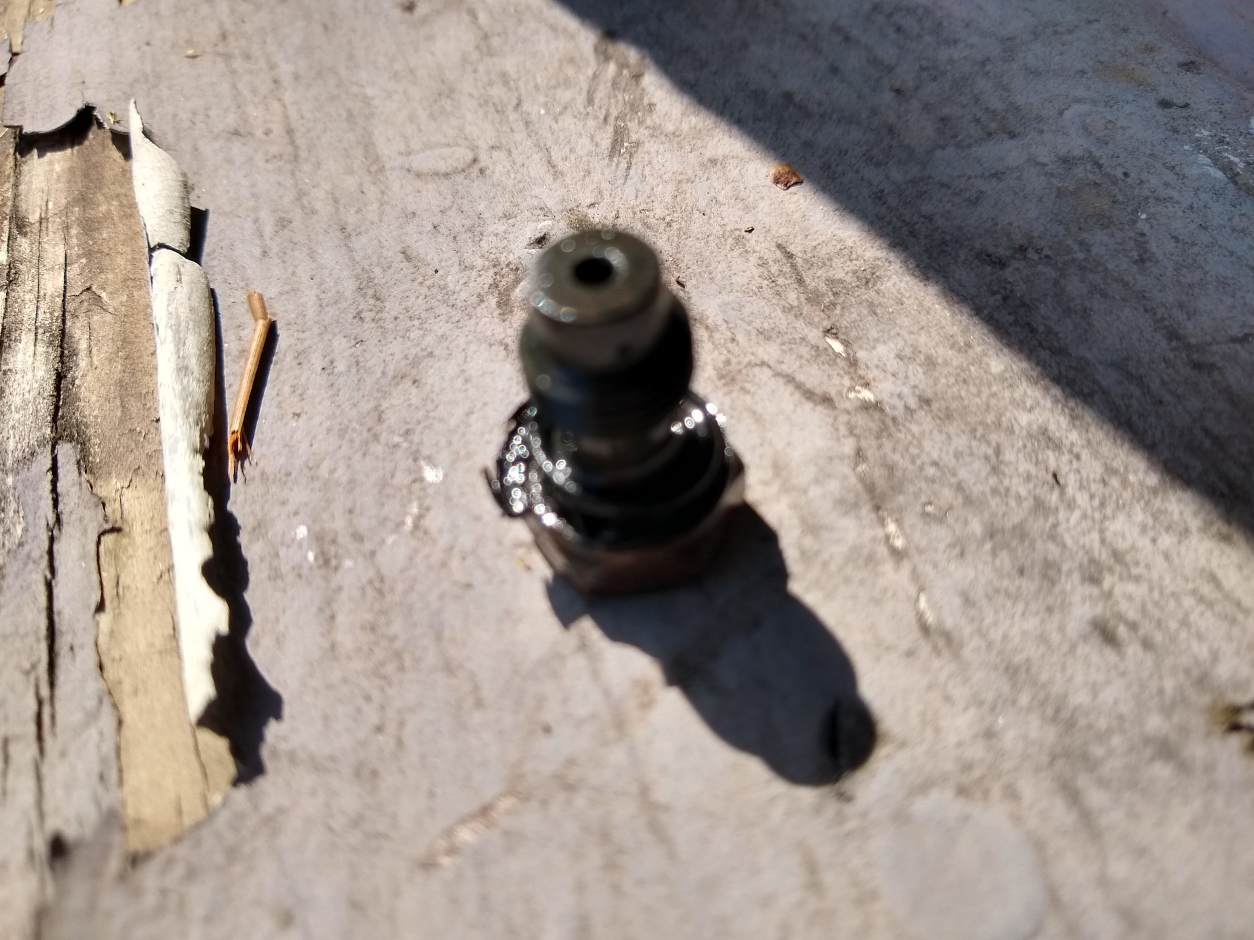

I have an o-ring kit. The o-ring I used had the same id but had a 3mm cross section instead of a 2mm. I did not have the size that was in there.
I had not thought about a pilot line for the relief on that hole. I had guessed it was an orifice to limit flow if you did blow out. I did not get a good shot of the tip of the plug but the attached does show the seat for the ball that I mentioned above. I do not recall a lead in chamfer for the o-ring. I think it was just a flat surface.

I suspect faulty assembly on first O-ring or cavity plug screws into not machined correctly. Second failure could be similar problem if cavity not correct. That O-ring should fit into a machined chamfer approximately 12 - 15 degree angle. I have seen some where you could see the O-ring chamfer along the hex with the plug installed. If you can see the seal it will eventually blow out.
Wrong size seal can cause same problem since it will not squash into that chamfer and then get trapped between head of plug and body. Smaller the plug the more critical the O-ring size.
   / RK24 Hydraulic failure #14
I see You posted 3 mm vs 2 mm cross section that could be a reason second seal failed see my previous post in attempt to explain why

When I get the block off again, I will try and get a picture. The one of the bottom of the block is before I removed the plug and you can see the original o-ring protruding from beneath the plug. Thanks for the help.
